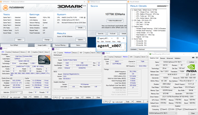

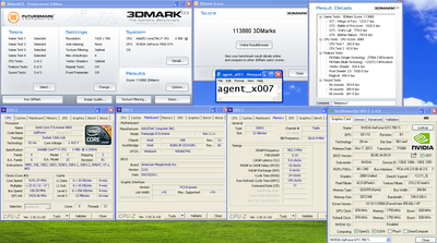

Windows XP :
The attachment 3DMark 03 GTX 780 Ti mini.png is no longer available

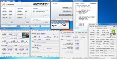

Windows 7 x64 SP1 :

DirectX 12 support test : https://www.3dmark.com/spy/2555135
Checked, and Valid 😀

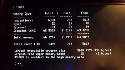

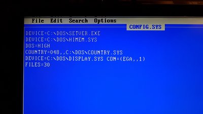

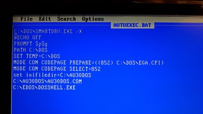

^Oh, all tests were done with 4,3GHz OC on CPU and no additional stuff in Autoexec.bat (only what Aureal Vortex 2 required to make SB16 emu working).
PS. Here are pics of my Autoexec/config.sys files (and "mem" command) :
The attachment AUTOEXEC.jpg is no longer available
The attachment CONFIGSYS.jpg is no longer available
The attachment MEM.jpg is no longer available
As you can see, there really isn't much inside 😁
