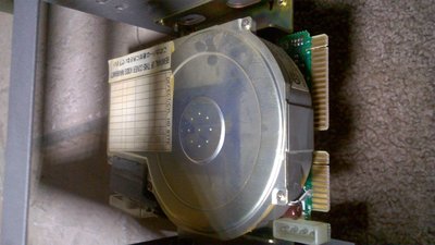

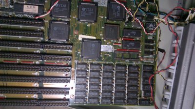

So I'll have pictures uploaded later, but I have a 286-12 given to me, I'm rather excited about it and can't wait to get it up and at home later.
From what I can tell its
286-12, barrel battery is leaking so ill clean that mess up and find someone skiled enough to solder and replace it, it has a 13in Amber Display, Video card, IO card, 20mb MFM hard drive, 5 1/4 floppy and 3.5 floppy
ill get it taken apart at home and give more info

Reply 1 of 28, by candle_86
Pic I took so far more after I get it home
Reply 2 of 28, by probnot
I'm excited to see more pics, the front of the case, the back ports, etc.
That monochrome monitor and video card sounds exciting (I remember playing a lot on old herc monochrome displays). Though it might get old quickly.
Also, looks like you're running 1MB ram, which will be a nice start.

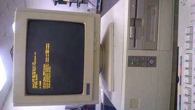

It posts's I get beep codes, but no display, the old amber display turns on but the tubes never charge, not sure whats wrong but ATM I don't have an ISA VGA card so 🙁

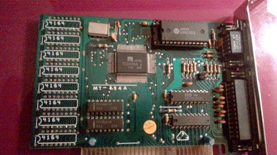

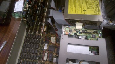

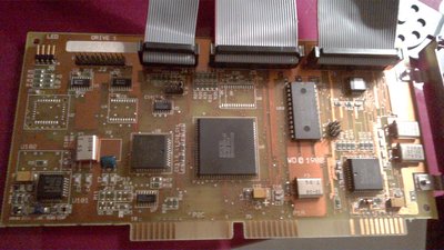

Ok so the amber display is working now, not sure what changed, and I got the keyboard lock off. New problem the 5 1/4 drive is diskette 0, I can't boot to gsetup on my 3.5 disk because of this and i have zero 5 1/4 disks, whats the next solution
The I/O card for the floppy is called winchester on the back it says WK 155988 WDC 60-600173-02 Rev 01
Correct me if im wrong but the twist in the cable tells it what is A and B doesn't it
Reply 12 of 28, by candle_86
1.56 MiB
764 views
it
Reply 13 of 28, by CkRtech
Aww yeah. Nice.
RE floppy cable - The A drive is the last connector on the cable, and the B drive is the one in the middle. Put either one on backwards and the floppy drive light will just stay on.
Reply 14 of 28, by probnot
That's right. If you swap the connections at the drives, you swap the drive letter. I know a lot of machines that age will have floppy cables with edge connectors (the style uaed on a 5.25") and then an adapter to go to the newer connector on the 3.5" drive. If thats the case, swapping will be really simple.
Sweet looking system
EDIT: what CRTech said! I just noticed both floppy lights are on, in that case make sure the red wire (or marked wire) goes to pin 1 on the controller as well.
Reply 15 of 28, by candle_86
yea i fixed it, and i swapped the edge and pin connections on the ribbon cable so the 3.5 is now A drive 🤣

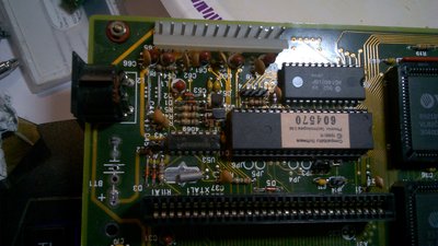

Reply 17 of 28, by candle_86

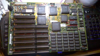

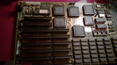

More pics added, also removed the battery, no damage from the acid woohoo, anyone identify the battery header, also the motherboard?
What saved it was the covered the bottom with hotglue, it came off with the battery but the acid was just at the leads for the battery, and the rest on the hot glue 🤣
