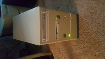

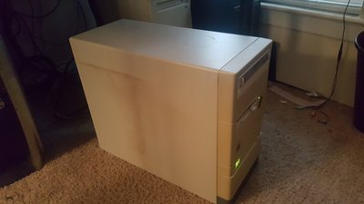

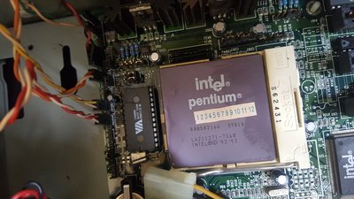

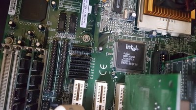

So here is my Pentium 166 Classic
Specs
Matronics D5CUB
Pentium 166
2x16mb 70ns SIMMS (going to buy more SIMMs this week)
6.1gb Western Digital Hard Drive
Sony DVD-RW
Daytona 64T Trident 9680 (my voodoo 3 2000 is dead it turns out so im going to be looking for a new PCI video card)
Promise Ultra133TX
Intel PRoSet100 NIC
Soundblaster 16 PnP
Windows 98SE (Wanted 95 but i can't get networking to work on it, and i need access to my FTP 🤣)

Reply 1 of 8, by BitWrangler
I'd keep the 8x CDR in, presuming it works. Optical drive speeds too far out of era lead to a bad experience IMO, with games that load levels continuous off CD or load cutscenes, you end up with the fast drives spinning up, slowing down, seeking, spinning up, slowing down, and this seems to lead to stutter and lag in the game, possibly because slower machines don't empty the drive's buffer fast enough, fills up, drive spins down, then by the time more data needed 1 or 2 second lag to spin up again. Then file copying to hdd seems a good bit faster, but still it'll be spinning up and down and making you worry that this machine is wearing the damn thing out 3x as fast as a faster machine that can keep up with it would.

Reply 4 of 8, by candle_86
So based on what I know aka
256k L2 Cache I think limiting myself 64mb would work
How to i get network working, i got TCP/IP installed but it couldn't talk to my DHCP server, I tried a static IP but still couldn't connect to anything so I can use 95
Whats a good PCI graphics card, i want 3D and compatability with things like Starfleet Academy, SimCopter and good 2d for Civilzation II, Simcity 2000 SE ect. I don't own many DOS games mainly Doom, Duke 3d, Wolf 3d, Commander Keen
Reply 5 of 8, by chinny22
Win95 / Win98 pretty much same thing when it comes to networking. And it most definitely should be able to get a IP assigned from a DHCP server even in this day and age. Sharing files over network may be a pain to get going but getting an IP should happen right out of the box! Sounds like network card issue.
Maybe try different driver?
I've also had problems with windows assigning the card wrong IRQ's etc. The driver package should also include some kind of dos exe file for assigning and basic testing, double check what resources the card ahs then manually set in device manager.
Re PCI video card
None of those games are demanding, simcopter works with a card with just 512kb! But to play it safe I would look at 2MB cards or greater.
Good VESA support is what you are after, While aimed at DOS the below link shows the good from the better. TNT or TNT2 would be safe bet.
Or the usual DOS gamming cards like a S3 so your currant card isn't that bad, quick google says it compares to a trio unless your using 24 bit colour in windows.
