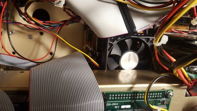

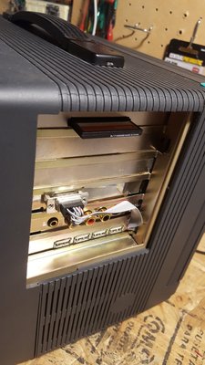

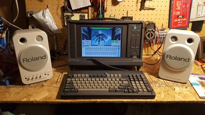

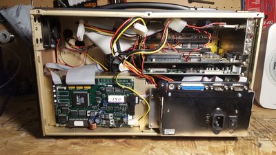

This is my latest build Mostly for playing MIDI files at little parties:
Dolch luggable portable PC (PAC)
removed original pentium 100mhz board
added:
PC CHIPS M571 Motherboard (new old stock)
AMD K6-II 500mhz afx (underclocked to 400mhz to keep it cooler)
4 x 32mb (128mb ) 72 pin simms (because of the space limitations, i couldn't fit any pc100 ram in there, unfortunately)
Yamaha SW1000XG sound card
Mach64 pci graphics
NEC PCI usb 2.0 card
IDE to CF w/ 16gb card for the win98 installation
COMBO usb card reader/floppy drive! 😀
will cleanup the cables eventually.
Notice how close the cpu fan is to the floppy/LCD controller bracket 😜 Luckily, it doesn't touch!

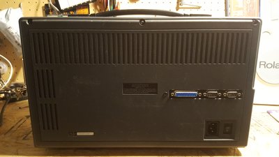

Reply 1 of 6, by CornBrown
more

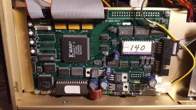

Reply 2 of 6, by jheronimus
Awesome! I've been thinking of buying a Dolch myself, but I am concerned about the weird VGA card. I notice that you came up with some sort of solution to use a regular Mach64 — can you tell a bit more about it?
MR BIOS catalog
Unicore catalog
Reply 3 of 6, by CornBrown
The board with the xilinx chip on it is an lcd controller, it came w/ the dolch. Ive not seen any other models with it but i believe it was an option so there might be more out there. For my application a 640x480 lcd was fine, but if it didn't have the controller board i probably would've just bought a 10in lcd off ebay or amazon and installed that instead. That's the plan if this one ever dies

Reply 5 of 6, by CornBrown
There's nothing weird about the Mach64 pci vga card, it's just putting out vga to the cable that goes into the lcd controller.
I think a lot of the dolchs have a pci or isa video card with the lcd controller built in which is pretty limiting.
