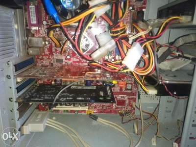

Just built another 2004 rig because why not. I had some parts laying around from a salvaged PC so I thought why not use them?
Specs:
MB: MSI 848P Neo-V
RAM:2x512MB DDR400
GPU: Palit Radeon 9550 128MB AGP8x
PSU: ANS LC-B350ATX 350W - it has been recapped and modified to be used on 12v machines
ODD: Samsung/TSSTCorp SH-162D DVD-RW drive
HDD: Western Digital WD800JB-00JJC0 80GB PATA
Case: JNC/Comprace FQ-70-RJA
CPU: Intel Pentium 4 2.8GHz/512KB/533FSB Northwood Socket 478
Misc: MSI D-LED Bracket & Pixelview PV-TV304+ PCI TV Tuner (CX23881)
OS: Windows XP Media Center Edition SP3
So far I've played GTA San Andreas on this machine, GTA Vice City and Crazy Taxi 3. San Andreas runs fine on low details,640x480x32.
For some reason I get a WMF Decoder cannot be initialised error on both Total Immersion Racing and Ford Racing 2. I wonder if FR3 does that since I remember FR3 is not WMF dependant.

Reply 4 of 15, by PcBytes
Took a photo of the build. Will do for now, more may come after the 17th, as I have another surprise.

Reply 5 of 15, by Jade Falcon
Rank BANNED
BANNED
Good lord, a deer PSU. I'd get rid of that PSU ASAP, all deer PSU"s are junk and were known to blow up or start fires.
Otherwise the system looks nice.
Reply 7 of 15, by PcBytes
It's been already recapped. I remember I got it from a dumpster PC (from which I still have the parts) that was discarded because of bad caps in the PSU and near the CPU, as well a missing heatsink for the northbridge. An hour later and both the PSU and motherboard came to life. I got lucky enough that the PSU has pretty thick heatsinks (although no PFC but I'm trying to avoid it anyways).
So far I've replaced the output rectifiers in this order - 3.3v got a 16A rectifier, 5v has a 10A rectifier and 12v has a 20A rectifier. This is to be sure it runs on 12v machines. Anyways, this PSU isn't in this PC anymore, as it's been replaced with another one that I modified (I have a bunch of these, and out of them only one was left almost stock, mainly because it didn't see too much usage in the first place.) in the same way as the one in the picture.
I usually have too much free time and too many parts scavenged from other dead PSUs waiting to be used. 🤣 Just recently, I've got an whole set of good parts (12A main transistors, thick heatsinks, big transformer etc.) out of an dead 400W generic PSU, and the casing from it went to a modified "450W" Delux PSU that now powers a Core 2 Duo E7600.

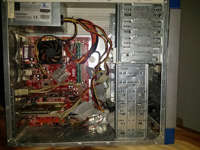

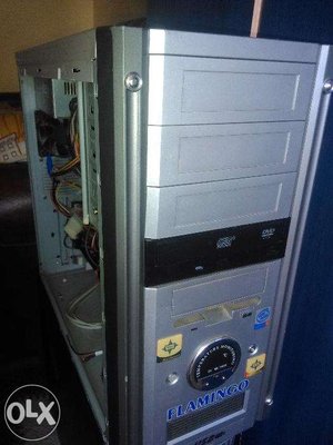

So, I'm back with an update.
Time to reveal the surprise:
42.51 KiB
1765 views
92.57 KiB
1765 views
110.83 KiB
1765 views
Talked with the seller and I'm buying it tomorrow. From what I gathered from the description and pics, this is what it has:
-a pretty fancy Deer/L&C/ANS/JNC case with thermal sensors (although they're not connected to anything, going to take care of that)
-MSI 865PE Neo2-LS (one of my favourite boards, with the P4P800-E Deluxe being a close second)
-generic LC-B450E PSU that has a cut molex for a 80mm fan (lmfao)
-MSI FX5600 - only one bulging cap - a recap is in order tho
-some Sound Blaster PCI soundcard - looks like a AWE64?
-80GB Maxtor iDE
-random DVD-RW drive
-2.8GHz Pentium 4 - probably a Northwood judging by the heatsink. Will be replaced by a Titan TTC-W6TB cooler (although with a clear Raidmax fan since I am tired of its mediocre fan that they installed)
-1GB RAM
-external PCI RTL8139 NIC for no apparent reason since the board actually has onboard Intel 82547 gigabit NIC.
Sounds like a good deal, although I'll really have to see if it's worth rebuilding the Deer in this one (for a Northwood, it would be more than enough theoretically) since some of these Deers have a PCB that isn't worth beans and some are suited for rebuilding - they usually mark them differently - the gutless ones are marked "Y-B200ATX Ver2.x" and the ones worth rebuilding are marked "X-B2002" (versions usually remain the same - 2.3 up to 3.1).
Other than that, it's nice to see such a system, and I'd be more than happy to restore it and make one hell of a Pentium 4 build, even if people don't really like the Netburst arhitecture.

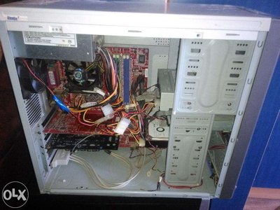

Also, I replaced the case on the 2004 build with something that might fit, although made a few years later:
133.97 KiB
1765 views
It's a Delux MT375 case - it's a bit compact, but OTOH, the build quality is pretty good. Specs as of now, until the 865PE Neo2-LS machine will come:
MB: MSI 848P Neo-V
PSU: Allied AL-A400ATX 120mm recapped - silent
Case: Delux MT375
CPU: Pentium 4 2.8GHz
HSF: OEM AVC full-copper heatsink from a AIO S478-based PC - fan isn't original though - comes from a AMD 754/939 HSF, because the original AVC fan would run full speed and sound like a jet engine
GPU: Xpertvision/Palit Radeon 9550 128MB - planning to BIOS-mod it to a 9600 Pro using an Palit BIOS from a 9600 Pro card
RAM: 2x512MB DDR400
HDD: WDC WD800JB-00JJC0 80GB PATA
ODD: TSSTCorp SH-S162D DVD-RW
Other: MSI D-Bracket, Pixelview PV-TV304P
OS: Windows XP SP3 (better safe than sorry)
