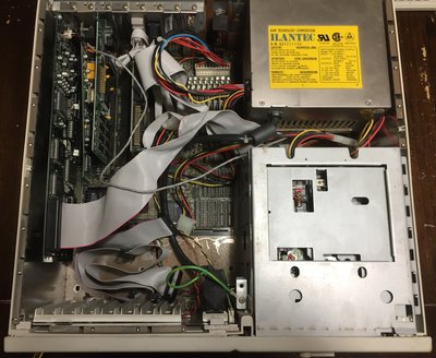

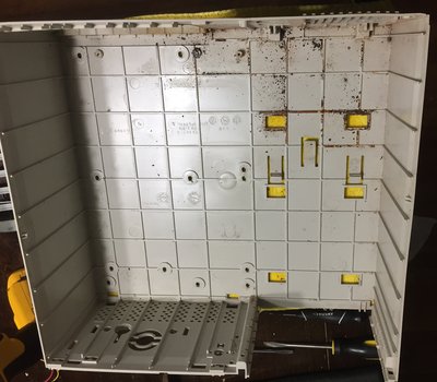

I received a water damaged Compydyne 486 desktop system this last week.
The 3 main reasons I bought this system are:
Sound card - Ensoniq SoundScape S-2000
Intel 486-75 overdrive
AT desktop case
I am working on rebuilding this system. The hardest part is going to be restoring the case as you will see in the following pictures.
I'll update this first post with the parts I decide to put into the case.

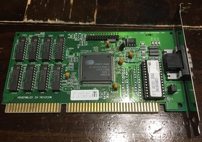

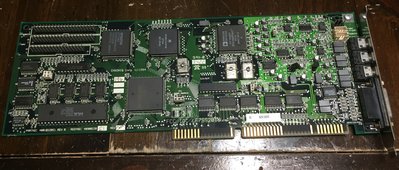

Compydyne branded video card
1.65 MiB
1471 views

Reply 2 of 29, by cyclone3d

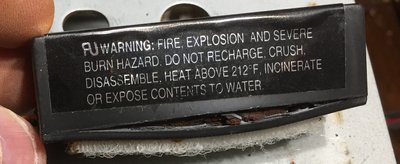

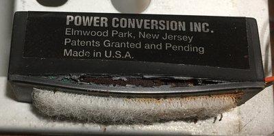

External CMOS battery - I think she's dead, Jim.
521.75 KiB
1470 views
Do not expose contents to water.. HAHA, good one.
488.71 KiB
1470 views
Eternacell - not so much
238.2 KiB
1470 views

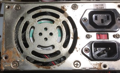

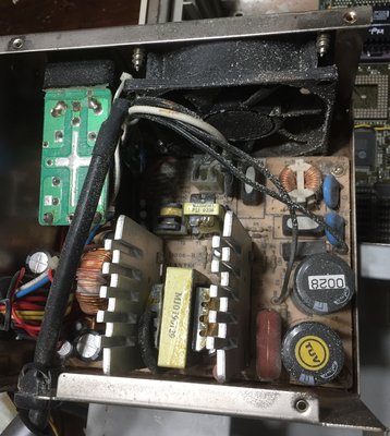

Reply 4 of 29, by cyclone3d
Power supply - don't think I will be re-using this.
1.12 MiB
1451 views
1.81 MiB
1451 views
1.1 MiB
1451 views
1.38 MiB
1451 views

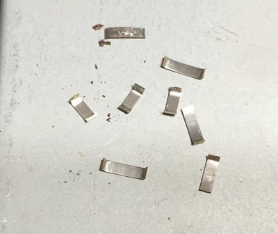

Pieces of the P8 and P9 connectors that fell off when I disconnected them from the motherboard (power supply side - the motherboard connectors are fine).

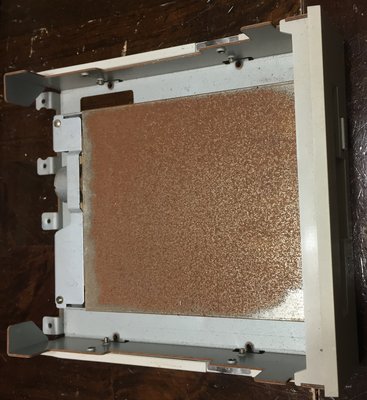

Top of the 3.5" floppy drive - hrmmm - I wonder if it still works.

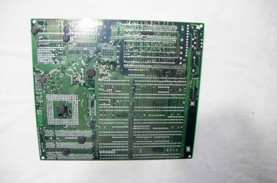

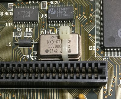

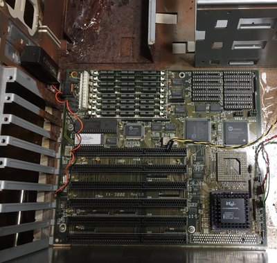

Motherboard - FX-3000 Rev 1.0 - Other than a bit of transferred corrosion from that one screw and some deposits on the keyboard connector shield, the motherboard looks pristine except for a busted capacitor - the one in between the two sockets. About the middle of the 486 CPU. Pretty sure I am going to swap this motherboard for one of the VLB motherboards I have. Such a shame to run a 486 with only ISA.
1.65 MiB
1435 views
Looks like they were overclocking to 100Mhz - saw another motherboard for sale that also had the same exact CPU running at 100Mhz - was it a common thing back then to clock these 75Mhz OD CPUs to 100Mhz? Guessing they are the same as the DX4-100 CPUs, just sold as 75Mhz instead of 100Mhz.

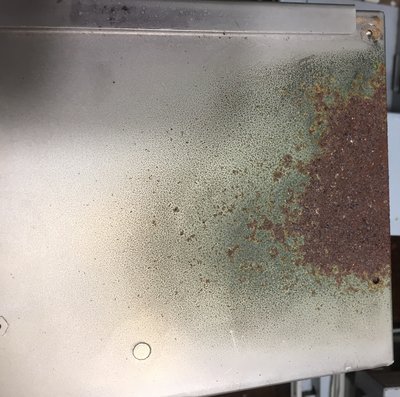

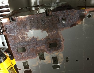

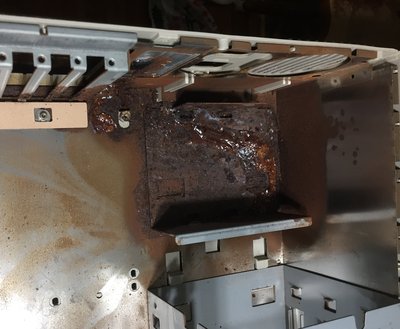

Here is the bulk of the rust damage. This is going to be fun... 😢
1.09 MiB
1435 views

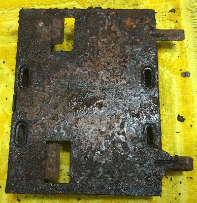

PSU support removed. Soaked it with some penetrating oil to help loosen the rust between the PSU support and the metal below the support. Pretty sure I am going to have to fab up a new piece for the bottom corner and the keyboard port metal will just be gone (lower left hand corner) and maybe the metal for the optional 2x 9-pin and 25-pin ports (left of the keyboard port).
1.58 MiB
1435 views

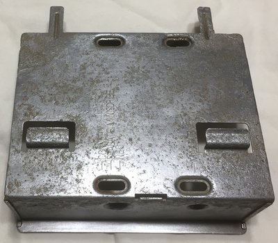

Bottom of the PSU-support. I think this will clean up. Going to maybe use some rustoleum after cleaning all the rusted parts in order to keep them from rusting again. Guessing I will also spray paint the rusted parts so they look better.
1.29 MiB
1433 views

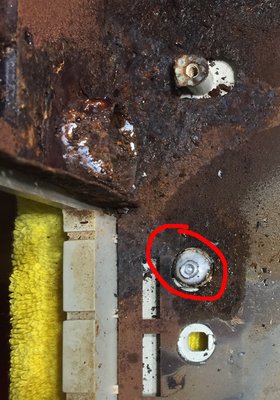

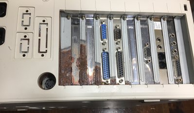

Removed the expansion slot bracket - had to drill out the rusted screw.
949.65 KiB
1433 views
Going to try and drill the screw all the way out and re-tap. If that doesn't work (guessing the plastic will melt when I try to drill), I'll use a bolt/nut to hold that side down.
The plastic has a brass insert for the screw to go into.
1007.55 KiB
1433 views
Got the metal insert removed - see the hole I accidentally punched through on the left hand side - about mid-frame?
1.24 MiB
1433 views
The inside of the case with the insert removed.
1.17 MiB
1433 views
Now that everything is disassembled, I'll wait to post more until I am putting stuff back together.

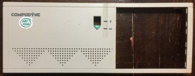

I'm a big fan of Compudyne cases. Why won't you show us the front end?
Reply 10 of 29, by cyclone3d
Here it is:

Upon doing a preliminary cleaning of the PSU support, I found that it is also the HDD mount. The system didn't come with the HDD, so I was unsure of where it was originally mounted.
Pretty sure it was either not mounted in the stock location or it had been removed at some point in the past because there was no indication of where it had been mounted.
1.67 MiB
1337 views
Going to be sticking the expansion slot bracket and the PSU support/HDD mount in vinegar to remove the rest of the rust.

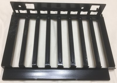

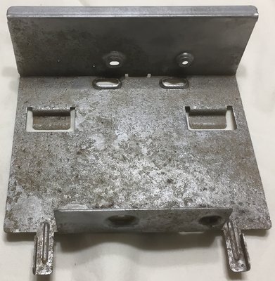

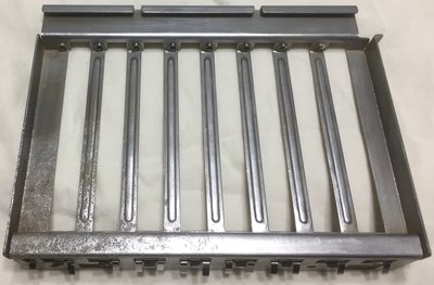

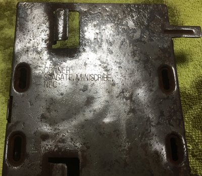

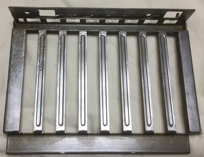

Finally got the expansion card bracket and psu support/hdd mount finished.
I soaked both for a couple days in vinegar, took them out, hand wire brushed them off, put them in for another couple days, brushed them off again as well as chipped off some of the larger rust deposits off with a screwdriver, then soaked for another day and then did the final brush and bath in water and baking soda. As soon as I dried them they flash rusted. I had to wait a couple days to paint because of the weather. These are the pics of them wire brushed right before painting.
1.2 MiB
1186 views
1.15 MiB
1186 views
1.26 MiB
1186 views
1.33 MiB
1186 views

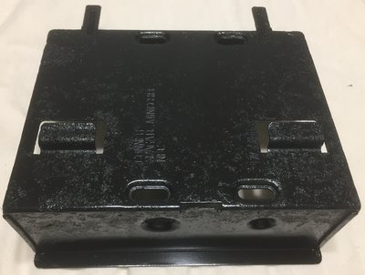

Reply 14 of 29, by cyclone3d

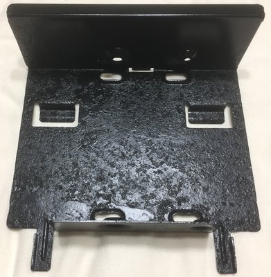

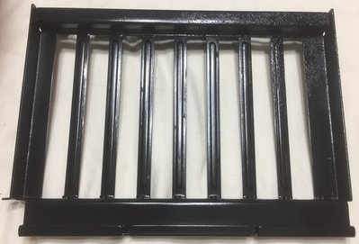

And here they are painted. Took a couple evenings to do this because of weather. Lame rainy season.
1.89 MiB
1185 views
1.57 MiB
1185 views
1.82 MiB
1185 views
1.4 MiB
1185 views

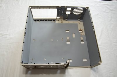

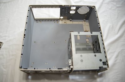

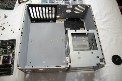

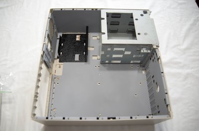

I am finally getting this system put back together.
602.68 KiB
1076 views
I ended up having to cut out the very badly rusted portion of the metal insert. I then sprayed it with grey primer. I decided to not paint it black as I thought the grey would look good.
624.8 KiB
1076 views
Drive bay added.
528.38 KiB
1076 views
PSU support / HDD bay added
754.68 KiB
1076 views
Expansion slot insert added.
1.04 MiB
1076 views
Bottom of the motherboard after I added some rubber laptop feet to keep it from flexing and/or shorting out with the metal insert.

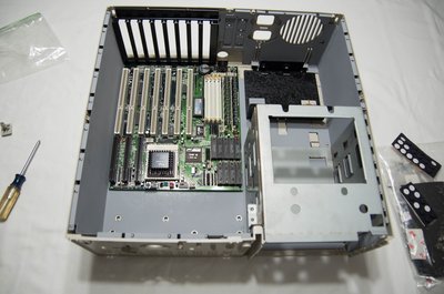

Reply 16 of 29, by cyclone3d
1.04 MiB
1076 views
Motherboard installed.
