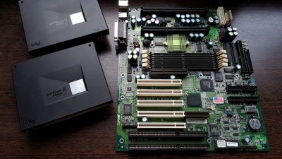

About a month ago I stumbled upon this motherboard on a bulletin board. The guy marketed it as an old decommissioned server board. He made a lot of mistakes in the description, and for that reason, it could not be found by using keywords as Slot2, Xeon, 440GX. I came across it just by browsing around old motherboards for sale. So I immediately jumped on it. It was probably the fastest buying decision I have ever made.
He told me the board was purchased by a local power plant in his city in 1999 as a base for scientific workstation. It came with a pair of 500/512K Xeon. And it is made in the USA. They even put a sticker saying that to the board. Which is cool.
1.83 MiB
2928 views
So now that the board is mine I'm deciding what kind of a computer I'd like it to be.
I initially intended to make an ultimate year 1998 build with a pair of PII Xeon 400/1M (Drake), Riva TNT and Voodoo2 SLI
But I actually already have a similar system with regular Slot 1 Dual PII-400
I did some research and for the revision I have (v. 1.1) I can probably max it out with Cascades Xeon 900/2M, there is no official support for 900s though but I found few successful reports on forums here and there. Or step it down a bit with 700/2M which are supported officially.

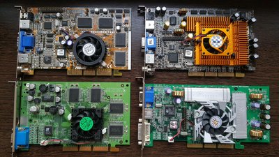

From the appropriate video cards I own, I can use GeForce256 (1999), GeForce2 GTS (2000) or GeForce3 (2001) Anything newer would probably be bottlenecked by CPUs. But that's we'll find out doing some benchmarks. I'm also going to compare the Xeons to regular Slot 1 Pentium II/III running on a per clock basis to find out how the increased cache affects the performance in various type of applications. I don't expect to see much of a difference especially in games however.
I might end up acquiring 3dfx Voodoo 5500 as I feel like it matches the whole build uniqueness but honestly, I really don't think the 5500 was the greatest option back in 2000. I would rather have gone with GeForce2 Ultra back then. Which is now I'd say is on par with the 5500 in terms of rarity.

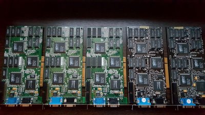

Also I have some black pcb STB Voodoo2 and the green ones from Diamond. These cards were obsolete in the year 2000 but we'll keep them for the older games compatibility and SLI coolness factor. 2CPUs, 2GPUs. Yeah.

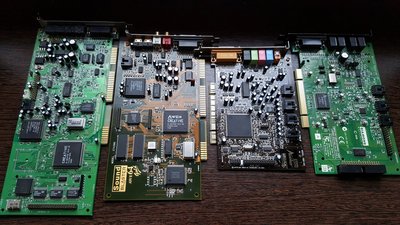

For sound, given we have two ISA slots we can use Sound Blaster 16 or AWE64 Gold for DOS and something like Live!, Audigy or Vortex2 for Windows games.

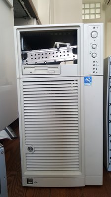

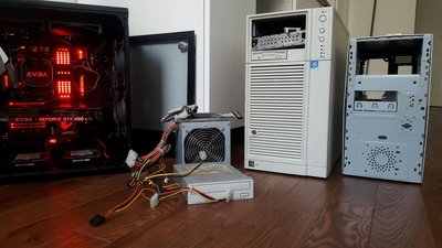

The case I've bought cheap for this build is a server one made by Intel. It's not 100% period correct and was made in 2002. I like the industrial look of it but it has very few 5.25 and 3.5 expansion slots, limiting my options to use Zip, Jaz, multiple optical drives and for this reason, I'll probably replace it later with something more suitable. But for now, I think it's alright. And it is much wider which would help fitting these tall Xeons.
There were few issues fitting the motherboard. The case is designed to house 603/604 Xeon. I had to drill 4 holes and make threading to install CPU support brackets which actually mounts to the case through the board since each of these Xeons weights more than 2 lbs.
This mounting method they later reused for the 771 Xeons I had back in 2009.

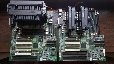

1.84 MiB
2459 views
Supermicro S2DGU Dual Slot2 440GX board with the Supermicro P6DBS Dual Slot1 440BX
I've been quite busy lately, I'll post the update soon! I have almost all the major components for this system arrived. 😎
