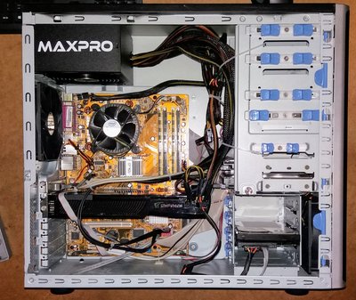

Hi.
I just finished my last build, a Quad Core CPU.
I never used a PC based on this CPU. I have been using Pentium 4 from 2000 to 2015 and after this an AMD A6-6310 CPU.
The purpose of this system is to run games that I can't run with my other build, a Pentium 4 @ 3,4GHz based PC.
CPU: Intel Xeon E5440. [2007]
Mainboard: Asus P5B.
RAM: 8GB (4x2GB DIMM).
HDD: 2x500GB (SATA II, 7200RPM).
DVD: Samsung DVDRW (IDE).
GPU: Gigabyte Nvidia GTX 280. [2008]
PSU: Enermax Maxpro 600W.
Chassis: Chenbro PC61733 (big and heavy box with two 12cm chassis fun)
The 'only' things that I bought are CPU, mainboard, RAM, GPU and power supply. I already had the rest of the components.
Why I decided for this specs?
- To continue with the CPU Intel timeline and cover the gap from Pentium 4 to the firsts Core I3 / I5.
- The PC must be a complete Windows XP compatible and works well with Windows 7.
- Since it will be dedicated to games the GPU are an important election but I don't have previous knowledge about this. Because of this I've started reading reviews in magazines, in this forum of course, wikipedia, etc and the Nvidia GTX 280 seems to be a good choice, not the better but enough for me.
- The parts are not too expensive.
In this moment I'm installing Windows XP 64 bits...

Reply 1 of 9, by Anaxagoras
1TB SATA II added and Windows 7 installed.
This build can be my main PC 😜
But I have some dudes about Windows 7 to run games developed for Windows XP.

Not bad, I use an E5440 on an Asus P5Q in my "swiss army knife" workstation. It's a beast for LGA77x & still capable of doing just about anything you'd want out of a modern PC. It's a fairly cool-running CPU and should have some headroom for overclocking if you want to try that.
I had a GTX280 in a similar machine for a while, but swapped it out for a 750Ti for better heat & airflow. Nice card though.

Reply 4 of 9, by Anaxagoras
Yes, It seems to be done the daily tasks (office, internet, edit photos, etc) and play any Windows XP game (including emulators) but if I want to use with some security I need Windows 7 to get security updates or if I want to run the latest version of Chrome or Firefox.
By the other hand, Steam and GOG Galaxy only works from Windows 7 and above.
Is Windows 7 fully compatible with Windows XP games? or There are any compatibility game-list or something similar?
If not, there is no problem because I have other PC to cover all the 32bits era (more or less), but I prefer one PC that do it all well.
