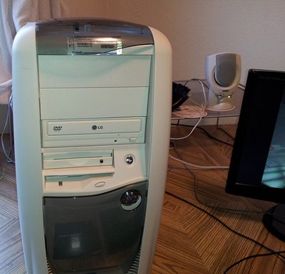

There it is! Earlier this week, I rescued the old PC this was in out of the storage room. I couldn't bring the whole thing home, but I took the board & expansion cards to have some fun with. I have no idea when the 400MHz CPU got upgraded to a 500 (I might have done that myself and just forgot??), but this is my P5A-B, which has probably travelled more than a lot of the humans who live on my current island.
Incidentally I've had this cool case sitting empty for a while (& posted about it a few times.) Neither of the projects I'd planned for it managed to gain any traction, but this seems like a suitable use too. I find it hilarious how much the tiny AT board is dwarfed in there.

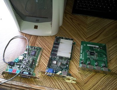

Here's the support hardware. I actually have a specific purpose for this build, and I want Glide & A3D for it, so we have a Voodoo3 3000, Turtle Beach Montego II, and a super-convenient NEC USB2 card (these work great on Win98 with the generic USB Mass Storage driver. The P5A-B actually has onboard USB, but I don't have the header bracket, and USB2 is so much nicer anyway.)
That's all that's going in for now. 😜 No SCSI, no ethernet... well, maybe later.
BTW I could have used my original Banshee; I still have it! But I figured the extra oomph from the V3 would be worth it, and the Banshee is installed in something else. I would've loved a V3 back in the day.

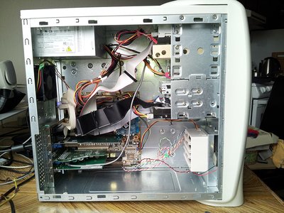

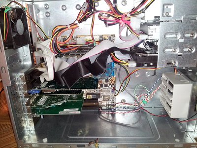

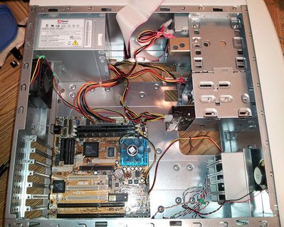

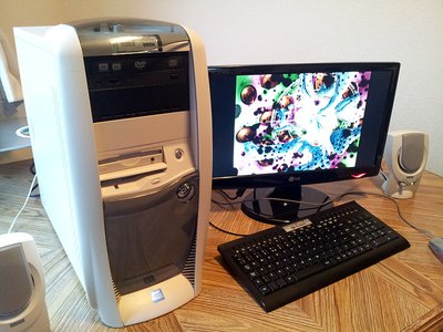

"Fully built" on the inside. Honestly not too messy. I hate the way the ribbon cables have to stretch all the way across like that though, wish they'd put the IDE/FDD ports on the other side.
145.03 KiB
3807 views
Closed up. Runs great, fairly quiet, fairly quick. Actually I'm pretty impressed how fast Win98SE boots & shuts down on such an early platform. I'm used to running it on things like Athlon XPs and P3s but this one chugs along really well.
Unfortunately I'm having driver trouble with the Montego II, so I stuck an old ESS card in to get sound just to try the thing out. I'll sort that out in good time though.
Anyway that's it for now! I had fun putting this together; it's pretty cool to have my old competitive rig back, at least in a way.

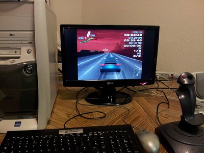

Reply 2 of 25, by xjas
Ahaha. So it turns out the swapping the 400@450 to a 500 may have been a significant downgrade on this board. I really have no recollection of when that was done or why, or who was using it at the time. If I was still gaming on it, you'd think I'd have noticed the performance drop. I wish I still had the original CPU to compare. Looks like a resistor mod is in the cards...
Weebob wrote:
Looks great!, what games are you planning to run on it?
I have a special, secret game that will be getting its own thread soon, but for now I'm enjoying some Descent 3 which I haven't played in ages. 😉 Albeit at 10-20 FPS (512x384, highest details.)

^^ check out that crunchy ordered dithering. I like this look way more than I should.
This is my first Windows machine with a (working) 3DFX card in a WHILE so I'm also going through the back catalog of Glide demoscene prods. There aren't that many, but they're fun to watch.

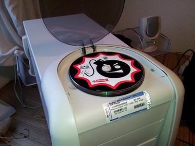

I actually love this case, it's so weird & such a product of its time. It's also super roomy and easy to work on inside. It came with a 1.7GHz Willamette P4 in it & has a date stamp of 2002, so it's a little newer than a K6-2 setup, but I'm using a pretty late CPU (2000) and I swapped cases a bunch of times along the way with this board, so I figure it's totally suitable. It even has screw holes for baby-AT drilled & marked (including the one in the middle of the CPU socket, which naturally I didn't use. 😜 ) I wish I had an AT I/O shield; there's a big gaping hole back there right now, but not a huge issue.

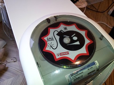

On this note, I figured out what the top lid and that weird cavity underneath it are for:
149.25 KiB
3423 views
152.42 KiB
3423 views
AHAHAHA. Is this the coolest thing ever or what? Well, I'll go with 'or what'. But I still love it. SOMEBODY thought this was just the most genius idea they'd ever had, and didn't shut up until it got built.

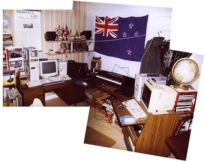

BTW, here's what this board was in in (probably) late 1999 or so - a cluttered teenager's bedroom, but also the big, somewhat disassembled full-AT tower on the left.
450.19 KiB
3420 views
I used to run my cases open for cooling then; can't stand doing that these days because of dust build-up. 😜 I think my Quantum Bigfoot (bottom left) had just failed & was replaced by a full-height, 3.5" 4GB SCA drive on an ISA SCSI card using a bunch of adapters. Hey, this was premium gear so I ran what I could get my hands on! I had a 350W AT PSU in there which was the biggest thing I could afford at the time & the first CD burner of anybody I even remotely knew, which I was exceedingly proud of.
I swapped the case at least one more time after this but I'm about 99% sure I lugged the big tower to Uberfest '98 or '99 in Atlanta. I lived near Toronto then, so you do the math. Sadly the tower got scrapped a few years later when I was moving & desperately trying to make room.
(That said... I just recently went through my storage room where all this stuff ended up; It's amazing how much of the junk in that pic I still have.)

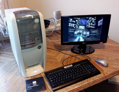

Couple updates on this. 😀 With the Montego II working, I can finally check out this Aureal A3D demo CD that I got who-knows-where probably a decade ago. Found it in my storage room in November, so the timing was fortuitous. 😜
341.49 KiB
3252 views
148.85 KiB
3252 views
162.27 KiB
3252 views
It has some interesting demo stuff & product info. It seems to be all made in Macromedia Director, so it should work on any system (all the A3D effects are "baked in" and independent of hardware.) I'll post a proper rip of this disc if anyone's interested.

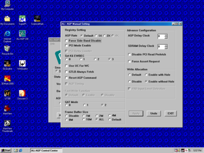

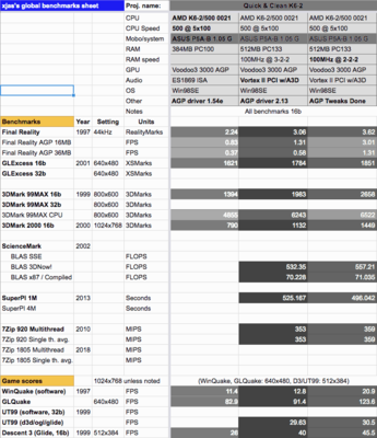

The next thing I did was tweak the hell out of the ALi AGP driver in order to get it running up to where it should be. I am now 95% certain my late-May, 2000 (date code 0021) K6-2 is not affected by the WB/WT bug after all, which goes against what people were saying in the other thread. Either I've got a unicorn board that isn't bugged, or a very late CPU with the older instruction set, or this combo works for some other reason; I dunno. Regardless, I'm quite pleased with the performance I managed to get out of it with a couple hours' work.
For reference, here's the AGP settings I ended up using:
33.29 KiB
3252 views
^^ knock on wood, but it's been pretty stable at these optimized settings. Other people have mentioned that GAT Mode 2 in particular is a little problematic & recommend dialling it back, but I haven't run into any trouble yet.
Naturally, here's a bunch of before/after tweaking benchmarks, because you know I did a bunch of benchmarks:
56.61 KiB
3252 views
There's more info and detailed results in the post I linked to up above. My 3DMark2000 score jumped from 790 to 1449, almost a 2x increase, and I saw similar gains in just about everything. There are a couple of hardware changes in there (ISA->PCI sound card, PC100 RAM -> PC133 @ 100 with tighter timings), but I'd estimate 90% of the gain came from switching to the 2.13 unified AGP driver and tweaking all the settings with the pictured util.
Descent 3 runs great now, and it even chugs away in UT99 botmatch pretty well. It's still a K6-2, and will dip down to 12-15 FPS in really intense spots in either game, but I'm fine with that. I learned these games on a system like this & I'm definitely no "locked at 60" snob. 😉
I'll probably try overclocking to 550 or 578 MHz in the future and see how far that gets me (this is a 2.2V chip so it should have some headroom), but enjoying it as-is for the moment.

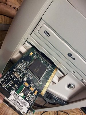

Next up, more 3D! I've had a Matrox M3D sitting around in a DOS machine for ages, but never found much use for it there (even had the box for it at one time, but that's long gone. 🙁 ) I decided to stuff it in here so I can run the odd PowerVR SGL software I come across. I'm not planning to use this card for DirectX, since the V3 will blow it out of the water for that, but it's nice to have a second option. OGL will be decided on a case-by-case basis.
Let's get it installed:
198.54 KiB
3244 views
^^ wait, that's not right.
347.27 KiB
3244 views
There we go! I had a network card in here but took it out for this. Every PCI slot is now used for proper purposes. I guess if I need ethernet I can use an ISA one.

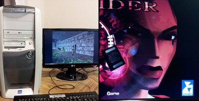

Here's good old Tomb Raider 1 in SGL mode. It even puts a little PowerVR logo in the corner to let you know what's doing the heavy lifting. 😀 This is a DOS game, so no sound because of my previous tribulations with the Montego II.
218.95 KiB
3244 views
To be honest, this was a great game but the graphics engine has aged kind of terribly. I don't mind the grid-based design or quads (big Descent fan after all!), but the art direction doesn't do anything to mitigate the engine's limitations & everything just looks thrown together and bad. Runs well enough though.

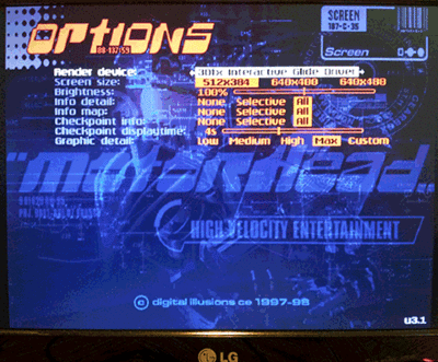

Let's try something prettier, well arguably. Here's Motorhead:
170.42 KiB
3244 views
First of all, I love this game. The soundtrack is by demoscene legend Blaizer/TBL (also known for Pinball Dreams/Fantasies, by the same studio, and a ton of other stuff) and it's a solid super-'90s-style arcade racer.
Like a lot of demoscene-derived game studios, Digital Illusions were all about using the hardware at the time. The last patch to Motorhead conveniently ticks all three major boxes for this system:
263.32 KiB
3244 views
Glide, SGL, and A3D 2.0. It was made for this thing.
...Well, sort of. I can't get the Glide mode to work at all; it always hangs when loading the track. Maybe a V3 vs V1/2 incompatibility; I haven't looked too far into it yet. SGL mode works, and looks good in that crunchy PowerVR way, but isn't going to win any speed records.
