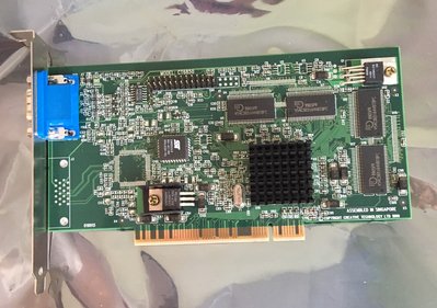

-Creative 3D Blaster Savage4 Pro 32 MB PCI

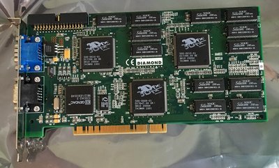

-Diamond Monster Voodoo2 8MB PCI

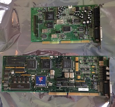

-SoundBlaster 16 Value (CT277A)
-SPEA V7 Media FX (Ensoniq Soundscape S2000 2MB with a different sticker on it).

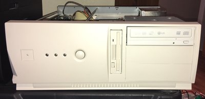

-Generic ATX Desktop Case

I am a big fan of Ensoniq Soundscapes, but it is annoying in this system.
-Windows ME will not detect this card automatically, and the drivers will not detect its settings correctly. Need to configure ports, IRQs, DMAs manually.
Two issues that I believe may be related:
-Cannot get the wave playback working in Windows ME. This isn't a big deal as I mainly use this card for the wavetable. I have Windows configured to play waves through the SB-16 and only use the Soundscape for MIDI.
-I haven't been able to find a pattern, but in DOS 6 the computer sometimes freezes on bootup when SSINIT.EXE is running and initializing the card. I assume there is some kind of resource conflict, but haven't been able to find it. I have the needed IRQs and DMAs reserved in the BIOS and have also tried different ones.
-On the plus side once it gets going, Final Fantasy VII in Windows sounds great as do all the DOS games that support wavetable.
The 3D Blaster Savage4 Pro is an "interesting" card to say the least. I picked it because it has good DOS compatibility, Windows 3.1 drivers, and at least some semblance of 3D acceleration for Windows 9x. The only drivers I have been able to get to work are the ones from the Nov 1999 update on Creative's site. S3's reference drivers blue-screen the computer, as do the drivers that came on the CD with the card. The Creative site also has a firmware update that is supposed to fix some issues that I applied. The DOS compatibility and games that use the Metal API (Unreal) are the highlights. Other things are hit or miss. I have the Voodoo2 installed both for Glide support and as a fallback for anything that doesn't like the Savage4.

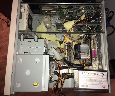

Reply 1 of 76, by Tenorman
Pics
424.21 KiB
1743 views
360.56 KiB
1743 views
451.51 KiB
1743 views
666.65 KiB
1743 views
198.56 KiB
1743 views
