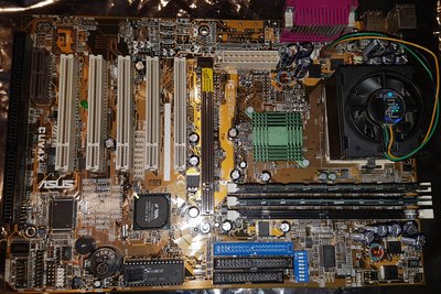

It always starts with a motherboard. Early last year I was visiting a friend who has basically his whole house full of all kinds of junk and I saw a motherboard there with a cpu and some ram. I was looking at it and he said that I can have it if I want. I was bit unsure if I would use it but it does have an ISA slot after all, so I took it

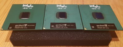

I didn't do anything with it for about half a year. I think it had 600Mhz celeron cpu on it, so I thought if I am going to build something using it, it needs to have pentium 3. I saw someone selling untested pentium 3 cpus on ebay for just couple of euros, so I bought 3 of them hoping that at least one of them would work and since they were so cheap.
1.66 MiB
547 views
I was lucky because they all worked fine. Now I would have even spares if I would ever try overclocking one.

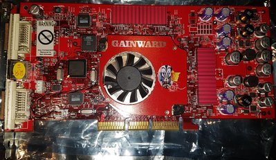

After one more month or so, I happened to get lucky with a video card. A friend had an old geforce card that was agp and he had no use for it. He wasn't even sure what geforce card it was because it was not written on the card. It was a Gainward Geforce 4 TI 4600, so I thought it would be good enough to run even some early 2000s directX games in win98se. On next days after I had tested the card I sent him a message asking if he knew if the thermal paste on the video card had ever been replaces and what he replied to me surprised me. He said that the card used to belong to his father and the card has never been used and it has just been stored ever since 2003. I was bit suspicious about it at first, but the card didn't really have any marks that would indicate that it had been used. Even the agp connector was pristine.

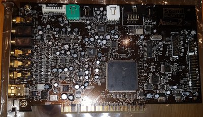

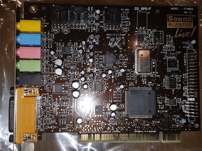

Since I had decent video card for win98 gaming, I decided I wanted to install a sound card to the system that would allow EAX support and also I wanted the system to be able to do DVD playback in windows and with awe64 48Khz -> 44Khz conversion was causing some issues. First I tried an old audigy 2zs, but I could not get it to work. It was detected in win98se, but when installing any driver the driver installation always said that it does not detect any audigy in the system. The pci connector of the card was bit corroded and even if I had gotten system sounds in winXP working when I had tested the card previous year, it seemed to have some problems.

I decided to go with sound blaster live instead. It could also do both EAX and 48Khz playback. Perhaps later I can switch to audigy card if I find a good one.

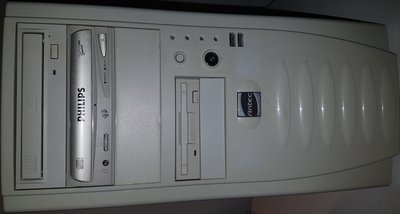

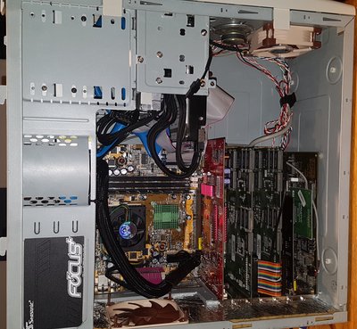

Reply 1 of 8, by Baoran

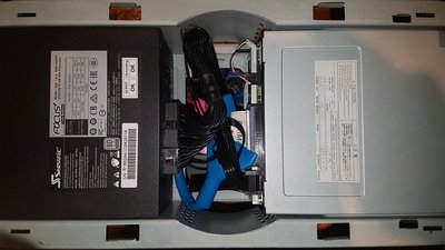

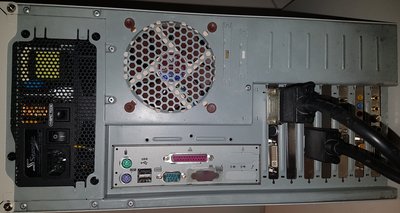

That is pretty much finished build right now. I think it has been almost half a year since I started working on it. I had originally an old period correct PSU that failed in middle of build so I decided to spend some money and buy modern one and I also bought 2 modern noctua case fans to help the voodoo2 cards breath. Those are the only modern parts in the system.
1.79 MiB
545 views
1.82 MiB
545 views
1.92 MiB
545 views
1.82 MiB
545 views
OS: Dos 6.22 and Win98se
Motherboard: Asus CUV4X
Ram: 256Mb
CPU: 1Ghz Pentium 3 coppermine.
Hard Drive: Seagate Barracuda 7200.7 80Gb
Optical drives: Toshiba DVD-Rom SD-R5002 and Philips CDRW1610
GPU: Gainward Geforce 4 TI 4600 + 2x Diamond monster 3D II
PSU: Seasonic Focus+ 550W
Sound cards: Sound Blaster AWE64 CT4390 + CT1930 Memory module and Sound Blaster Live! CT4830
3.5" Floppy drive
Unknown Antec case from early 2000s.

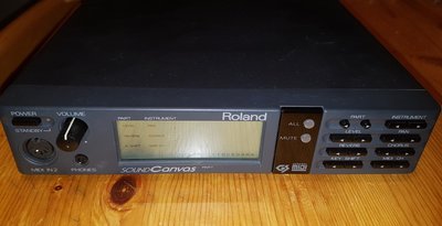

I forgot to mention that I am going to connect AWE64 to Roland SC-55 to get general midi working in dos.

Reply 8 of 8, by Baoran
