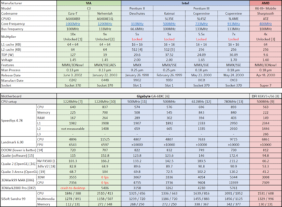

So, after building multiple systems to try and get performance that can be crippled down to low 386 levels required by older DOS games, but at the same time, being powerful enough to play some of the early Windows 98 Direct3D games, I started building a chart (WORK IN PROGRESS).

We all know that the AMD K6+ series CPUs are excellent at reaching a very wide performance range, and doing so in hardware, but their Windows performance is, in my opinion lackluster, and extremely picky with respect to memory, AGP videocards and drivers. Obviously, a Pentium III does give you fantastic Windows 98 performance but completely useless for vintage DOS gaming.
That's where the VIA C3 comes in.
My test for minimum required Windows 98 performance is the CPUs ability to decode in real-time MPEG2 video such as that in the Wing Commander IV DVD version without the use of dedicated hardware decoding.
The VIA C3 Ezra-T and the Nehemiah were both able to playback MPEG2 video, have unlocked multipliers, under/overclock VERY well, and produce very little heat.
Couple that with an Intel BX chipset and you get a far more reliable experience than you would on an ALI or VIA chipset for a super socket 7.
What I've build around the VIA C3 CPU:
-Antec NSK 4400 ATX case
-Seasonic ATX power supply
-Micron 512 MB PC133 CL2 RAM
-Gigabyte GA-6BXC Rev 2.0 motherboard (with PowerLeap BIOS)
-MSI MS-6905 Master slotket Rev 2.0
-Via C3 Ezra-T 1000 (100MHz x10) running at 1223MHz (112MHz x11)
-nVidia Quadro FX500 128MB AGP
-Powercolor Voodoo2 12MB PCI
-Corsair F120 120MB SATA SSD
-Promise SATA150TX2 PCI controller
-intel Gigabit PCI NIC
-TSSTcorp TS-H492C IDE DVD-ROM (with digital out connected to Yamaha soundcard)
-Yamaha YMF744 XG/OPL3 PCI soundcard using SB-Link
-Gravis Ultrasound PnP 16MB
So far, nothing I've tried on this setup failed that didn't also fail on my AMD K6-III+ setup with the DFI motherboard.
And unlike the K6-III+, I've had ZERO bleuscreens or freezes.

Reply 1 of 14, by tpowell.ca
Some of you may note the rather low FPS numbers in the DOS benchmarks. This is due to the nVidia Quadro FX500 card.

Reply 5 of 14, by Tenorman
Interesting. Thanks for posting your results.
It's funny that I am beating you at 3D Mark 99 even though my CPU is running 200 Mhz slower with a much worse video card. My guess would be that Nvidia's hardware and drivers get progressively less DX 6 optimized the newer you get.
Your Quake 3 scores somewhat of are an eye-opener. Your CPU is 20% faster and don't have sound enabled, but your score is ~170% of mine. I had intentionally not bothered to put much of a video card in my system because I figured the CPU would be too much of a bottleneck, but it looks like I need to give this thing a bit more credit.

Reply 6 of 14, by tpowell.ca
I believe drivers make a huge difference. I'll be trying some older drivers, see if I gain anything and resolves my issues with 3DMark on VIA CPUs.
I also want to see how much a different videocard makes of a difference in DOS. I'm debating between a Voodoo3 and a TNT2 for those tests.
