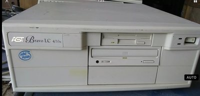

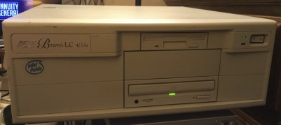

Hi, I have a computer to restore. It is an AST Bravo LC2 4/33s. ( Model 173m )
Made in USA by AST corp. of Texas I think. But they where head quartered in LA. California.
This must have been the first model Multimedia PC build by AST.
Build date is 1993 I think but this would have been a very expensive computer back in 1993. ( Dec 28, 1993 ).
I want to restore it to original.

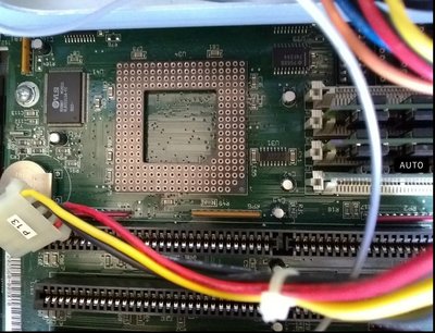

It has an AST motherboard ISA.
128kb cache. Has strange cache ram holders.
Onboard 486sx-33 CPU and Overdrive CPU socket.
NOT sure how much ram it supports.
I want it to run DOS and Win3x.
It has a Media Vision sound card, PAS16 ( Made in USA )
2x Sony CDROM drive. ( Original Media Vision sound card and CDROM setup ).
Onboard video is Cirrus logic CL-GD5424 ( 1mb. ).
Onboard IDE controllers.
For Network card I will probably add an Intel-Pro-10 or 3com 3c509
I plan on adding a 540mb IDE hard-drive. Most likely WD.
( MT ) Micron ram made in USA.
It has an onboard Intel 486sx CPU and an Socket for an upgrade CPU.
Does anyone know of the original config for this computer or marketing add or manual ?
What CPU upgrades do you think will work in this computer ?
Was this computer under powered for a Multimedia computer ? I think so.

Reply 1 of 25, by Intel486dx33

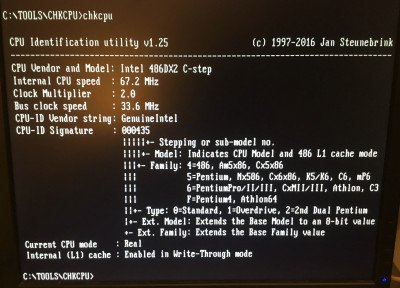

Well, I was able to upgrade the CPU to an Intel 486dx2-66 using the over drive socket.
And I upgraded the ram to 16mb.
I still need to get this CDROM drive working. The sound card works but I cant seem to get the Sony CDROM drive to work.

Seems to be nearly identical to the AST Advantage! Pro 486SX, with merely a different front bezel and drive bay arrangement:
7.84 KiB
2895 views
This one isn't mine -- borrowed the image from RetroSteamTech's blog. Mine is still the "before" picture, heavily yellowed and with a crack under the 3.5" floppy bay.
I have the SX/25 model. When it boots up, the BIOS even IDs itself as "LC". 😀

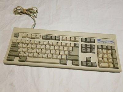

Mine shipped with the mouse in the image above -- a Logitech re-brand -- and an AT keyboard be SEJIN, similar to this:
203.27 KiB
2895 views
The only difference being, mine has a dark gray overlay around the LEDs and printed AST logo on the top left corner above the Esc key. I just took mine apart and gave it a thorough cleaning -- looks good as new. I don't have a picture of it, though -- hence the Ebay image rip. I played with this PC a bit last weekend and it is an absolute joy to use. It's whisper quiet, and typing on that keyboard feels like catching up with an old friend.
Reply 5 of 25, by SpectriaForce
Are you sure the CPU is a 486DX and not a 486SX, because mine has the latter one originally. That would make sense because of the 's' in the model name. Besides does yours also have a VLB slot? (update: I see yours has an entirely different motherboard!)
Reply 6 of 25, by Intel486dx33
This computer came with an onboard Intel 486sx-33mhz CPU
I changed the jumpers and used a standard Intel 486dx2-66 CPU in the over drive socket.

Upgraded the ram with one stick of 16mb ( 60ns, FPM )

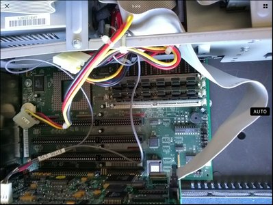

The only thing I was NOT able to upgrade was the cache. I tried several types but could not get the motherboard to recognize the cache.
I don't know what type of cache will work with this motherboard bios ?
Reply 7 of 25, by pentiumspeed
you need matched set of 9 pieces of 32K x 8 SRAM cache chips 25 or 20ns, or 15ns for fsb of 33mhz. All matched. Tag tend to be 5ns faster but if 15ns, just use all 9. Close all cache jumpers with 3 pieces of jumpers.
Or buy a motherboard with 9 pieces of cache configured for 256K and transfer.

Reply 12 of 25, by Intel486dx33
I like it !...

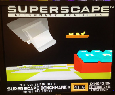

Runs smooth and quiet.

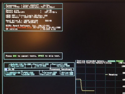

I upgraded the CPU to Intel 486dx2-66 , 16mb ram and 540 WD harddrive.
Installed DOS 6.22 and configured the Media Vision PAS16 sound card.
Sound good and plays games great.

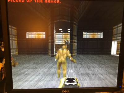

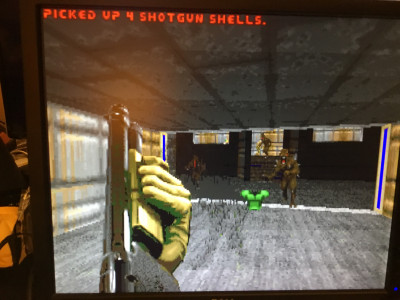

Reply 13 of 25, by Intel486dx33
And it plays Doom too.

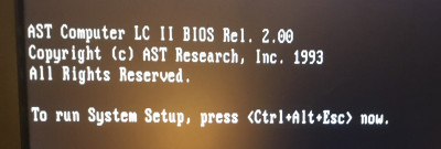

Just curious -- does your BIOS allow for >540MB HDDs? I'm wondering because IIRC mine reports "LC II BIOS Rel. 1.00", while yours is 2.00 and shipped with a HDD right at the barrier. ...which suggests they might have been thinking forward to the next model with >540MB drives, and could have lifted that 1024-cylinder barrier in Rel. 2.00. I haven't been able to find a BIOS image download anywhere (this was still when you would physically swap the flash chip though), although I had been searching for Advantage BIOS images, not Bravo. I'm fairly certain they'll be the same code.
Reply 15 of 25, by Intel486dx33
SirNickity wrote on 2020-01-16, 19:54:
The bios did limited the capacity of the hard drive to 400mb.

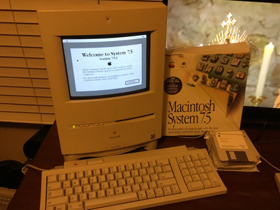

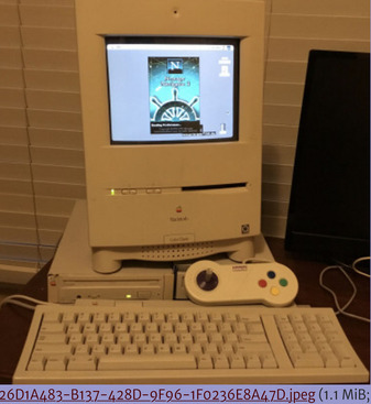

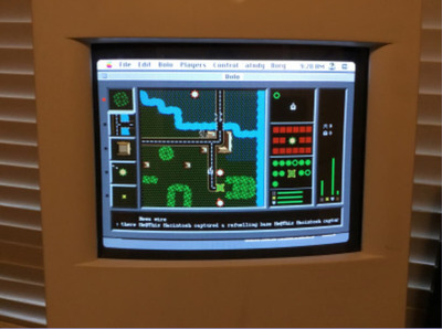

Also the Apple Macintosh color classic which sold for about $1080 back in 1993
Was a nice all-in-one computer which came with a color monitor and keyboard and mouse.
If you add a network card, 4mb more ram and speakers you could have a nice internet capable computer back in 1993.
So I think the Macintosh would have been the best value purchase in 1993.
My original Macintosh color classic with 16mhz CPU can still go on the internet today
Using a network card and Netscape 3x
Can download games and apps from internet.
