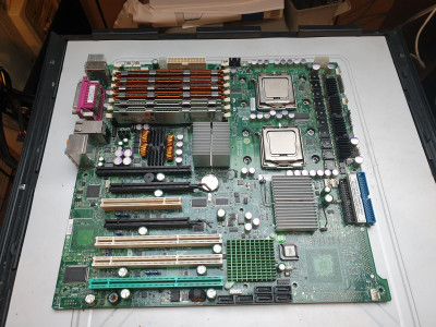

So here is the board, it's EATX, measuring at 304*331 mm.
490.09 KiB
1682 views

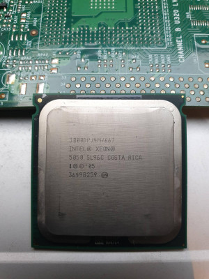

It comes from an Ebay auction I won, which ended up with me driving back from the far countryside with a vanload of various systems and their peripherals.
The board came equipped with two Xeon 5050's (Dempsey) and a motley crew of FB-DIMM. I'll get it properly stocked with 32GB just like I did with the Dell Precision 490 I got in the same Ebay purchase.
326.76 KiB
1682 views

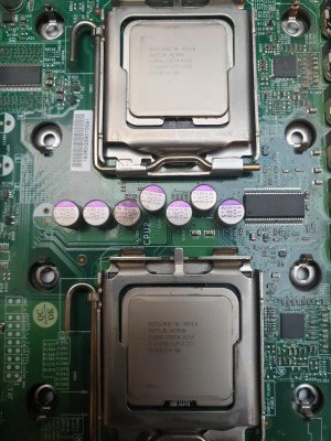

The Xeon Dempsey is the last Netburst-survivor, two 3GHz-dual cores on one S771 chip gave this system 8 threads (HT-enabled) as it stood. Netburst not being the point of this build, I upgraded it by replacing the Dempsey's with two Harpertowns as I want it to go head to head with the Dell.
Here are the two X5460 in their new lodgings:
350.17 KiB
1682 views
The Dell can only accept X53xx, so that one got two X5365's.

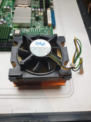

On to the coolers:
207.11 KiB
1682 views
I salvaged the coolers I got with the (now presumed dead) Asus NCCH-DL, as these heavyweights will do a better job of cooling the quads than the flimsy aluminium ones of the 5050's.

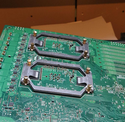

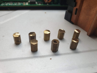

Only issue is that I don't have a case with the proper holes to have these coolers attached to. As a temporary solution I made bolts from standard stand-offs by removing the outer thread:
155.76 KiB
1682 views
The coolers are now tightly fastened to the mainboards.
Reply 1 of 19, by flupke11
This is how the backside currently looks:
205.7 KiB
1678 views

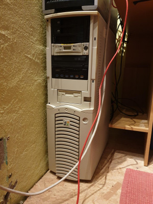

I'll stick it in an old Antec bigtower case, as the more modern cases I have are all too small to accommodate this 304*331 mm E-ATX beast.
A few things worry me though:
1. The copper coolers are splendid, but very heavy. As the CPU's are on the top right of the board, these two heavyweights will pull some stress on the board, as they are not fastened to the case itself.

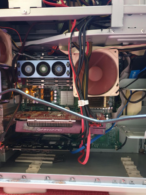

The system is finally completely assembled and received its 32GB of FB-Dimm craziness:
471.79 KiB
1605 views
With the original fans on, the whole case was resonating. One of the blades of the first fan was damaged, so it rotated out of balance, shaking the whole case along. In the end I decided to do away with both fans and I installed a Noctua 12cm over both heat sinks. Even with the two 8 cm fans at the back end, the whole system is reasonably quiet. Counting in the GTX275, I think we did a fair job on reducing noise.
337.98 KiB
1605 views
So that's the system as it currently stands. Nothing fancy, nor particular, nor authentic, just an old Antec case, with a lot of hardware in it. I've added a Soundblaster Audigy 2ZS Platinum Pro, and a USB3.0 VIA-based controller.
The DVD/CDRW is IDE, the slave is a very old IDE disk cage which is currently empty. The SATA triple disk cage only holds two, as one of the doors has broken off due to my lack of patience, and, let's face it, buying on the cheap. There was originally an ONTRACK 30GB tape drive in the case, but I'll try and install that in another build where that would be more time-appropriate.
Both Ubuntu and WinVista run excellent on this powerhouse.

flupke11 wrote on 2020-01-08, 11:28:
What is that that you're using to cool the memory with? Is it secured well?
I've got a very similar board (X7DBN) with the same amount of ram (8 sticks totaling 32GB) and am getting temps up to 127.5C on the ram. Some of this may be caused because I've mounted some (noctua) fans in front of the CPU (supermicro) heatsinks that blow across them towards the back of the case (and thus probably across the ram slots somewhat). I'm considering trying to squeeze a 40mm fan between the top-most CPU heatsink and the ram so there will be (better) airflow across the ram at least.
As a side note, I originally had oriented my CPU fans on top like you show but found the system would overheat. Moving the fans from the tops to the sides decreased temps at least 10C.
