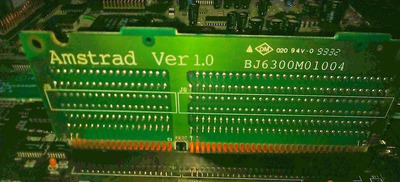

So thought it was probably time to start a thread on my current little project.....
The origins of this one go back a fair way so best start at the beginning. Back when I was a teen I was fascinated by the Amstrad Mega-PC they had on display at the Model shop in Gloucester, it was very cool and played all the games I wanted, plus it would be great for word processing. After much nagging my dad did get a PC, however it wasn’t a mega-pc much to my disappointment. I did get to have a go on one however as a friend of mine was given a Mega-PC Plus (yes the 486 version did exist !) as a Christmas present and I occasionally got to play with it when I visited – the mix of megadrive and basic 486 games was pretty cool – unfortunately he threw it away for a Pentium a few years later ☹.
So the Mega-PC always stuck in my memory – after doing a bit of research, about 8 years ago when I came across one with its monitor (rare!) keyboard, joystick and gamepad, that had been stored in in a shed, I brought it for the princely sun of £40. But that said the base unit was a state, it was covered in mud, the motherboard had suffered a battery leak and damaged the HDD controller and the 3.5” floppy drive had been replaced with a standard unit by cutting into the face plate (ouch!), also some idiot had cut the integrated monitor power cable in half ! Still with some careful cleaning and a repair to the power cable – amazingly it worked – abet without a HDD on the PC side due to the battery leak. After playing on the Mega-drive side for a couple of years and using the PC via the floppy as a word processor for locoscript (!), life eventually got in the way and it was stored safely away. Moving up to the present, recently my daughter started doing A level computer science at school, so I fished out the Mega-PC as a demonstrator system– rather than let her take apart my modern system for a look see.
This got me thinking, could I get it fully working again….. Well a quick search on the internet told me the motherboard could be replaced and as a plus I could in effect get a Mega-PC plus – and thus a plan was hatched and I waited 6 months for a 7486SLC to pop up. Due to Covid and people having time to clean their attics, one popped up recently that I was able to get hold of. It was missing its HDD and a few other strange things (such as the video ram oddity which I’ll talk about another day…..) – but they are as rare as Hen’s teeth these days, so despite these things, as it ran I brought it.
After looking at the faceplate of the 7486, I realised that I didn’t have the skill to transplant the 7486 drive cover into the missing bit on the Mega-PC faceplate and thus I decided as it wasn’t going to be a museum piece, I might as well go on the upgrade warpath and do some upgrades with some of the kit I have in store. So far the motherboard is in, the clock chip replaced with an Alt12887 and I’ve fitted a Gotek into the floppy bay (see photo) !
The current upgrade plan is:

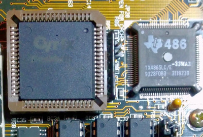

Fitted – 786SLC Motherboard, replaced Dallas Clockchip with Alt12887, Gotek Flash Floppy
Awaiting to add - Cyrix FasMath CX-83S87-33-JP Co-processor (who knows I may need it 😊 ), 16MB RAM, Quantum LPS 400MB HDD (Master), CF IDE Adaptor (Slave), Soundblaster AWE64 (for now as I have it to hand – will hopefully replace it with Keropi‘s special soundcard for the Mega-PC when its ready). A heatsink to add to the CPU (as it gets hot playing DOOM !), and perhaps a suitable flatscreen.....

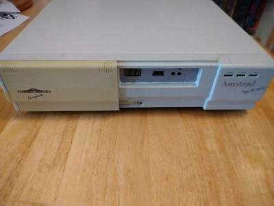

New Gotek Fitted !!
37.56 KiB
6965 views
Mega PC side (with original yellowing ;-) )

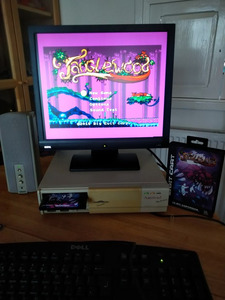

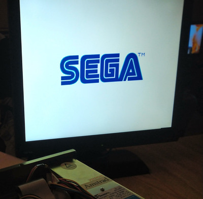

******BREAKING MONITOR NEWS*******
Last night I made a MAJOR discovery - an LCD screen that works on both the PC and Megadrive sides using ONLY a VGA cable and WITHOUT a scan doubler or any other modification !!
Since a lack of monitor is a major reason why MegaPC's often get discarded, and as the MegaPC is a picky beast and doesn't like many 15Khz dual sync monitors, the find of a modern monitor that works and can easily be purchased is a big deal !
Photos of the big discovery are below...

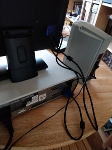

So the monitor I brought is a Benq BL-702A which cost £90 in the UK inc. P&P
45.31 KiB
6898 views
Benq BL-702A
With PC Side
87.14 KiB
6898 views
PC Side
No this isn't the new Microsoft Load Screen......
98.46 KiB
6898 views

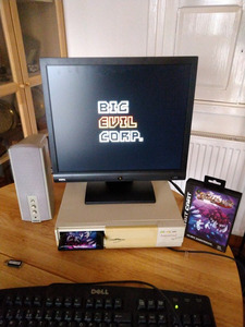

SUCCESS !!! - Displaying Tanglewood brilliantly from the Megadrive side
78.92 KiB
6898 views
Just in case you don't believe there isn't a scan doubler hidden round the back !!
86.6 KiB
6898 views
So folks if you have a Amstrad MegaPC, this may be the modern monitor you've been waiting for. Certainly a must buy if you haven't got a original megadrive monitor, and perhaps a good spare if you already have.
If only they came in 90's PC beige !!

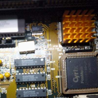

I have to admit I plagiarised your heatsink choice and have got the same type - just have to fit it now !
Reply 4 of 228, by keropi
here it is
mine came with adhesive thermal pads installed... I highly recommend a 40x40x10mm fan - it fits nicely but you have to use a little hotglue to fix it into place
there are also some mods that can be done to improve the megadrive audio quality, with Tiido's help we went from

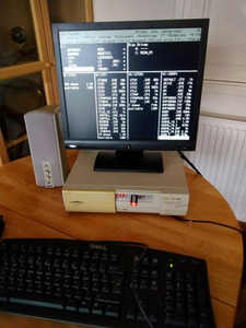

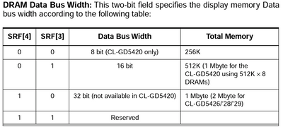

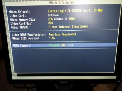

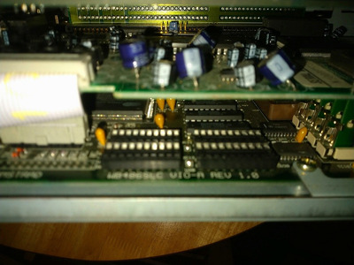

So when I brought the 7486 it had the 512KB video ram sticker on - however the seller told me that the ram had been upgraded to 1MB years ago. When I looked under the hood I found some AAA1M304P-07 chips in the sockets so that sounded reasonable......
However when I tried to run a couple of games, they complained of a lack of Video memory - odd I thought, I checked and re-seated the chips and then ran a test...
154.49 KiB
6870 views
Which told me that I had only 256KB video ram... odd so pulled the extra chips and still had 256KB RAM - which was due to the 4x 256k ram chips soldered onto the board.
164.4 KiB
6870 views
A check of the 1M chips showed they were working, So that got me off into reserch mode - and I looked into the video card spec sheets, which told me this.....
54.45 KiB
6870 views
So for those ram sockets to work they need to be filled with 4x 256k chips to give me (inc the soldered ones) 512kb total ram
If I want 1MB then I would need to replace both the socketed and soldered chips with 8x 512k chips.
The guy had brought 1M chips and installed them thinking he'd upgraded the video ram to 1MB - but they had never worked due to the video adapters requirements !!! 😂😂😂
However in addition to having a good laugh, I did learn a bit more about the 7486SLC's video adapter and its "Local Bus mode".
This is enabled by closing 2,3 on JP18 and JP19 on the motherboard - and I'd already enabled it at that time.
If you look back at the diagnostics image above you'll see it reporting the bus as "MCA" or IBM's Microchannel Bus - odd...
So looked into the specs and....
77.85 KiB
6870 views

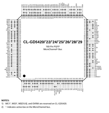

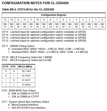

the 5420 definitely doesn't have VL-BUS which is a bit odd - but a few dozen pages down I came across this...
133.64 KiB
6870 views
Which confirms that the CF-7 on the 5420 enables MCA mode !
So the question is why is the MCA Bus setting labelled "Local Bus" on the board and why is the default video set to "ISA" on the board ??
My suspicion is that Amstrad was trying to avoid IBM's patents again (the PC1512 is a classic example !), and that as the patents for PS/2 and MCA were notorious, this was done to try and get round them.
I suspect they hoped calling it "Local Bus" would mean IBM wouldn't notice - and if they did, then they had the defence that it was set to "ISA" as default anyway and if the user changed it that was their fault !!! 😂
EDIT - That sound improvement is good - how was it done ??

I can tell you about "local bus" since it's one of the first things I tried. If you enable it you get a BIOS message on boot that "WINBUS" is enabled.
So this is something that works in conjunction with the WINBOND chipset and indeed it's the MCA pins 😁
it's thanks to winbond we have this nice speed boost - I made this pic ages ago in hopes that one day I will document all that stuff (fps is from wolf3d)
full size: https://i.imgur.com/5mWZ2V2.jpg
The jumpers connect to pins #14 (JP18) and #13 (JP19) of GD5420 and on "local bus" setting they connect directly to the W83C311 chipset (no datasheet for it sadly - ISA setting connects the 5420 to a different set of pins on winbond chipset)

Reply 7 of 228, by Zalog
keropi wrote on 2020-07-08, 12:02:
ah you also researched the onboard 5420!
I did some research though - it is possible in theory IMHO to replace the GD5420 to something better up to 5428 - the pins that connect to the 2nd ram bank to allow 32bit access are there - I have not checked about the MCA pins though - are they consistent on later chips as well?

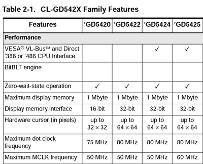

Looking at the diagram below it would indeed suggest that the MCA config is the same as the 5420 as for the 5428 (although the 5420 has a couple of reserved pins, which I suspect relate to the 32bit VRAM access) - I suspect your right and you could stick in a 5428 and replaced the fixed ram with sockets so you could reach the giddy heights of 2MB - although the soldering involved is way, way beyond my very limited skills to try out !

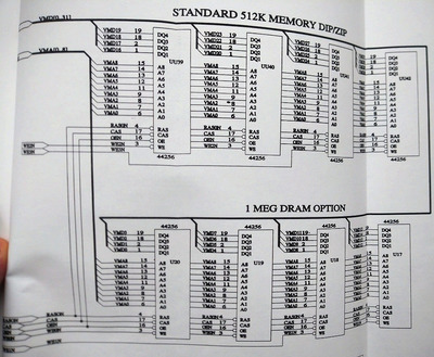

I looked out the scanned copy of the 7486SLC service manual and found this , which might be useful ...
215.84 KiB
6785 views
Looks like Amstrad didn't read the bit in the Cirrus Logic manual I found about 512k x 8 and feel that 256k x8 gives 1MB, which it does, although it may not be all usable with the 5420 (!!)........ Although your comment wondering about if this board was ment for a better graphics processor does make me think that with the 5428 graphics chip, a VRAM change might not be needed and you should be able to access the full 1MB??!

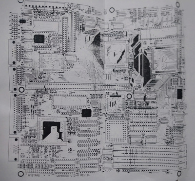

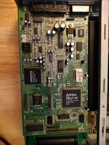

To help folk, here are a couple of quick phone snaps of a few interesting bits....
1.81 MiB
6736 views
Motherboard Image
Don't think this was the final revision though !!
340.56 KiB
6736 views
Diagram Lettering - 486 SX (!) Rev. B - suspect they were relabeling a 386SX design !

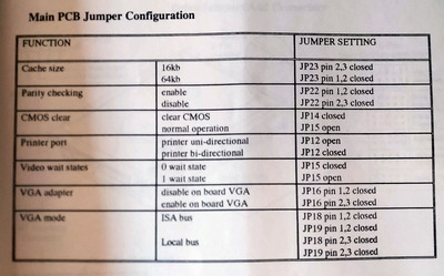

Actual Motherboard Lettering - 486 SLC Rev 1.0
And jumper settings for those that need them....
444.1 KiB
6736 views
Reply 13 of 228, by keropi
Ah even photos like these are great! thanks! I see there are missing details anyways due to photocopy
It makes sense they modified a 386SX design since the 486SLC will just work in place of a 386sx all it needs is bios to enable that 1kb of L1 🤣
Thanks for the jumpers, I was wondering what JP12 was for 😁

Have scanned the service manual and sent you a copy 😀 - it does confirm its basically a 386sx design, but as you'll see on diagram 1 of the fold out scans I sent, Amstrad added several specific circuits to the motherboard to support additional 486SLC features (Flush, A20M, KEN) in addition to the BIOS L1 cache support - which should help performance a bit.

So have been busy over the weekend.......
Dropped in a Cyrix FasMath 33Mhz Co-processor - unfortunately the Cyrix logo is a bit dull so it doesn't photo well 🙁
212.4 KiB
6623 views
Added on a nice gold coloured heatsink onto the 486SLC - things are running much cooler now and it does seem to make things run smoother under high work loads
134.01 KiB

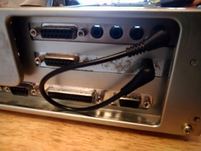

Dropped in my old AWE64 card, so now we have soundfx on the pc side - this isn't the final card, but it'll do for now until Keropi creates a special megapc one !
125.32 KiB
6623 views
Then link the Megadrive/Adlib card to the Line in of the AWE card to pass through the sound and mix them together - the mix of sfx and OPL2 music is pleasingly retro !
134.24 KiB
6623 views
All in all a very productive weekend !

I also noticed on schematic the vga chip is marked as "CL-GD542x" and not GD5420 specifically like all other ICs... so they just went for the cheaper option apparently!
Reply 19 of 228, by Zalog
keropi wrote on 2020-07-13, 11:18:
That's good, looks like there should be no problem adding a 5428 then 😁
BTW have you noticed the artwork on the reverse of the ISA riser card ?
176.04 KiB
6570 views
It looks like there was planned space for another 16bit ISA slot on the reverse of the riser (locations are marked J5/J6) - and probably left out to save costs and a backplate re-design too.
I am wondering though if this feasible to add an 8bit slot to J6 so that a small internal ISA card (maybe an XTIDE) could be added... as there does look to be just enough room for a small card in there 😀
