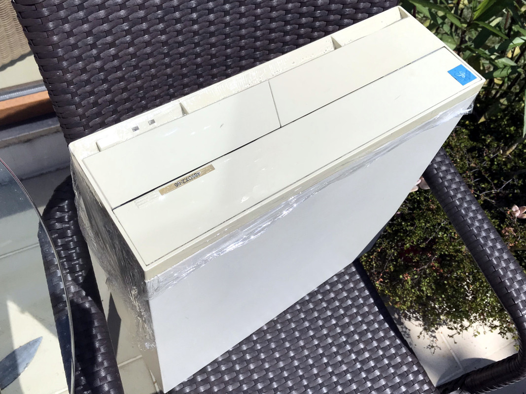

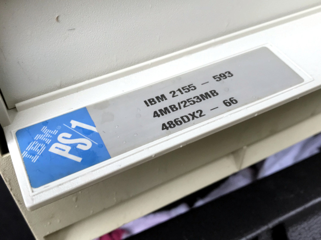

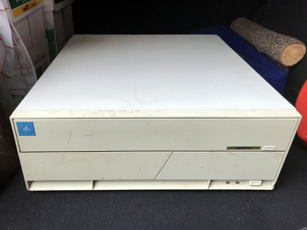

Earlier in the year, just before the pandemic woes struck, I saw an IBM case in a recycler's inventory. He usually sells me motherboards, CPUs and expansion cards he salvages from PCs and I am rarely interested in the cases as they are often in terrible shape by the time they reach him, but this one caught my eye. I had no idea what (if anything at all) was in it, but I had it shipped to me at a very modest cost. This is what it looked like when I received it:
IBM-PS1-2155-593-Original-State-02.jpg IBM-PS1-2155-593-Original-State-03.jpg IBM-PS1-2155-593-Original-State-05.jpg
It is from November 1993 and actually has a fairly neat configuration, top of the line for the IBM PS/1 products unless I am mistaken:
Upon opening the case up, I found that it actually had most of the components, as well as having been upgraded to 16MB of RAM. It was, however, missing the 3.5" Floppy/HDD drive cage and case spine part (which may have very well been missing from the factory as some of these boxes apparently shipped with 5.25" combi floppies instead) and the hard drive. Everything else, including the riser card, was present. I decided it would be worth salvaging and restoring, so many months later I got down to it.
First order of business was disassembly and a deep cleaning as the thing has apparently been a home to many different kinds of pests. Unfortunately I do not have any photos of the mess it was before I got to work, but this is how the motherboard ended up:

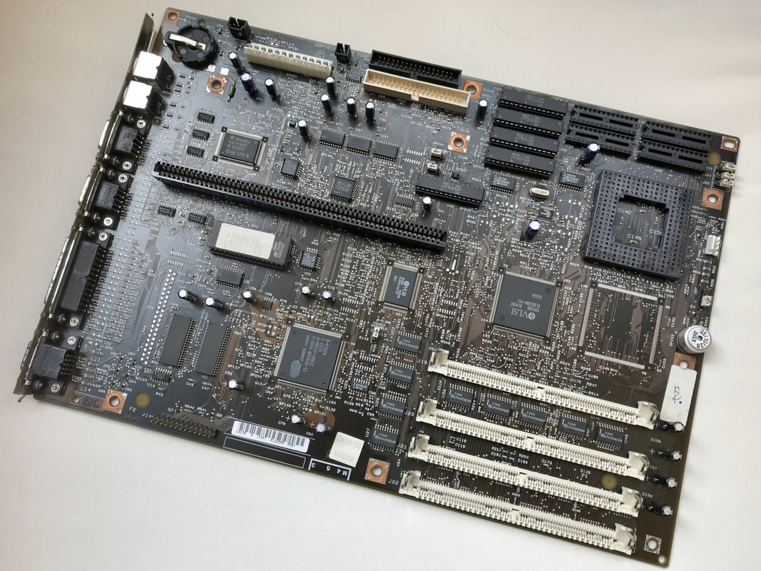

Quite a beautiful motherboard if you ask me. Next up, it was time for some retrobrighting:

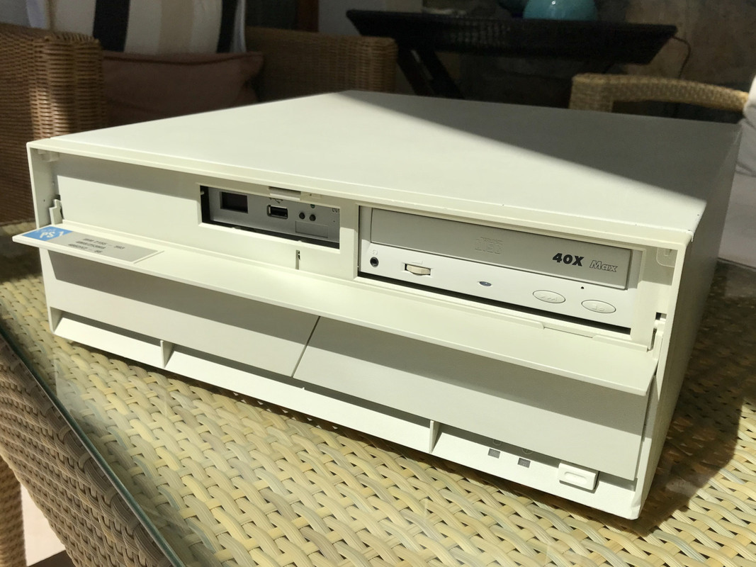

I replaced the missing drive cage to a 3D printed plastic part which did the job quite well. Instead of a real floppy drive, I opted for an OLED and buzzer modded Flash-Floppy GOTEK. I replaced the Hard Drive with a 512MB CF-IDE onto which I copied over a 1994 factory image from a US PS/1 Multimedia onto it. I also added a Samsung 40x CD-ROM and a Creative Sound Blaster 16 CT2290 to the system.
It turned out rather well, if I may say so myself..

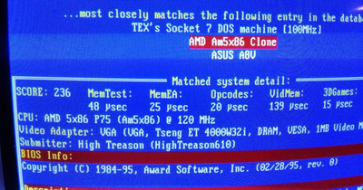

I went and pulled the trigger and bought an Am5x86-P75 AMD AM486DX5-133W16BHC. 169-pin chip with the voltage regulator to convert 5v to 3.45v. Plugged it in and worked perfectly. Crazy seeing 133mhz on this IBM PC. This thread has all the info you need for this chip info about "Am5x86-P75 AMD AM486DX5-133W16BHC Chip". Thank you for the responses to confirm 169-pin is what I needed.

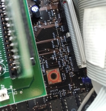

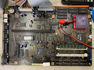

I'm working on a PS/1 2168 and the board looks identical to the board in this thread.
However, my board is set to 25Mhz and there doesn't seem to be a jumper to change it to 33Mhz.
The only difference I can spot int the picture is that the board in this thread has a jumper connected to j27
That's kind'a odd, because j27 is marked "speaker"
Does anyone have any ideas on what could be worth trying to get it up to 33Mhz?
Or maybe take a high res image of the board? I can'd quite make out the text on the chips or crystal in the picture.
Any advice appreciated, thanks!

Reply 9 of 29, by Thermalwrong
epictronics wrote on 2023-05-12, 07:44:
I'm working on a PS/1 2168 and the board looks identical to the board in this thread. However, my board is set to 25Mhz and ther […]
Hey there, just watched your video and I'm interested in this. Looks like the only difference is the CPU attached to yours that's not attached to the one in this thread.
It seems pretty silly that they'd hard-wire the bus speed so there must be some way to change it but maybe only during production - I'm wondering if they left some way to control that with some unconnected solder pads like I've seen for setting FSB and multiplier on laptops and things.
Could you get a closer in shot of the area around the 14.3MHz crystal without the CPU power wires in the way? That's where the PLL is so it makes sense to look there first.
It looks like the SPxxx things are just un-used pads and it doesn't appear that parts go there, but playing spot the difference between your board and the one in this thread - looks like there's a difference at R174 / R175 / R176 by the IDE socket. It could be worth checking if any of those link to the PLL and what the resistor values are.

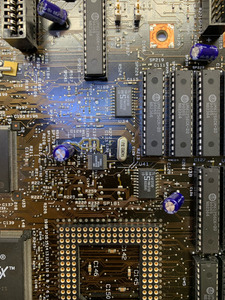

Reply 10 of 29, by epictronics
Thermalwrong wrote on 2023-05-13, 22:04:
Oh, silly me to leave the wires covering up the most interesting part 🤣
Let's try again...
It would be very useful with a close-up of the the 2155 board too if anyone reading this has one
Thanks

Reply 11 of 29, by Thermalwrong
Thanks, that helps - check this out:
1005.18 KiB
1913 views

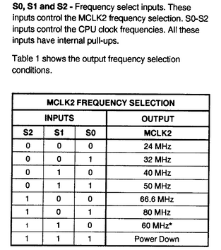

This is only my guess at the moment but the lines match up too well. I think the R174 - R175 - R176 are the solder/component jumpers to specify the PLL frequency. They are like this between the two boards:
-----PS/1 2155-593 DX33 ----- Your 25MHz PS/1
R174 ----- Populated ------- Not Populated
R175 ----- Populated ------- Not Populated
R176 --- Not Populated -------- Populated

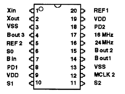

Have a read of the datasheet for the PLL here: https://www.datasheetarchive.com/IMISC418%20-datasheet.html
The S0 / S1 / S2 pins each have pull up resistors so if they are disconnected, I guess their value should be a 1 digitally:
26.53 KiB
1913 views
100.59 KiB
1913 views
The frequency table shows that 0-1-1 gives 50mhz and 1-0-0 gives 66mhz.
Given how well everything lines up, I think that the other side of the R174/5/6 pad goes to Ground. Meaning that if the Resistor pad is populated then it's pulled to Ground giving a 0 digitally - you should be able to change the frequency to 33 or higher by changing which pads are populated. It would be helpful to know the resistor value as well, should be quite a low value.
Hope that helps 😀

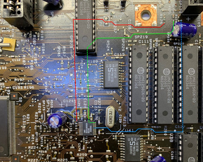

Reply 12 of 29, by Thermalwrong
Forgot to annotate this bit:
red line: S2
green line: S1
blue line: S0
Looks like you may want to upgrade the SRAM as well if you want to go for 33mhz bus speed or higher.
Reply 13 of 29, by epictronics
Thermalwrong wrote on 2023-05-13, 23:08:
You have a sharp eye!
The board is on the bench, let's give this a try : )
Thanks!

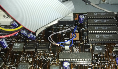

Reply 18 of 29, by theelf
epictronics wrote on 2023-05-18, 21:05:
theelf wrote on 2023-05-18, 18:18:
Hi guys, very interesting thread, i have a tower IBM 2168-552, 25mhz locked, take a picture too […]
R176 Populated
R174 & 75 NOT
I have a overdrive DX4/75mhz (3x25) and i will LOVE to overclock to 100mhz (3x33)
I just finished the video about this hack. It will go live on Saturday : )
Thanks, i watched the video, and decide to do
In my case, i dont have a good soldering iron, then i needed to improvise, decide to solder cables, and the resistors to the cables, less chances to damage motherboard
255.95 KiB
1607 views

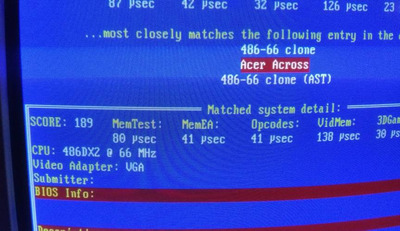

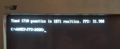

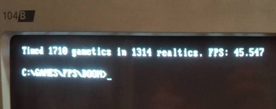

Lucky me, the DX4 overdrive boot without trouble, get more hot than before, but looks like not too much.... maybe better a fan?
Ok, benchmarks... the difference is HUGE!!!!
BEFORE
13.98 KiB
1607 views
79.65 KiB
1607 views
AFTER
15.68 KiB
1607 views
108.18 KiB
1607 views
AMAZING!!! i want to say thank you to all of you
