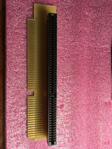

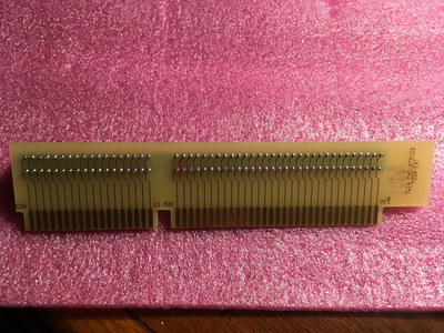

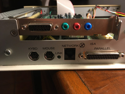

Reply 36 of 39, by his.lordship
Here are some pictures of the ones i got. As i said its not a perfect fit, but it can be fitted. I've not messed with this machine latelly, has a matter of fact i think never got put the cover with a card in 😀 it has always been kind of the dargging project all the time 😀, anyway i am sure thats an easy problem to solve, however it might be better alternatives.

Reply 37 of 39, by Jo22
his.lordship wrote on 2023-04-21, 20:18:
Hey, not bad. Looks good to me! 😃👍
The card itself fits perfectly fine, it's just the slot bracket that doesn't fit.
Technically, you can remove it and use a piece of plastic instead (that way, you can make use of the two mounting holes).
Say, from an old VHS enclosure (since it's flexible).
It can be a bad one from the 90s or 2000s, since VHS are becoming retro, too.
The big old 80s VHS enclosures use more fragile plastic, anyway, and are well padded on the inside (tricky to cut out).
In either case, the old bracket can then be used as a template. 🙂
Reply 38 of 39, by Hezus
Great to see you managed to find a fitting riser. Mine has an ISA riser, but I could use a PCI riser too to add some more cards.
