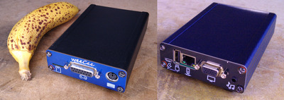

ICOP manufactures some super-small (70mm square) Vortex86-based System-on-Modules - https://www.icop.com.tw/product/SOM304RD-VI
So I thought they'd be great for building a lil DOS gaming PC -
The attachment weeceeview.jpg is no longer available

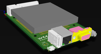

Of course it requires a carrier board with the appropriate connectors, so I designed one and open sourced here - https://circuitmaker.com/Projects/Details/rasteri/weeCee -
The attachment 3dweecee.jpg is no longer available
The module itself doesn't really require any supporting components beyond a power supply, so the only components I had to add on the board were a CS4237 sound chip connected to the module's ISA bus. This gives it Soundblaster and Adlib compatibility, and I figure I'll connect a Sound Canvas through the joystick port when I set it up permenantly in my living room.
I made a build log video here - https://youtu.be/aJEp4ZUG7BI

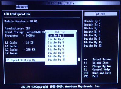

It works really well. Although the processor is 800MHz, the Vortex86 is much slower per clock than Intel processors, and can even be throttled in the bios for running speed-sensitive games :
The attachment clockdiv.jpg is no longer available

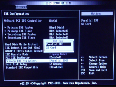

And it supports booting directly from an SD card meaning cheap/accessible storage :
The attachment sdcard.jpg is no longer available

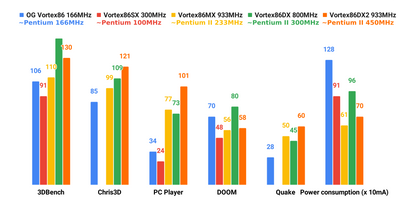

I'm gonna do a bunch more tests and benchmarks on it, but I have run it (and some other Vortex CPUs) through some of phil's dosbench suite :
The attachment chart2.png is no longer available
I also have a Vortex86EX based SoM that I will benchmark shortly.

Reply 9 of 1119, by kdr
rasteri wrote on 2021-04-13, 10:33:
It works really well. Although the processor is 800MHz, the Vortex86 is much slower per clock than Intel processors, and can eve […]
Wow, the performance increase going from the 166/300Mhz parts to the 800/933Mhz parts is.... extremely modest. Any idea what's going on with that?
Perhaps the benchmarks are maxxed out on video memory bandwidth?
Anyway I like your project and will be keen to take another look once you have a final version of the board!

Reply 13 of 1119, by rasteri
kdr wrote on 2021-04-13, 23:35:
So the original Vortex86 was based on the Rise MP6 which I believe is like a Pentium in terms of architecture. I don't think the Vortex86SX and later processors are based on the MP6 at all, however. I suspect for power reasons they're some sort of RISC-like processor that simulates the x86 instruction set in microcode. This means you have to clock them higher to get the same performance but they use much less power.
Mu0n wrote on 2021-04-14, 18:07:
