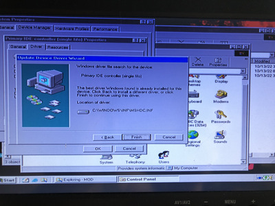

Ah, I see that the Hardware ID for the IDE controller is PCI\VEN_17F3&DEV_1011 - the driver currently expects PCI\VEN_17F3&DEV_1010 since I wasn't sure which one we had in the WeeCee.
I'll get that changed, fingers crossed hopefully it'll work.
Also, here is that VGA driver I found that might give OpenGL in Windows 98, just an INF mod here, hopefully it works. Give it a try.
Okay gave second one here a try and still no dice. Gonna see if I can’t force it somehow. Attached screenshot of result.
Reply 463 of 818, by NachtRave
Okay well, I tried reinstalling driver for the main entry (not the individual IDE primary/secondary controllers) and got the driver installed.
Looks like it liked the MOD folder for initially selecting the driver, but then needed the ORG folder for full install. I don't know what files it copied over, but let me play around with it some more when I have some free time.
Ultimately the device item is still having trouble tho (exclamation point next to driver), still has drive C/D on compatibility mode drivers.

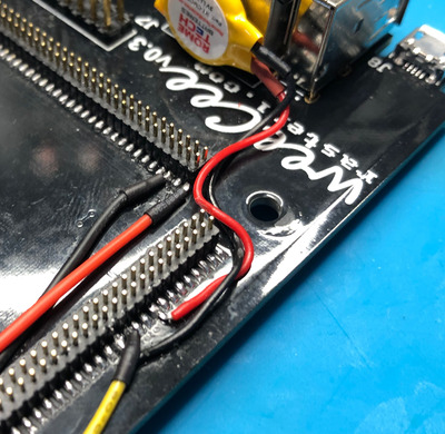

Bodge wire connection on SN10. The red wire is a bit taunt from being cut a hair short, but it works. I had enough of possibly burning the wire coating right next to where it was soldered into, so I’ve just become accustomed to fitting a tiny bit of heat shrink on the end to hide any blemishes like that (not that I needed it on this one). Overall looks pretty good.

NachtRave, Can you install this modded driver onto the "Standard Dual PCI IDE Controller" instead? I believe that should be the right device for this driver (It'd be nice if Windows 98's Device Manager would tell you the Hardware ID so you know for sure though)

When you got that X installation disk error message were you able to manually point to the MOD folder for the driver? or did it get stuck there?
What code is Device Manager giving for the yellow exclamation mark after you installed the driver?
Can you click on "Driver Details" and get a list of the driver files?

Alright had a chance to sit down and try this again, copying the MOD folder overtop of the ORG folder and then installing from there.
Initially restarted and got a "Windows Protection Fault" starting Win98... Uhoh... Reset and boot back up, and get the following device status in device manager: "Windows stopped responding while attempting to start this device, and therefore will never attempt to start this device again (code 11) For more information, look up ASD in Windows Help" - drive C/D still in compatibility mode, still have a ! next to ITE IT8211 ATA/ATAPI Controller.
Well, was worth the shot, but no dice.

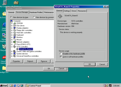

I've got another idea that I'll try -
Port ReactOS UniATA driver to Windows 98. I'll use 86Box on my end for testing.

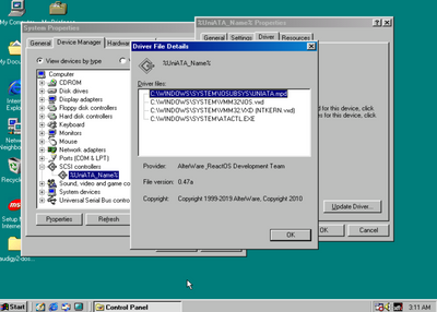

Reply 471 of 818, by Duffman
Welp, I got Windows 98's Device Manager to show "This Device is working properly" with the UniATA driver... But is isn't actually working and Drive C is in MS-DOS mode still...
217.17 KiB
385 views
237.33 KiB
385 views
I guess this is a dead end too.
I know this is a bit of a long shot, but has anyone tried rloew's SATA patch to see if that does anything? I recall that it was the "Primary IDE Controller (single fifo)" that was showing the yellow exclamation mark? It runs on the ESDI_506.pdr which rloew's SATA patch modifies, maybe we'll get lucky and it'll just happen to fix it?

NachtRave, Can you post a Screenshot of the error message that Device Manager has been showing for the IDE Controller?
Is it on the "Standard Dual PCI IDE Controller" or "Primary IDE Controller [dual fifo]" or both?
