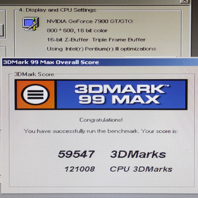

Hi guys, first post here.
I´m Armando (aka baguete), I'm from Portugal and recently rediscovered retro gaming and other stuff from my youth. I watched the PCIe Windows 98 video by Phil and wanted to check that topic also.
So I built a machine with the following specs:
Asus P5G41T-M LX V2 LGA775 Motherboard
Intel Xeon X5260 3,33GHz LGA771 CPU @ 4GHz
4GB DDR3 1600MHz @ 1277MHz (2x 2GB Kit)
NVIDIA GeForce 7900GT 256MB GDDR3 PCIe with 82.69 Unofficial Drivers
120GB SSD on SATA II with IDE Compatible Mode
All necessary updates/patches and chipset drivers

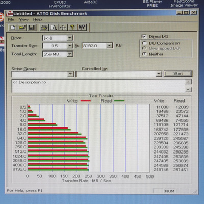

Everything works, SATA II ports (around 250MB/s using IDE Compatible Mode PATA Primary/SATA Secondary), USB 2.0 (including flash drives, generic USB Sound Cards, external drives), PCIe 1.1 slot and IDE port (disabled the LPT port, COM ports, Onboard Audio and LAN).
Did some 3DMark benchmarks and the results are great (3DMark 2000 locks the system as soon as the Helicopter benchmark starts, can anyone help?).
What do you think? Higher results can be achieved using a better GPU like a 7950GT (or even a 7950 GX2) and overclock the CPU on a better motherboard (this one only goes to 399FSB and I got 4.6GHz out of this CPU on a Asus P5Q3 motherboard)?

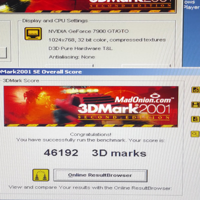

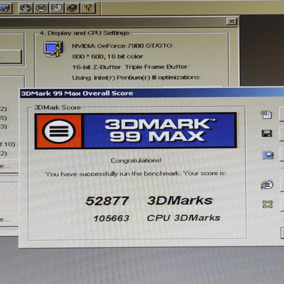

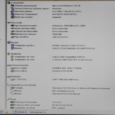

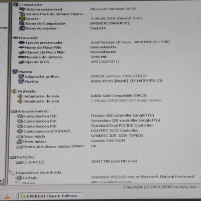

Some "screenshots" with my phone, sorry for the low quality, I will get better pictures next time.
Lots of system info are wrong on these old apps, but you get the idea.
Startup and shutdown are very fast and general system usage is blazing fast, can even run some games from late WinXP era with high frame rates (using KernelEx).

Reply 12 of 109, by baguete
Good news, overclocked the Xeon X5260 to 4.6Ghz on a Asus P5Q3 motherboard and oh boy, it was possible to squeeze a bit more.
I can´t overclock this CPU even more, it starts to get very hot when I try to increase the voltage to get higher frequencies but the system is not stable anyway, 4.6Ghz is a good overclock over the stock 3.33Ghz.
Also I can't disable one of the cores inside the BIOS, I will check if it is possible to disable them on a Xeon X5460 (4 cores at 3.16GHz).
Do you think the system is starting to get GPU bottlenecked?
Don't know if I want to continue to persue even higher scores, have to spend some money on a 7900GTX that is way more expensive then the 7900GT I got, maybe some Water Cooling/Liquid Metal for the CPU and test other motherboards to check for a better CPU overclock, looks like a lot of work for little gain.
Phil got 43678 on 3DMark 99 Max and 37469 on 3DMark 2001 SE with the Radeon X850 XT PE, is it better than the 7900GT or 7900GTX?
Anyway, hope you enjoy the results and I will upload some videos of the benchmarks later on after I upload them to Youtube.
