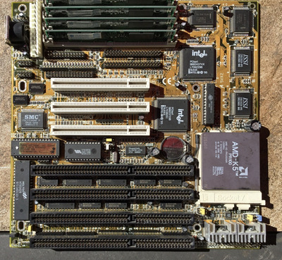

1) Motherboard - Acorp 5vx2 with Intel 430vx Chipset motherboard.
* Basically a strip down Intel 430vx motherboard. ( Super easy to install )

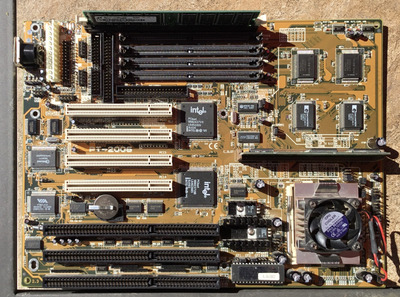

2) Motherboard - FIC PT-2006 with Intel 430vx and USB ( With USB a little more difficult to install )

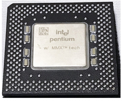

CPU - ( Socket 7 ) 75mhz thru 233mhz Pentium class CPU. ( AMD k5,K6 or Intel Pentium )

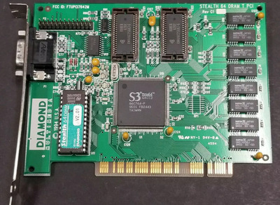

Video card - S3 trio64 ( PCI ) ( Plug-n-play)
*S3 trio64 DX ( PCI ) ( Requires drivers but supports more games )

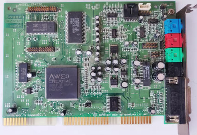

Sound card - Sound Blaster AWE64 ( CT4500 ) or ( CT4520 ) ( plug-n-play )
* Sound Blaster AWE32 ( Plug-n-Play )
* Sound blaster 16 ( plug-n-play )

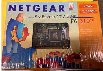

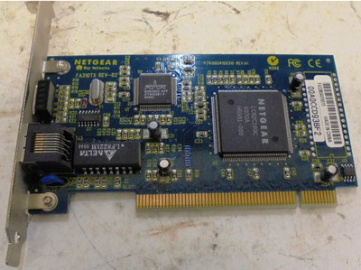

Network card - For “Plug-n-Play” I use the “3com 3c509 ether link III” network card.
* I actually used this Netgear FA-310tx card which require an additional driver install.

The AWE64 will work and sounds great with default Win95b included drivers but you dont get all the
Additional programs and feature of the sound card. So it is best to install the Sound Blaster software.
From my observation. The AWE64 provides the best sound quality and sounds are closer to the “Roland GS” MIDI standards than the
Sound blaster 16 with Yamaha OPL. That's why I choose the AWE64 sound card.

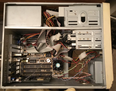

Reply 1 of 77, by Intel486dx33
More phots:

Link: http://www.vogonsdrivers.com/getfile.php?file … d=9&menustate=0
That's not the correct driver CD for the CT4520.
This is.
Reply 3 of 77, by Intel486dx33
Joseph_Joestar wrote on 2021-07-02, 16:06:
Intel486dx33 wrote on 2021-07-02, 15:06:
This is.
Thanks. I was not sure which one would work with the CT4520.

I have been using the Acorp motherboard with Pentium 75mhz and it is working well but I think I am
Going to swap it out for the “FIC PT-2006” with more motherboard cache and RAM
I am going to use this FIC motherboard with Pentium MMX 200mhz and 512kb motherboard cache. Has a 128mb RAM stick too.
This is a high end Win95 era motherboard.
https://stason.org/TULARC/pc/motherboards/F/F … um-PT-2006.html
I have never tested this used motherboard so I hope it works.
Cross your fingers.

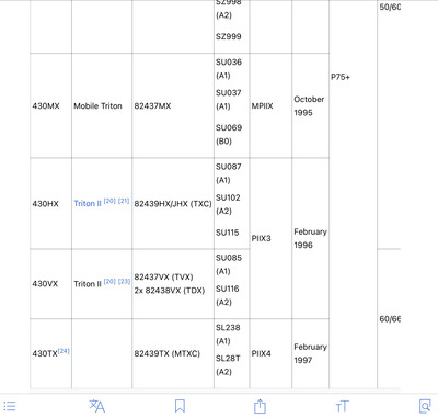

Reply 6 of 77, by Joseph_Joestar
Doornkaat wrote on 2021-07-13, 12:13:
I always considered the 430VX chipset Intel's lower end offering for 1996 given the decreased memory limits (128MB/64MB cacheable vs. 512/512 on the 430HX), no parity/ECC and absence/reduction of performance features present in the HX. It also lacks SMP (though of course that's irrelevant in single-CPU boards).
I don't think the board offers any OC settings either. It's still a decent board but would you really call it high end?
The VX doesn't support UDMA, does it?
Unless I'm missing something, the 430TX chipset is better than the VX in every way. Going for the HX makes sense if more than 64MB RAM is needed, but in most cases, a Win95 system would not benefit much from that.

Reply 9 of 77, by BitWrangler
Top CPU of a generation often goes for twice to four times the price of the next one down, so there's a case of "just not worth it". 200MMX will still be fast on MMX required software and 233MMX will still be too slow on PII required software. However, there were some boards top out at 200 for power reasons, and some won't run MMX at all due to no split plane voltages. There are a few boards where the power would be okay and the stated max is 200, because the only official multipliers given are 1.5, 2, 2.5, 3... with no acknowledgement that 1.5 works as 3.5 for CPUs capable of it.
Edit: looking closer at the board, it looks like one of those with linear voltage regulators. Those tend to top out lower than a switch mode supply. Look up the part numbers on the parts attached to the heatsinks and figure out if new ones are easy to get and inexpensive. If the answer is yes, then try fast and overclocked CPUs while keeping an eye that these don't get too hot, if the answer is no, stick to original recommended/supported CPUs.
Reply 10 of 77, by Doornkaat
Joseph_Joestar wrote on 2021-07-13, 12:30:
Neither 430HX nor 430VX support UDMA but realistically it's not an important feature with Socket 7 systems imho.
TX performs about on par with 430HX and both outperform 430VX. I prefer the 430HX because it feels like a high end offering while I think it really shows that Intel was abandoning Socket 7 when they released the 430TX. I don't think they really tried with that chipset.
But as long as you don't need more than 64MB cacheable I would say the choice between 430TX and 430HX is mostly down to preference.

AngryByDefault wrote on 2021-07-13, 13:19:
Great post, it should give a great starting point for anyone wanting to build a rather painless system. […]
I have a question though, that CPU limit you mention, does it mean there are Socket 7 boards not compatible with intel 233 MMX CPUs?
I often see the 233s somewhat relegated, as if they where not better than a 200. Is that so or it just that the 200s seem to be *much* more available than the 233s?
Thanks.
The 233MHz Pentium MMX are a bit faster than the 200MHz variants. The 200MHz variant is more avaliable because it was obvioulsy cheaper when they were new and because originally the MMX didn't release in a 233MHz variant. That was introduced in the second stepping.
There are some compatibility problems:
Not all Socket 7 boards support MMX Pentiums to begin with because not all Socket 7 boards have split voltage support.
Many people don't realise that even though their board does not officially offer a 200MHz setting (66MHz FSB * 3.5) the second stepping of MMX Pentiums will use a 3.5x multiplier when using the Pentium's 1.5x setting.
[Edit: Both already answered by BitWrangler.]
There is an issue with some multipliers not being avaliable on some Socket 7 boards becuase the Pentium MMX needs the BF signals pulled high in order for them to be registered as "high" while Pentiums only need BF signals to be pulled low to register as "low". I think it's possible to mod any board with a single resistor somewhere on the socket pins so the board actively pulls the BF signals high. (I have only recently read about this in a thread here so I'm not 100% sure I explained this right.)

This motherboard has some limitations
Limitations are:
75 thru 200mhz Socket 7 CPU.
Up to 64mb EDO ram
Up to 8gb IDE hard drive. ( Will work with larger capacity hard drives but bios is limited to 8gb capacity volumes )
Up to 512kb motherboard cache.
Thanks.
Yes. I think many Intel 430TX motherboards support AGP and 233mhz CPU. But older motherboards don’t. Many top out at 150mhz or 200mhz CPU’s.
No 430TX-based motherboard supports AGP.

humm... I need to start learning fast about this FSB and mutiplier thingy before I start blowing boards and micros up... I never gave it, nor to overclocking, the slightest attention so far... Thanks for the info. (bookmarked!)
Reply 14 of 77, by Intel486dx33
Doornkaat wrote on 2021-07-13, 14:12:
Intel486dx33 wrote on 2021-07-13, 13:58:
Thanks.
Oh, I must have confused the 430tx with the bx440.

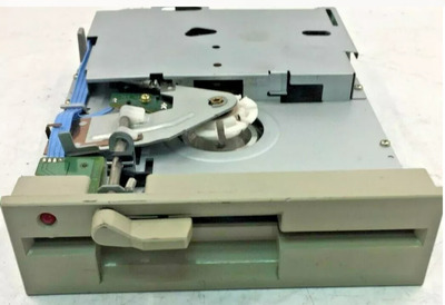

Reply 15 of 77, by Intel486dx33

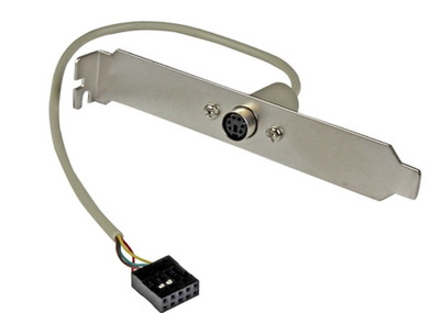

I am going to add a 5.25 floppy drive.

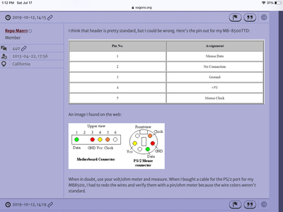

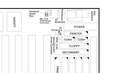

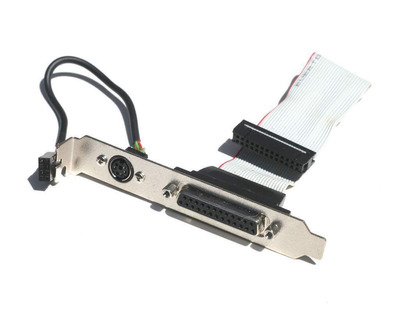

Reply 16 of 77, by Intel486dx33
There is no info about the PS/2 motherboard connector pin out in the manual. So I am going to try this.
Cross your fingers.

Reply 19 of 77, by Intel486dx33

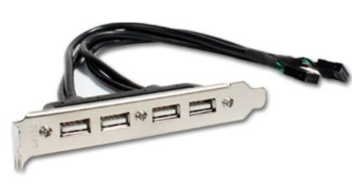

I have some components on order so I can finish swapping out this motherboard.
