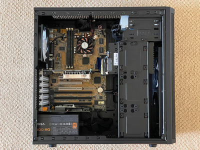

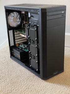

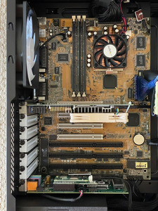

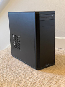

I’ve had a great time working on my first Socket 7 build in over a decade. This project started with me struggling to get certain retro games working on Windows 10. Source Ports, hacks, ScummVM, and DOSBox allowed Windows 10 to meet and even exceed my needs for a long time, but I was re-organizing and cleaning out my storage closet during the pandemic and realized I wanted to do something with many of my old/favorite parts I've held onto over the years.
I initially set out to solely assemble an overkill Pentium 4 Windows 98 system. I realized once I started posting here (thank you Joseph) that I would run into a number of issues playing older speed sensitive games. The Pentium 4 build was perfect for my late DOS and Windows early 3D accelerated games, but I now understood how I could assemble something better suited to early DOS.
After finishing my Pentium 4 build I went through my parts and found that I already had processors, memory, motherboards, graphics cards, sound cards, drives, cases, power supplies, fans, and more lying around so I figured I would probably be able to pull this off without purchasing anything new to me.
I originally was going to put together something with a Pentium MMX 233, 64MB RAM, S3 VirgeDX, Voodoo1, PCX2, and ESS ES1868F but decided to go in a different direction once I started researching things.
I eventually settled on the following:
- Asus TX97-X REV: 3.00 (Socket 7 Intel 430TX)

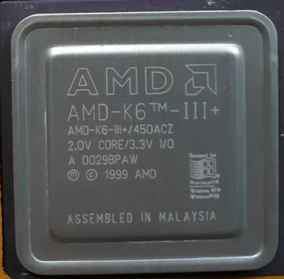

- K6-III+ 500 (6x83MHz)
- 256MB PC133 CL2 (2x128MB)
- 3dfx Voodoo3 3000 PCI (w/ Noctua NF-A9x14 slim case fan)
- Orpheus + PCMIDI + WP32
- 80GB Intel SSD 320 (w/ Startech IDE2SAT2 adapter)
- Startech FAN3701U CPU cooler
- EVGA 500 BQ power supply
- Fractal Core 2300 case
- LaCie Electron 22blue IV CRT
I also have the following but just haven't gotten around to installing them since I haven't needed them:
- Gotek SFR1M44-U100 floppy emulator
- Intel PRO/1000 GT NIC
The cool part to me was that I only ended up needing to purchase some adapters, cables, and the Orpheus + WP32 (which is really just an awesome product I wanted to support).
The most eye-opening part of this project was realizing I could use a K6-III+ on my Socket 7 motherboard. I was able to do this on my Intel 430TX chipset Asus TX97-X motherboard with the K6-III+ 500 running at 6x83 via the patched 0112X_J2 BIOS from The Unofficial AMD K6-2/3+ Page. I was surprised that I've had zero stability issues with an 83MHz FSB even though my memory timings are set as low as possible. Paired with SetMul, this has been an extremely versatile build that runs Quake II at 92fps (640x480) while also allowing me to slow the computer for some old Sierra and Lucas Arts games. The K6-III+ also allowed me to (unnecessarily) put 256MB in the computer.
The only area where I've ran into problems is with Tomb Raider 1 which doesn't seem to like the Voodoo3 even with the Voodoo Rush patch applied. I'll make a separate thread about this, but it's definitely had me considering adding the PCX2 or Voodoo1 card back into this system for early 3D accelerated stuff since I’ll probably play anything later on my Pentium 4 system.

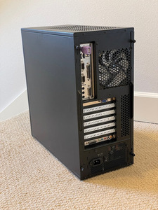

Anyways, here are some pictures of how it turned out:

Reply 1 of 46, by Joseph_Joestar
Nice work! You got yourself an extremely versatile and capable machine. The fact that your 430TX board is stable at 83 MHz is a bit surprising though. I figured K6-3+ CPUs would use a 66 MHz FSB and a higher multiplier under those circumstances. But maybe Asus boards were just that good back in the day.
Be sure to get some decent cooling for the Voodoo3. Those cards can get quite hot even without any overclocking, especially the PCI versions. I would recommend placing a PCI fan bracket with one or two 90 mm Noctua fans below it.
It's been a while since I tried Tomb Raider on my Voodoo3, but I remember it running well enough. The main thing that bothered me was Lara's missing shadow which is useful when she needs to drop down from a high ledge as it helps you determine her exact landing spot. Also, the gamma settings were a bit weird.
There are some early Glide games which won't run correctly on a Voodoo3 though. This thread might be useful: Re: Voodoo 2 DOS Glide compability matrix

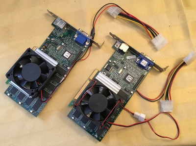

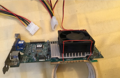

I also add a fan to my Voodoo 3. ( 60mm x 60mm x 20mm fan )
Which I tied on with thin wire I got at the Dollar store. I used wire because
This was the safest way to attach the fan with out damaging or modifying the card and it works great.
I greatly recommend you add a fan as these video cards run very hot.
And this is the main reason why these Voodoo cards fail is because they over heat and
Soldering joints break and Capacitors begin to leak and damage the PCB traces.
Its all because of overheating.

One of my boxes is similar, please let me couple of comments:
  • +1 for adding forced cooling of a Voodo3 PCI. After some uptime they really become unstable or start displaying artifacts w/o any overclocking. And it would be a pity to damage such card keeping in mind their current prises.
  • ASUS 430TX boards easily work at 83MHz bus and in fact support up to 384Mb RAM (though it's undocumented). You can replace one of your DIMMs with a two-sided 256MB module if you wish (modules with the chips on one side won't work). If it won't be recognized - just switch places of the RAM sticks.
Reply 5 of 46, by bloodem

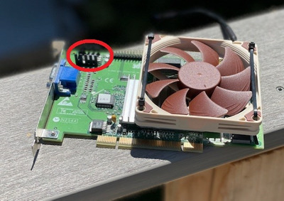

And Voodoo 3 PCI is a very different kind of animal when compared to the AGP versions because of that 3.3V voltage regulator, which gets INSANELY hot.
Some years ago, this VRM went up in smoke on one of my cards (it actually melted that part of the PCB), even though I had a 60mm fan running on the graphics chip heatsink (so there was a bit of air circulation around the regulator).
So now I'm going with the same solution that Joseph_Joestar recommended: PCI fan bracket with two big fans right next to the Voodoo 3 PCI card + an additional GPU VRAM heatsink on the VRM.

Yeah, my Voodoo3 seemed to get really hot, but this Noctua NF-A9x14 slim case fan I have zip-tied to it is working well so far. I'll probably also add a 120mm Noctua fan on the side of the case to suck air from outside the case, but the current solution is working great so far. Temps are low even though I've always had this card clocked at 183MHz (without issue).

Reply 10 of 46, by bloodem
speeddemon wrote on 2021-07-29, 18:08:
I think you misunderstood, I'm talking about the VRM (see the attached photo). In your case, the fan mostly takes care of the chip / memory. Even though there is some airflow going to the VRM, that little sucker probably still gets extremely hot (I suggest measuring the temps with an IR gun). In a closed case and depending on the room temperature, it can easily reach 80 - 90C after 30 minutes - 1 hour.
2 x PLCC-68 / 4 x PGA132 / 5 x Skt 3 / 1 x Skt 4 / 9 x Skt 7 / 12 x SS7 / 1 x Skt 8 / 14 x Slot 1 / 6 x Slot A
Current PC: Ryzen 7 9800X3D
Backup: Ryzen 7 5800X3D
Reply 11 of 46, by speeddemon
bloodem wrote on 2021-07-29, 18:19:
Thanks for explaining! Do you think a side case fan blowing on that VRM will help enough?

Reply 12 of 46, by bloodem
speeddemon wrote on 2021-07-29, 18:21:
You're welcome! It depends on multiple factors. It might be, however if you can find a VRAM heatsink that fits on top of the pre-existing heatsink (something similar to this) it would be even better - you'd be looking at 50C at most.
