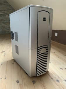

The Dream - with a big, nice AMD Athlon Badge
156.1 KiB
1857 views

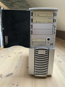

The Drive bays
197.77 KiB
1857 views

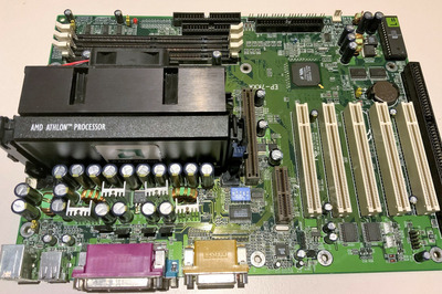

The base is a SlotA system with a completely renewed Epox 7KXA (VIA KX133), an Athlon 950MHz (Orion), and 512MB PC133 CL2 RAM. With a Voodoo 5 5500 as well as a Matrox m3D 3D APIs: Glide, PowerVR, OpenGL and Direct3D are served. My goal is gaming at resolutions of 1024x768, if possible at 32bit. The V5 is already mostly the limiting factor here, so the CPU is more than sufficient and harmonizes well with this graphics card.

Epox 7KXA Rev 0.3 with fresh Panasonic capacitors
795.12 KiB
1857 views

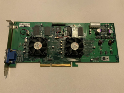

3Dfx Voodoo 5 5500 AGP
232.78 KiB
1846 views

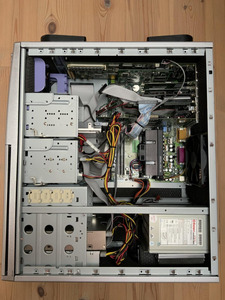

Housing inside - all slots populated
255.09 KiB
1857 views
  • Case: Chieftec Dragon CS601 silver
  • Mainboard: Epox 7KXA Rev. 0.3 Slot A
  • CPU: AMD Athlon 950MHz Slot A @1.7V (fresh MX5 thermal paste on die and 1mm silicone pads on caches)
  • RAM: 512MB PC133 CL2 (Infineon)
  • Graphics card: 3Dfx Voodoo 5 5500 for Glide / OpenGL / Direct3D (AGP 2x)
  • 3D card: Matrox m3D for PowerVR
  • SCSI controller: Adaptec 29160N
  • Hard disk: Seagate Cheetah 15k ST318453LW
  • DVD-ROM: Toshiba SD-M1201 (SCSI)
  • CD-R: PX-R412Ci (12x/4x SCSI, Caddy)
  • IOMEGA Jaz 1GB (SCSI)
  • Sound card 1: SB Live! CT4620
  • Soundcard 2: SB AWE32 CT3900 + Yamaha DB50XG (MIDI and XG sound for e.g. Final Fantasy VII and VIII)
  • Intel 21143 100MBit PCI
  • Floppy: 3,5" Samsung
  • Power supply: Enermax EG365AX-VE (32A @3,3/5V; 25A @12V; 1A @-5/-12V)

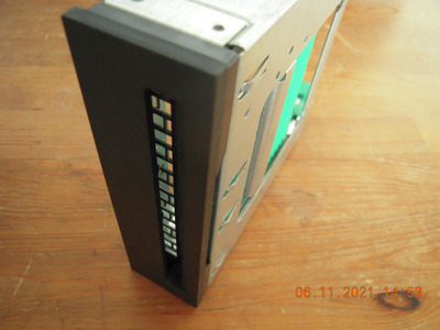

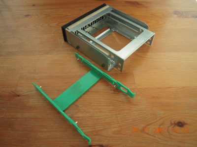

But, these drives run very hot and require fan cooling to last long time. This is explicitly emphasized in the Seagate manuals.
I'd suggest to use a workstation cage with good airflow like the HP one which I attached.

Reply 7 of 7, by PC-Engineer
Your suggestions are good. The facts have also gone through my mind during the planning.
I actually chose the 29160N quite deliberately. On the one hand, the U160 performance is fully sufficient and on the other hand, it was important to me that the internal narrow bus side is also connected to the external connector, since I still have external narrow drives and want to use them. With the other controllers, where the external connector is mostly connected to the internal LVD wide bus withe the HDD, it would also force the HDD into SE mode when using the external connector with SE drives. And good and clean terminated external wide to narrow adapters are really expensive.
The HDD is also deliberately chosen. It is the smallest and thus coolest, quietest and longest-lived disk of its series and with a capacity of 18GB completely sufficient for Win98. The Chieftec Dragon has of course a HDD ventilation for the drive cage. The disk thus stays around 30 °C surface at 23 °C room temperature during operation. That should be enough.
The HDD has a 68pin connector! That was important to me, because I didn't want to use an adapter from 80pin (looks stupid and they loosen easily) . Very important, I got it NOS. It has fresh bearings and is really quiet.
