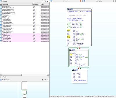

Reply 67 of 106, by AlexZ
VDNKh wrote on 2022-08-21, 19:51:
I've compared Joseph_Joestar's working example registry dumps with mine and they are being configured correctly. I went over every register and compared it with Intel's AGP 3.0 documentation, and VIA's chipset documentation, and everything on my chipset is being configured correctly by the AGP driver. VIA's 98/ME AGP driver, VIAGART.sys, I've confirmed has debugging symbols. I have a USB-DB9 cable and I plan to try and run a kernal debugger to see what's going on under 98's hood. Lately, I haven't had the free time to do this though.
Spoiler
That looks very good. I would basically set a debug point in every function and see what gets called when 3D Mark 2001 tries to detect AGP memory size. That 0 has to come from somewhere. It would be hopeless without debugging symbols. Fixing this problem will very likely require a driver patch, even if it means a hack. It could be something as trivial as that AGPEnable function simply failing and cascading to all issues we experience.

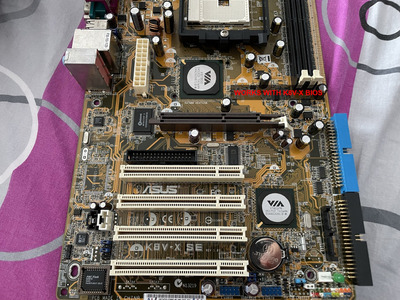

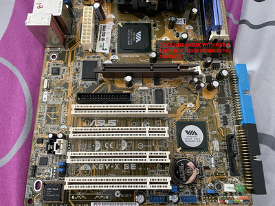

I've thoroughly investigated this problem in the past and I can say at least two things with a fair degree of certainty:
- the issue is without a doubt related to the BIOS, but it's NOT related to normal BIOS settings that one can find in the CMOS setup (whatever it is, it's something more low level). It might be related to other hidden chipset registers, but I have my doubts - it seems to go deeper than that.
- the problem was introduced sometime in early to mid 2005 (I have yet to see a motherboard with a BIOS from 2004 that has this problem), and it's not specific to only one vendor, so I suspect that it's a code block that originates from VIA itself)
Unfortunately, some newer motherboards (such as the Asus K8V-X SE) exhibit this problem with all official BIOS versions (since even the earliest BIOS revision is from mid 2005).
My "solution" in this case was to simply try BIOS versions from earlier (similar) motherboards that do have 2004 BIOS revisions (the Asus K8V-X, in this case) and this actually worked surprisingly well.
Now, here comes the kicker: I have (what appeared to be) two identical K8V-X SE motherboards - same revision and all. However, only one of them worked with the old K8V-X BIOS versions, the other failed to POST after the BIOS update (froze at a memory related post code). So I took off the north bridge heatsinks, and lo and behold, even though both motherboards look identical, their north bridges certainly are not (the North bridge with the round, grey metalic area appears to be a newer revision).
Funnily enough, the one that failed to work with the vanilla K8V-X BIOS, did work just fine with the... (drum roll)... Asus A8V BIOS (which is actually a very different socket 939 motherboard that has the VIA K8T800 PRO chipset). The only issues I could see was a warning message during POST that the "BIOS is not valid for this motherboard", and incorrect/broken readings from the temperature/voltage sensors in the BIOS itself (in Windows they are read correctly by software such as AIDA64). Other than that, the board worked perfectly during many days of testing (and, of course, the Win98 performance issues were gone).
WARNING: don't try this at home, unless you understand the risks (including the fact that you will most likely need an external BIOS flasher, since things will certainly go wrong during the trial and error phase).

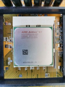

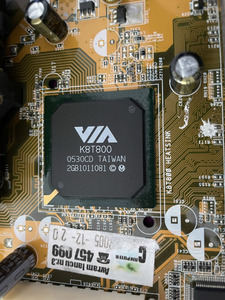

Reply 71 of 106, by AlexZ
My MSI K8T-Neo V has yet another revision:
K8T800
0534CD
2GB1014731
Pentium III 900E, ECS P6BXT-A+, 384MB RAM, NVIDIA GeForce FX 5600 128MB, Voodoo 2 12MB, 80GB HDD, Yamaha SM718 ISA, 19" AOC 9GlrA
Athlon 64 3400+, MSI K8T Neo V, 1GB RAM, NVIDIA GeForce 7600GT 512MB, 250GB HDD, Sound Blaster Audigy 2 ZS
Reply 72 of 106, by Joseph_Joestar
AlexZ wrote on 2022-08-22, 16:45:
0534CD
I think this is probably the date code. Meaning, year 2005 week 34. No idea what the CD is though. Maybe the name of the factory?
On the other hand, the chip with the silver circle that @bloodem posted has a date code of 0453 meaning year 2004 week 53. This seems to fit as 2004 was one of those less common years which actually have 53 weeks, instead of the usual 52.
Reply 73 of 106, by bloodem
Joseph_Joestar wrote on 2022-08-22, 17:10:
Now that you mention it, it does make sense. This means that the north bridge with the round/grey metallic area is actually manufactured earlier (and this is probably the reason why it does work with the BIOS from the older K8V-X motherboard).
Another thing that I found interesting: even though I've flashed the "Asus K8V-X version 1006 BIOS" (from December 22nd, 2004) on this K8V-X SE motherboard (the one with the 0453 date code on the north bridge), Athlon 64 "Venice" CPUs do work perfectly fine - although Asus mentions that they should only be supported by the latest ver 1012 BIOS (obviously, since Venice CPUs were not yet available in late 2004).
And this is great, since I do prefer to use Venice CPUs (unless going for a very period correct build), because these run much cooler than the earlier 130 nm models (ClawHammer/Newcastle).

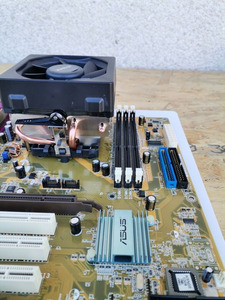

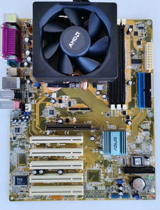

Reply 74 of 106, by stef80
Just a hint ... Venices (and s754 in general) work great with modern AMD Wraith coolers. AM3+ version with no bling in pics.

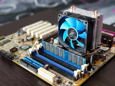

Reply 75 of 106, by bloodem
stef80 wrote on 2022-08-23, 06:55:
I think all modern AM4 (AM5) coolers work fine for socket 754/939.
My personal favorite are the Deepcool GAMMAXX 300 and its little brother: Deepcool Iceedge Mini FS v2.0 (pictured below).
These are cheap, dead silent and keep the CPU nice and cool, even when overclocking.
