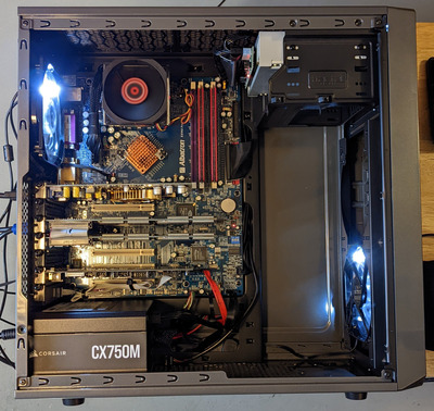

A few weeks ago, I was going through my stash of old parts and came across my favorite old motherboard from ~2004. Since my beard is getting more grey, I can't remember as much about hardware nuances like I used to. Google lead me to Vogons... and all I have to say is this place is awesome. What a great forum for old hardware! Anyways on to my build and the decisions I need help making.
The Albatron KX18D Pro II was a late socket A board that flew under the radar because it wasn't made by one of the major brands. It reviewed really well at the time and I was a big fan of AMD back then so it became the third socket A system I owned. I loved it but once Athlon 64 came out, the 3400+ I upgraded to blew my 2400+ out of the water. The motherboard, CPU and video card were put in the closet and forgotten about until now. I originally ran it on Windows XP with a Thoroughbred 2400+ and a 6800 GT. I believe I used a Promise Fasttrak PCI controller at the time and the onboard "Soundstorm" sound too.
Updated 7-8-22 - Build:
AMD Athlon XP Barton 2500+ @ 2.3ghz/210mhz FSB
Thermaltake Volcano 12 HSF - Noctua NF-R8 redux-1800
Patriot 2x 1024mb PC3200 @ 2.5-3-2-5
Visiontek Radeon X1950 Pro AGP 256mb
3Dfx branded Voodoo II 3.0 12mb 22ns EDO in SLI
Intel Pro 1000 GT NIC
Creative Audigy 2ZS OEM - Daniel K Driver
Windows XP SP3
Corsair CM750M
Seagate Momentus XT Hybrid 500gb 7200rpm SATA on Sil3112A
Sony CRX320EE DVD-ROM - IDE & CDA
Samsung SH-S183L DVD-RAM - SATA to IDE
Fractal Designs Focus G Case
Hyundai B90A 19" LCD 1280x1024

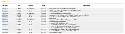

Looks like a decent board to base your build on - FYI you can still access it's old product web page at https://web.archive.org/web/20060105042438/ht … w.asp?pro_id=69 and if you're looking for the latest BIOS perhaps, you can find them here https://www.elhvb.com/supportbios.info/archiv … roII/index.html
142.87 KiB
1748 views
Also, you might like to contribute to the Ultimate Retro database project - https://www.ultimateretro.net/en/ - as they don't seem to have your board listed. See this thread for details - The Retro Web submissions thread: suggest edits and/or add new boards here

Reply 5 of 20, by ptr1ck
I've got it built!.. and realized this thread should probably be in System Specs instead of General Old Hardware...
My Audigy 2 ZS seems to be dead so until it's replacement arrives, I am using the onboard Soundstorm audio.

Your build is surprisingly devoid of cable mess 😜

I love that I was able to do that with this build. PATA cables are a bit tricky. 😀

Reply 10 of 20, by ptr1ck
chrismeyer6 wrote on 2022-03-08, 21:55:
Great looking Socket A system!!
You didn't seriously great job keeping the cables really clean looking. I like the selection of parts you used
Thank you! I'm happy with the result.
My HD Audio cable is dangling there until my adapter arrives. I plan to tidy it up a bit more once it's 100%.
