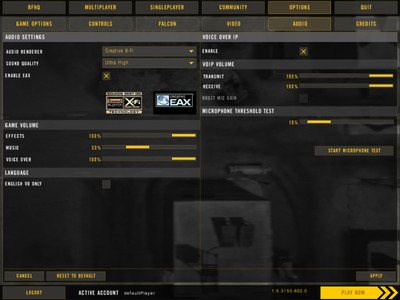

Reply 46 of 66, by Joseph_Joestar
Almoststew1990 wrote on 2023-05-09, 15:16:
The x-fi doesn't seem to support x-fi mode in Battlefield 2 despite it being a showcase game for the card I think? It still supports hardware audio and EAX sound on the High settings just not x-fi mode and ultra high.
Ultra High works fine on my X-Fi Titanium Fatal1ty PCIe. Is your game fully patched to 1.50?

Reply 49 of 66, by Joseph_Joestar
Almoststew1990 wrote on 2023-05-09, 17:34:
Yeah the game is patched to 1.41 and then onto 1.50 and I am using the latest drivers for the x-fi (which might be the problem)
I recently reverted to an older driver version from 2010 because newer drivers had some issues with OpenAL in OldUnreal. I downloaded that driver from Creative's website, think it was version 2.17.0008.
In any case, Battlefield 2 works fine for me with that older driver version.
