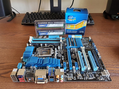

Reply 31 of 68, by Shponglefan
Upgraded my 'Ultimate' Windows XP build.
Previously I was using an Asus P5Q-E motherboard, E8600 CPU and 2x2GB DDR2 RAM.
Upgraded to:
  • Asus P8Z68-V Pro/Gen 3 motherboard
  • i7-3770k CPU
  • 2x2GB DDR3 RAM
Previous average FPS w/ the E8600 in F.E.A.R. and Crysis was:
FEAR perf. test: 39 FPS
Crysis CPU bench: 57.7 FPS
Crysis GPU bench: 62.9 FPS
New average FPS with the i7-3770k are:
FEAR perf. test: 74 FPS
Crysis CPU bench: 114.0 FPS
Crysis GPU bench: 106.0 FPS
* All tests run @ 1920x1200 resolution, max settings.
Pentium 4 Multi-OS Build
486 DX-33 with 5 sound cards
