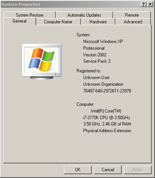

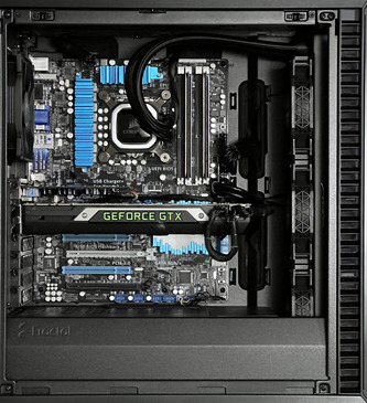

The build started for me with the following goals:
- Focus on primarily Windows XP era games that utilize EAX and that don't run on Windows 10 anymore.
- Primarily use parts I already have in my collection. The only part I needed to buy was the Sound Blaster X-Fi since my existing X-Fi Titanium HD card wasn't compatible with Windows XP and it's nice being able to keep that card in my Windows 10 build.
- Keep the build as small as possible.
- Use my TITAN X since it's the fastest card I have that works with Nvidia's last Windows XP driver.
- I wanted to use drivers that were built for Windows XP originally without needing to install modified drivers and I wanted drivers to be available for all components. For this reason, I stuck with a motherboard that had native XP drivers available. I may consider modifying drivers and swapping in my Titan X later though, but performance is far more than necessary so far with the GTX 960.
- I wanted as modern of a chipset as possible without needing to stray from enthusiast class gear. I know there were some later chipsets geared toward business/industrial use that have XP drivers, but I really wanted an Intel Z-series chipset and ideally an Asus board.
Here's what I ended up assembling:
- Asus P8Z77-V Pro/Thunderbolt (LGA 1155 Intel Z77)
- Core i7-3770K 3.9GHz (Ivy Bridge - Overclocked to 4.4GHz)
- 4GB DDR3 1600 RAM (2x2GB Crucial BL25664BN1608.Z16F63)
- Nvidia GeForce GTX TITAN X
- Sound Blaster X-Fi (SB0880)
- 250GB Samsung 850 Evo SATA SSD
- Fractal Define 7 Compact Case
- Corsair H150i 360mm AiO CPU Cooler
- 750 Watt PSU (Corsair RM750x)
- LaCie electron22blueIV CRT
Yes, it can run Crysis!
Enjoy and let me know what you think!

I wanted to build this as an ITX system (small as possible goal 😉), but I couldn't figure out a way to have a GPU and Sound Card in an ITX system. Are you skipping a Sound Card in your build?
With that said, I'm actually pretty happy with how small this build turned out given the full-size ATX board. The Fractal Define 7 Compact case truly is compact for what you can fit in it.

It's a very clean system, and i see your approach of building a WinXP system as fast as possible.
But for me, there is a missing point. -> an optical drive.
Since i have lots of games with CDs and DVDs, my WinXP assemblies need definitely a drive.
Because your focus is the modern case with AIO you have to take an external drive or copy all the files to the drive.
The option for copying files looks also not as an complete solution to me. Reason: there are also CDs and DVDs with light or heavy copy protections...
Therefore... to me the abandonment of drive is more related to the era of streaming.
