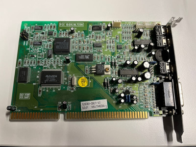

Thank you for your condolences and kind offer as well, but it turns out a coworker had an old card stashed away and they offered it to me for free:
113.8 KiB
298 views
Media Vision Jazz 16
I had never even heard of this card, but I can say after a day's worth of testing that it seems like a solid sleeper and clone. Windows 95 actually detects and configures it automatically, no extra steps or drivers required! The card is identified as a Media Vision Jazz 16 (SoundBlaster / SoundBlaster Pro-compatible).
The software was straight-forward and easy to set up for DOS too. The FM synth is pleasing and to my ears nearly identical to an actual Sound Blaster (I know some of the more HC crowd here will probably say they sound nothing alike). No advanced features such as IDE- or daughter-board connections, but for basic DOS-gaming use this card seems to be completely fine, even if it doesn't stand above its peers in any way. The volume rocker in the back makes it easier to set the volume levels in DOS than using software, or if old-school passive computer speakers are plugged in.
