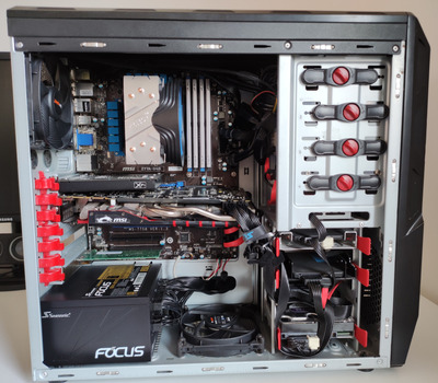

I bought this PC back in 2013 and mainly used it for work, hence the 16GB RAM. For a long time it served as my main system, and was running Win7 all the way up to 2020 when the extended support period ended. Honestly, I didn't even realize that the motherboard had official WinXP drivers until that time, which is when I decided to turn it into a retro rig. Now, the main purpose of this build is to play 2002-2009 WinXP games at the 1600x1200 resolution using the best possible video and audio settings.
CPU
This Core i5 3570K CPU is more than enough for most WinXP games that I intend to play on this rig. The only downside is that I have to force CPU affinity to a single core for a few titles which have problems otherwise. I've replaced the stock cooler with an aftermarket one and also added three case fans. This keeps temperatures below 50C, even under full load.
Motherboard
This MSI board is based on Intel's Z77 chipset and works fine for my needs. Its WinXP drivers are stll hosted on the manufacturer's website and stability has been very good. I also like that it has a few PCI slots, in case I decide to put some older hardware in this rig at some point.
Graphics card

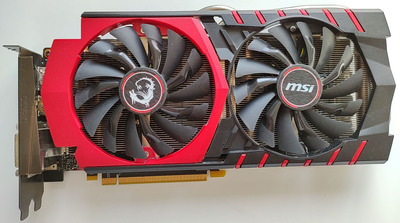

This Asus Strix GeForce GTX 980 Ti fits my needs perfectly, since I play WinXP games at the 1600x1200 resolution 95% of the time. In most cases, Anti Aliasing and Anisotropic Filtering can be cranked up as desired, and the GTX 980 Ti generally handles that with ease. Games that support PhysX also run really well, even with all settings maxed. I really like the cooling solution on this card, since it's barely audible until the card enters full load, and that rarely happens while running WinXP era games. Since the GTX 980 Ti isn't officially supported under WinXP, I had to modify the drivers as instructed here. The procedure was very simple, and it worked like a charm. I'm using 355.98 drivers since I had the best experience with that version in terms of game compatibility and GPU performance.
Sound Card

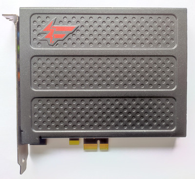

I recently got this X-Fi Titanium Fatal1ty Pro PCIe. I had the OEM version of that card before, but the Fatal1ty branded one comes with 64MB X-RAM, if that even matters in this day and age. Supposedly, that can improve performance in some games like Unreal Tournament 2004, but I doubt it will make much difference on this system. The main reason I'm using this card is because of its excellent EAX capabilities, since many WinXP games support EAX in some form. On that note, Thief: Deadly Shadows,Quake 4 and Splinter Cell: Chaos Theory are true EAX showpieces in my book. For anyone with an X-Fi card, I can highly recommend trying those games and experiencing their masterful sound design. Lastly, I put together a guide for setting up this card and using the optimal drivers for EAX and OpenAL gaming under WinXP.
Operating Systems
I keep each of my three operating systems on a separate drive, so that they don't mess with each other. WinXP is used for gaming of course, Win7 for maintenance purposes and Linux Mint for downloading GOG offline game installers from the internet which are then stored on the 4TB mechanical HDD for easy access from WinXP. Linux is also useful for manually performing the TRIM operation on the WinXP SSD via the fstrim command. Lastly, Windows 10 LTSC 21H2 is mainly installed so that I can continue accessing my Steam library, after they dropped support for Win7.
Conclusion
I'm fairly satisfied with this system as it plays WinXP games up to (and including) 2009 quite well. I figured, since that's the year when Win7 came out, it should be a good cutoff point for XP gaming. In fact, this system can play some Win7 games from the early 2010s fully maxed out at 1080p, which is a nice bonus.
The attachment GTX980Ti.jpg is no longer available
The attachment X-Fi.jpg is no longer available
The attachment Case_Interior.jpg is no longer available

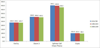

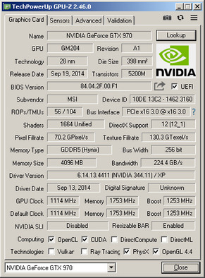

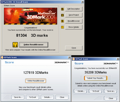

A couple of benchmarks:
The attachment CPU-Z.jpg is no longer available
The attachment 3DMark_980Ti.jpg is no longer available
The attachment GPU-Z._980Ti.png is no longer available
The attachment Bench_980Ti.jpg is no longer available
For the 3DMark tests, the default benchmarks were used. For the game benchmarks, the following versions were used:
  • FarCry v1.4 benchmarked using the "HardwareOC FarCry Benchmark" at the "Ultra Detail" preset
  • Doom 3 v1.31 benchmarked at the "Ultra Quality" preset using the built-in "timedemo demo1 usecache" console command
  • Splinter Cell Chaos Theory v1.05 benchmarked using the stock "Timedemo.bat" file. VSync and Anti Aliasing are turned off, all other settings have been fully maxed out
  • Crysis (GOG version) benchmarked using the stock "Benchmark_GPU.bat" file at the "High" graphical settings

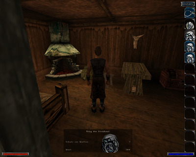

And since I got asked about older games on this machine, here's a screenshot of the Gothic 1 issue that I mentioned before. This is how the inventory looks like on my GTX 650Ti:

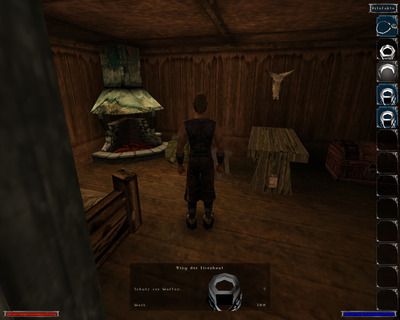

And here's how it's supposed to look, as displayed by my GeForce4 Ti4200:
The attachment Gothic_GeForce4.jpg is no longer available
There doesn't seem to be a simple fix for this issue, other than using mods. But I prefer to play my games stock, which is why I now have four retro rigs. 😀

A couple of tips. With the X-Fi line, note that Titanium HD and later cards don't support WinXP and are therefore unsuitable for retro gaming. Also, avoid the Xtreme Audio X-Fi varieties since they don't have hardware accelerated EAX. For similar reasons, ignore the LE, SE and other cut down "value" editions of Audigy cards. In terms of drivers, just grab the latest ones from DanielK's website and you're all set.

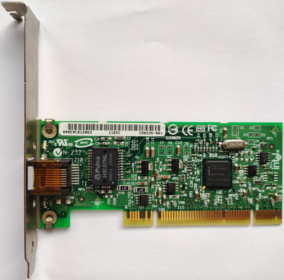

I've added an Intel Pro/1000 GT PCI network card to this build. It will serve exclusively to connect this system to my retro LAN, as I want to keep that completely cut off from the internet. The on-board NIC will still be used for internet access (only from Debian Linux).
Basically, this just makes it a bit easier for me to transfer GOG offline game installers to my other retro systems.
Are those even working on your older OSs? I've tried a few offline GOG installs on my Win98 and WinXP computers and all the ones I've tried won't even install on anything older than Win7. Even the old-old stuff like Descent.
Reply 18 of 145, by Joseph_Joestar
Jaron wrote on 2023-02-01, 15:30:
I guess it might depend on the game and when its installer was last updated. Here are some games that worked fine for me using their offline installers on WinXP + SP3: Prince of Persia: Sands of Time, Gothic, Gothic 2, Jazz Jackrabbit 2, Thief: Deadly Shadows etc.
I don't think any of the GOG offline installers can run on Win98, but you can always install a game on WinXP (or a modern system) and then copy over the installation folder to your Win98 rig. Most of the time, this works without any issues, but sometimes you do need to delete Glide wrappers and such if you're running the games on real, period-correct hardware.

Updated my benchmarks to include the 1600x1200 results. I have to say, most WinXP games do actually have enough texture detail to justify this resolution (and higher ones). This is in stark contrast to Win9x games, because they often only used low-res textures (256x256 and such). Of course, that makes perfect sense considering the hardware of that time period. But it's still a bit jarring to see blurry textures paired with ultra-crisp polygons when you crank up the resolution in some Win9x games like Quake 2.
Anyway, I can see why 1600x1200 remained popular well into the late 2000s under WinXP. I never experienced it back in the day, since the monitor and GPU which I was using at that time couldn't handle it. Now, it's a real treat to finally play games like Doom 3 and Far Cry at that resolution.
