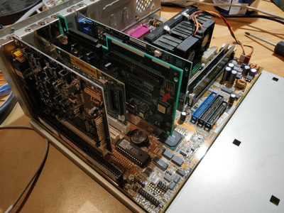

I have one machine that is pretty much the optimal end of 1999-build.
AMD Athlon 650
Asus K7M, AMD 750 chipset
256mb sdram
Matrox G400 Max, 32mb
SB Live
3Com 905B
Adaptec 2940 scsi-card (to be replaced)
2x36gb 10krpm scsi harddrives
CD and CD-RW
Everything is stuffed into an Addtronics 7890a, one of the best cases ever made (after you replace all the 80mm fans with 120mm).
506.02 KiB
1412 views
Setting up the motherboard and inserting all the cards.. still room for Voodoo2 in the future.

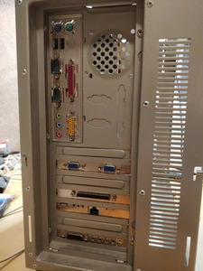

310.03 KiB
1412 views
Backside!

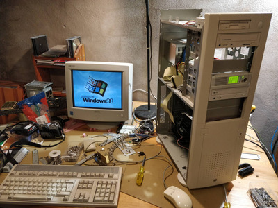

514.96 KiB
1412 views
Testing testing, Windows 98 installed!

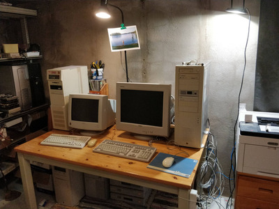

453.16 KiB
1412 views
Retrodesk nr2 ready for being used 😀
