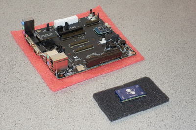

I got the boards delivered today! Now begins the process of:
- unpacking and freeing the boards from their smt assembly support rails
- soldering the sound card chip
- soldering the wifi-modem (for those who wanted that)
- soldering the ps/2 connector
- programming the attiny and rp2040 chips
- soldering the yamaha chips to the opl3 modules
- connecting all peripherals to each and every board and do a proper round of testing
- cleaning
- packaging
- shipping
I'll do my best to be quick about this, but don't expect miracles as I have three kids and a full time job... 😉
Will contact everyone who's made a purchase with the tracking number once your package is sent!

It looks like Llamas have started appearing out in the wild:
Got the Vortex86EX from DMP shop just over a week ago. Conveniently I live in the same neighbourhood, so I was able to pick up the ITX-Llama in person earlier today 😀

I've started shipping out cards, but unfortunately I've been tied up with work and personal stuff way more than anticipated.
For everyone who's been waiting patiently, please bear with me - your card is coming, just takes a little while longer! 😀

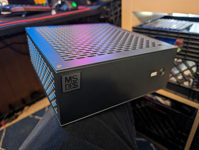

Assembly partially completed. Left my multimeter at work during the holidays. Scared to power anything on until I test this aliexpress power supply. The case also patches the 120 volts to it and I'm worried I wired it backwards.

Nice, waiting for my case, need to try to make a io plate also if no one has made one 😀

fluxrez wrote on 2024-01-01, 01:14:Assembly partially completed. Left my multimeter at work during the holidays. Scared to power anything on until I test this aliexpress power supply. The case also patches the 120 volts to it and I'm worried I wired it backwards.
Did you manage to test the PSU and power on the board? 😀
Eivind wrote on 2024-01-04, 21:37:Did you manage to test the PSU and power on the board? 😀
Not yet. This weekend probably. I did lookup diagrams on a PC power plug and the ATX power supply voltages. I'll test every little bit before I plug anything in. And I know there will be no replacements!
