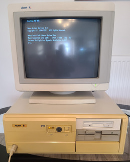

Hi,
Just to show my 286 PC 😀
Monster !!
12MHz with step down to 8MHz
1MB RAM increased from 640kB
170MB HDD
Graphics card..... something with 256kB ram but will try to extend it to 512kB.
Nice old machine. The guy who I bought it from said he bought it from the company he worked for, years ago when they were replacing all computers and it was used for CAD 🤣 !
Enjoy the photos.

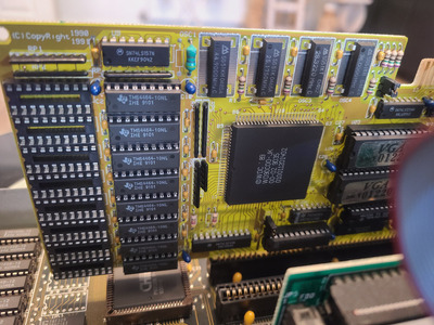

12MHz with step down to 8MHz 1MB RAM increased from 640kB 170MB HDD Graphics card..... something with 256kB ram but will try to […]
170MB HDD
The main memory is more in need, maybe.
If the 286 mainboard uses Shadow memory, a humble Megabyte won't be sufficient for Extended Memory anymore.
It's then either Shadow Memory or Extended Memory.
That's one of the reasons why I have an aversion against 1 MB setups.
That being said, it's your PC, of course. You have the last say how to configure it, and that's fine. Each to his own. 🙂👍
Anyway, 512KB of VGA memory is no waste. Picture viewers and programs like Geoworks Ensemble 2.o (and up) can use SVGA and VBE.
For VBE, a DOS-based TSR might be needed.
And the correct DIP switch settings on the VGA card.

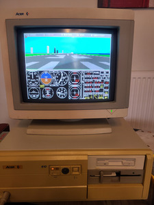

Robx66 wrote on 2023-04-05, 04:23:
Sure, I've ran AutoSketch 2 on an 286/12 in the past.
The diskettes included an x87 version of the software, too.
This AT clone is more than capable fot this task.
Add another 2MB of RAM and it can run AutoSketch for Windows 1.x, even.

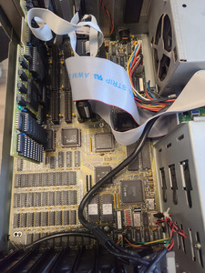

Reply 2 of 12, by Robx66
Jo22 wrote on 2023-04-05, 05:41:
The main memory is more in need, maybe. If the 286 mainboard uses Shadow memory, a humble Megabyte won't be sufficient for Exte […]
I wish I could add more RAM but that's maximum this motherboard can take without desoldering dram and sockets and then solder new sockets for 511000 dram unfortunately.

One strange thing I noticed. Although the components on the motherboard indicate it was built towards the end of 1988, the graphics card seems to be from early 1991. So either Acer was still selling these in 1991, or somebody just upgraded the VGA...but it has an Acer VGA display. If upgrading from EGA to VGA, most people would have bought a 3rd party monitor...though I guess it's not impossible the owner just liked Acer.
Reply 5 of 12, by Jo22
Anonymous Coward wrote on 2023-04-05, 08:47:
Hm. Good point. My guess is that a PVGA1A was originally installed (has date code from '88 AFAIK) and that the WD90C00 was a later model meant as drop-in replacement.
To my understanding, it's possible that WD90C00 and PVGA1A (maybe also PVGA1B/PVGA1C are quite similar in design.
It's just an assumption, of course, speaking under correction.
Paradise used to be a company/trademark of Western Digital, years before the WD90C00 was released.
The only notable visual difference is that the PVGA1A was housed in a huge SMD IC,
while the newer WD90C00 is roughly in the size of a 386SX chip.
So maybe it was being made using more advanced lithography. 🤷‍♂️

Reply 7 of 12, by Robx66
You might be right but also I know this model was in different hardware variations made by acer. I have dig out original Acer brochure with prices and pc configurations and they were a bit different to the one I've got. Not sure if can find it again. I have some original manuals for this pc including graphics card. The graphics card is called Sigma VGA.....
1.98 MiB
925 views
Save vintage / retro computers from ending up in the bin. Keep them in working condition. It's a great history !
Reply 8 of 12, by Anonymous Coward
I am pretty sure the Sigma VGA is not what is installed presently. Maybe the manual mentions what kind of chip it uses. It's probably C&T or Tseng based.
The replacement WDC that's in there is a good match for this computer, so I'd probably just leave it alone. Either the original had some kind of incompatibility issue or it failed.
Reply 9 of 12, by Jo22
I second this.
The Sigma card could be a Sigma VGA/H, based on a Tseng ET-3000AX.
That's at least what I think, because the picture on the manual has similarity with this card:
