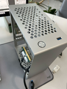

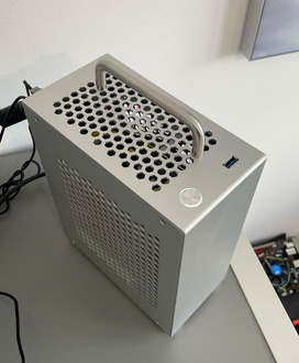

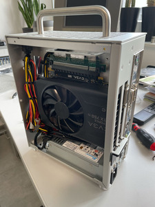

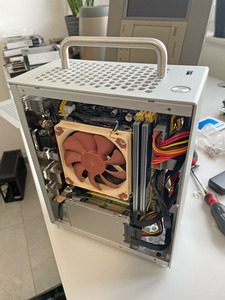

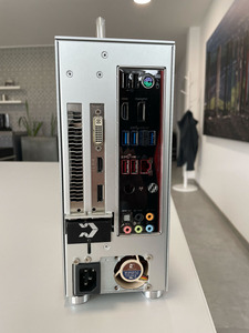

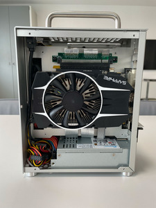

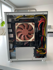

I would like to present my current project:
It goes by the name "Nanobox" and is a Haswell-based mini-ITX computer in a stylish, minimalist aluminum housing.
The aim is to have a small, quiet and energy-efficient Windows XP computer for more demanding games and to run Linux as a second OS.
The little one will then stand on the desk next to my monitor and joins my main computer as a retro station using the same screen, keyboard/mouse + sound.
The PC is currently under construction, as I am still waiting for the power supply.
But I thought I'd upload a few photos/impressions in advance.
Here are the specs:
Motherboard: Asus H81I-PLUS[/list]
CPU: Intel Core i3-4370 Dual-Core 2x 3.8 GHz
RAM: 4GB DDR3 1600MHz
GPU: Nvidia GeForce 750 Ti
SOUND: Creative Sound Blaster X-Fi Surround 5.1 Pro (External-USB)
Seasonic SSP-300SUB 300 Watt Flex ATX Power Supply
Motherboard: Asus Z170i Pro Gaming
CPU: Intel Core i7-6700 Quad-Core 4x 3.4 GHz
RAM: 16GB DDR4 2133MHz
GPU: AMD Radeon R7 260X
