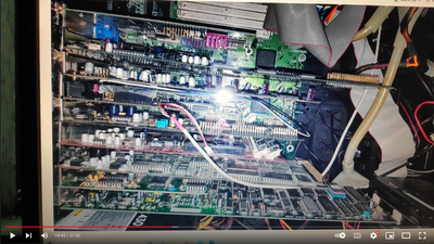

Reply 3 of 10, by AppleSauce
chinny22 wrote on 2023-05-19, 10:35:
Comes down to resources, even then you can get away with sharing IRQ's etc in some instances.
I forget the name but someone here did put in a crazy amount of cards and explained how he managed it, but it's definitely possible
I think it was carlostex iirc?
He had that crazy Sonic Ecstasy build with like 6 or 7 sound cards?
https://youtu.be/kk6nyrX4DK8?t=885
1.58 MiB
1041 views

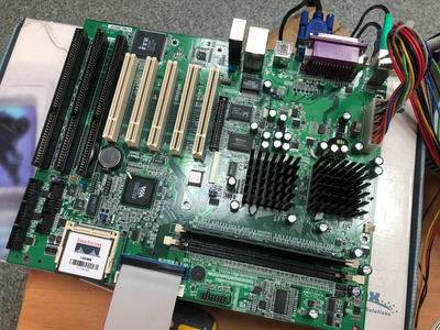

Reply 5 of 10, by Babasha
Some industrial motherboards have nice quantity of slots and IRQ/DMA control in BIOS (without controls it maybe hard to configure).
PS. My new baby for such things

Reply 10 of 10, by carlostex
AppleSauce wrote on 2023-05-19, 12:36:
I think it was carlostex iirc? He had that crazy Sonic Ecstasy build with like 6 or 7 sound cards? […]
Yep that was me.
At that time it actually had 10(ish) sound cards (devices).
From that picture starting up to bottom:
1 - Ensoniq Soundscape S2000;
2 - Roland RAP-10;
3 - Orpheus 1 + Tiido XG DB card;
4 - MediaTrix AudioTrix Pro;
5 - Ultrasound PnP;
6 - Pro Audio Spectrum (dual OPL2);
7 - Creative Game Blaster;
8 - IBM Music Feature Card;
9 - Creative CT1920 AWE Upgrade (wired around back);
10 - Tandy LPT;
I since removed the RAP-10 and replaced the XG DB with FalcoSoft + VSTi (including MUNT plugin), the Ultrasound is also out because i've been testing an Orpheus 2 prototype. It would be actually nice to condense the Game Blaster + Tandy + Innovation SSI on a single card, if not the latter at least the Game Blaster + Tandy. We have so many clones now that it would be nice to cram that all into a single FPGA. Will probably take years until that happens.
