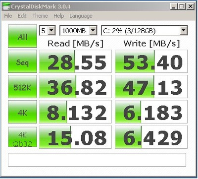

I've just been ignoring the Trim problem for now on my Win2K system. I figure I'm not doing enough big file i/o for it to be a problem on a system I'm just farting around on. Good to know a fairly easy bootable solution exists though.
As for speeds, woof:
The attachment SSD.jpg is no longer available
Mind you, I'm using quite an old Corsair 256GB SSD (partitioned for 128GB) - my first SSD actually, so hopefully that explains most of the speed difference. I'm using a Promise S150 SX4.
