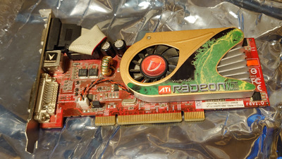

The first part to actually show up was the graphics card, a Radeon X1300 PCI. This seems about right for the era (2005-2006), wouldn't have been too expensive and has a kind of "I went to the computer store and they sold me something they promised was good for gaming, for way more than it was worth" vibe to it. And it was relatively cheap. And, hopefully, the PEX 8111 bridge on it can run on a 66MHz PCI bus so it won't suck as much. One of the constraints I'm giving myself with this build is to avoid using an AGP graphics card and instead limit myself to server-oriented boards with only PCI(-X).
You want to see the motherboard? Just a second.

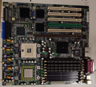

Okay, fine, here's the motherboard. A Supermicro P4DP6. I wish it was an X5DP8, which supports 533MHz FSB Gallatins, has Ultra320 SCSI and gigabit ethernet onboard, but I got a deal on the P4DP6. And I think it fits the idea of a constrained, "picked up a server that fell off the back of a truck", build. Not something done by picking perfect parts, with the benefit of 20/20 hindsight, but just picking up what was available and what you could afford. Not the perfectly tweaked 440BX-with-1.4GHz-Tualatin we're building today (okay, mine's an Apollo 133A with a 1GHz Coppermine, but it's just about perfect for me) but the Celeron on a "BXPro" we actually had.
842.15 KiB
1518 views
Unfortunately, while the seller included the board, a CPU, a generous 4GB of RAM, and two (different) coolers, they didn't include all the mounting hardware for the coolers. In fairness, that would probably include an entire server chassis, as I'm pretty sure these originally bolted through the board right into the case. So all I could do was gaze longingly at this beautiful piece of computing machinery until I could make the pilgrimage to either Orange Coloured Chain Building Store or Tire Store That Also Sells TVs And Guns.

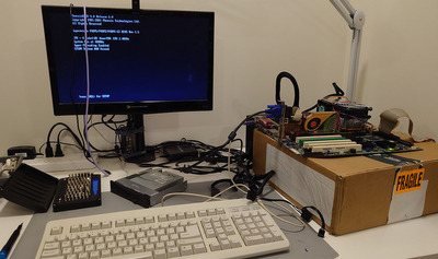

And... nothing. No POST, no beeps, not even a fan spin. Dead as a doornail.
If you look closely, you'll see that I took out all but one of the memory sticks to keep things simple for testing. This will become important later.
I read the manual. Twiddled some jumpers. Read the manual again. Confirmed that yes, that is the power switch header. Read the manual a third time. Tried clearing CMOS. Scratched my head. Dug out my power supply tester to verify that my power supply actually worked. It did. Dug out my post card, got worried it would fry the 3.3V-only PCI-X slots, put it back. Took the RAM out, put the RAM back in. Took the CPU out, put the CPU back in. Went back to the manual, found the troubleshooting steps...
The battery on your motherboard may be old. Check to verify that it still supplies ~3VDC. If it does not, replace it with a new one.
Surely this isn't one of those boards that requires a working battery even to power on, right? Only Apple ever made those, right?

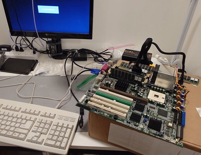

742.85 KiB
1518 views
It is indeed one of those boards that requires a working battery even to power on.
I'm actually misrepresenting things a bit with that picture, though. I was able to power the board up once I changed the battery, but it didn't actually get anywhere close to POSTing. The fans spun. The lights came on. No video. No beeps.
I take the RAM out. It beeps angrily at me. Okay, that's expected. I put the RAM back in. It stops beeping, but doesn't boot. Hold on, it doesn't need RAM installed in pairs, does it? Three guesses as to the answer, and the first two don't count. I checked the manual, cursed, put a second stick of RAM back in, and then it booted. For some reason, I misremembered the E7500 chipset as having strictly single-channel memory.
I still feel justified in blaming Supermicro for this, though. No RAM, beep like the building is on fire. Incorrect RAM, stay silent as a mouse.

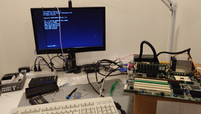

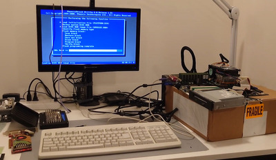

I did a little celebratory dance, then I had to run off. When I came back, I set to work installing the second CPU. Because what's the point of a dual Xeon rig without dual Xeons, amirite? I actually swapped both CPUs, because I had that matched pair. The CPU in the board was the same speed, but a different stepping. The socket looks a little smashed and I had to finagle the CPU in a bit, which was worrying. The first heatsink attached with clips, but the second one just had bolts. There was something vaguely resembling a backplate in the package, but I couldn't figure out how it was actually supposed to attach. So, nuts again it was. The spacers on the heatsink seemed too thick, the bolts too short, and I didn't think it would provide enough mounting pressure to keep the CPU from frying itself...
544.59 KiB
1518 views
...but it seems to be fine, at least at idle. That was... actually pretty easy.

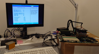

Reply 4 of 10, by XCVG
After weeks of procrastination addressing other matters of utmost importance, I finally got around to updating the BIOS. For some reason, the flash tool didn't want to run from the boot disk I created in XP, or my usual DOS boot disk, complaining about not being able to run on top of a memory manager. I ended up using an (original!) DOS 6.22 install disk. I also used the floppy drive and too-short cable I pulled out of one of the servers, because it was the closest to hand.
156.22 KiB
1342 views
A tense few minutes later and the deed was done. To be honest, I didn't really expect this to make a difference. After verifying that it at least didn't make things worse and that the system booted up on integrated graphics, I shut it off, installed the X1300, and powered it up again.
185.88 KiB
1342 views
To my great surprise, it booted right up with no complaint. I have no idea if it's running at 66MHz, I have no idea if it's stable, or even if it'll boot up reliably, but this is a lot further than I got before. For the time being, I'm calling this a success.

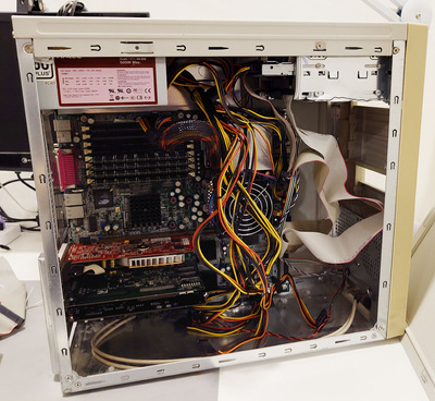

Reply 5 of 10, by XCVG

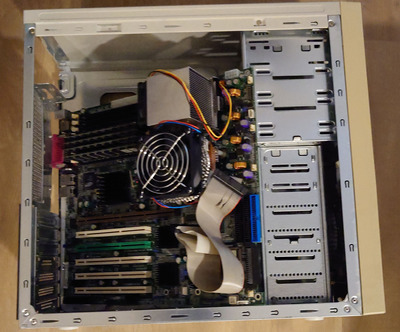

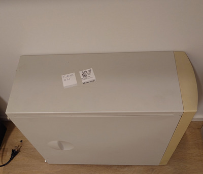

It's been a while (almost two months exactly), but I've made some progress. I have a case now!
123.62 KiB
1215 views
This beige box showed up at the thrift store one day and I snapped it up. The computer in the case was mildly interesting, had one of those oddball ECS boards with a soldered-on Duron, and surprisingly it POSTed (though the hard drive was dead). But that's a story for another day. I just needed an old case with the old style layout; power supply up top. There was no way the new motherboard was going to fit in a normal ATX case, at least with the drive cages in the way.
243.94 KiB
1215 views
So I started cutting...
185.61 KiB
1215 views
If I was smart, I would have left more of the drive cage intact, but I wasn't and I'm not. Oh well. Like I guesstimated, there was still enough left to mount the optical drive (which I think came out of a Power Mac) and floppy drive in weird 3/4 height adapter salvaged from one of the servers. The drives actually stiffen up what's left of the drive cage and it's a lot more stable than I'd thought.
I have a vague plan for mounting the hard drives. The original hard drive cage is basically two pieces of sheet metal riveted to the optical drive cage at the top and the floor of the case at the bottom. I just cut through it at the top, but I carefully (ish) drilled out the rivets on the bottom. I mean, I still bent them pretty badly getting them out, but it'll buff out. Interestingly, there's a second pair of holes in the bottom of the case to mount the drive cage about an inch over, away from the motherboard. That should give me enough clearance as long as I shorten the cage to clear the bottom CPU cooler. I was thinking of bending the top pieces over and attaching them together somehow, to make a sort of u-shaped drive cage, but I might be able to get away without that and just rely on the drives for stiffness.
394.86 KiB
1215 views

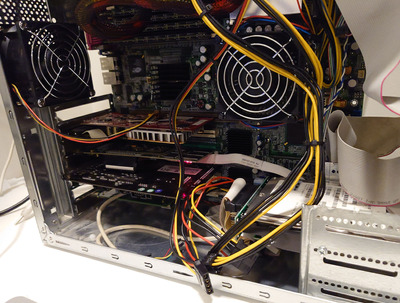

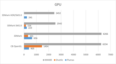

In the meantime, though, I wired up everything else and tested it out. I even threw in the cards I'm planning on using, to get them out of the way if nothing else. There's some good news and some bad news:
- It still works!
- The cards mostly play nice together. Mostly. At the very least, none of them have let out the magic smoke. Okay, I'm reaching a bit here.
- The video card continues to work, however, no matter what I do it refuses to go above 33MHz PCI. This is disappointing, but not terribly surprising.
- It does not like the Smart Array cards I pulled out of the servers at all. The machine does POST with them installed, runs into conflicts if you don't disable the onboard SCSI which is expected, but hangs just after initializing the option ROM. This is also disappointing, but not surprising.
- I still get intermittent bus/address conflict errors. I have no idea why. Disabling the onboard networking (I have a PCI gigabit card installed) might help.
What's next? Probably the hard drive cage, and hopefully less than two months from now. I'm still not sure what the final drive configuration is going to be. I know I want to boot off one of the 15K SCSI drives, but I might give up on RAID and just run a single drive, maybe with another one of those as an apps/games drive. I still need a bulk storage drive, I still don't have one, and I'm not sure if I can fit three drives in my cut-down cage. I think I have a 320GB SATA drive somewhere, so I might go with that, either on a SATA card or SATA to IDE adapter. I want to put something snarky here but honestly there are just still a lot of unknowns here.

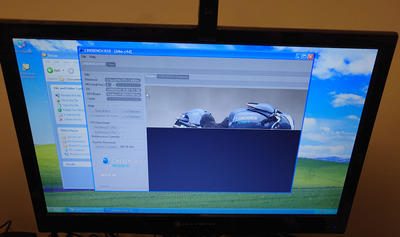

I've started thinking about the OS a bit, too. At first I was thinking XP, because it's about the right period and the hardware is a good fit for it. But then I started thinking, well, this is turning into a cursed build, really janky and weird and different, and that just seems too much like the safe option. There was an exciting new operating system that came out in 2007 that a brave soul might try running on their bodged-together "workstation"...

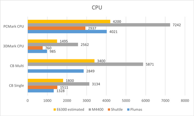

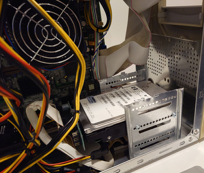

Reply 6 of 10, by XCVG
It hasn't been two months yet, but it's still long overdue for an update.
Modifying the drive cage was pretty quick and easy. I cut it down, bolted the pieces into the case through the existing holes, shoved a drive in and called it a day. That was done weeks ago.
345.79 KiB
1052 views
Then I tried and failed to get the machine to actually work with that drive.
The Apple-branded carrier-loading DVD-RAM drive (chosen specifically for its weirdness) refused to boot my Windows Vista DVD. In fact, it refused to boot pretty much anything. I gave up on the Apple-branded carrier-loading DVD-RAM drive and Windows Vista and threw in a boring but known good CD burner and Windows XP disc, at that point giving up on doing anything fancy and just hoping something would work. After several reboots, I was able to get the installer to boot and went through the first steps. No matter what I did, though, I couldn't get to the next step where it's supposed to boot from the drive.
After spinning my wheels poking at the BIOS and jumpers I realized I don't actually know if this motherboard can boot from a SCSI drive. I kind of assumed it could, but there doesn't seem to be any option ROM which I'd expect to see. I gave up on the onboard SCSI and ordered an Adaptec RAID card.
346.11 KiB
1052 views
Weeks later, said card arrived, I shoved it in awkwardly (the SCSI cable doesn't really fit in the space between the slots but I couldn't be bothered to rearrange the cards) and it completely failed to do nothing. Some cursing later, I realized the card wasn't in all the way, and after a bit of shoving it was in and I was booting into the Adaptec utility. It sat there spinning for ages as the drive made ominous chirping noises.
At some point, the first hard drive died completely. I don't know if it was already on the verge of failing or if it really didn't like running with no cooling and/or only three screws into a shaky mount. Fortunately, I have a stack of them, and all but one of the others seemed to work. Although I went out of my way to pick up a RAID card, I've pretty much given up on the idea of RAID at this point. I feel putting two 15K SCSI drives in is tempting fate and they might just cook each other or shake each other to pieces. I'm not sure if there's enough clearance for two drives with SCA adapters anyway.
I did find a 160GB IDE drive which I think would fit well as a storage drive. I haven't installed it yet, because I'm still working out cooling for the drives (very necessary for 15K SCSI drives I think) and I might have to remove the cage for that. I haven't installed an operating system either yet, because I don't want to tempt fate with the uncooled SCSI drive.
I'm probably going to take the lazy way out and just mount a pair of slim 80mm fans on the provided mounting holes. I've thought about trying to hack out the metal and cram in a 120mm fan or hack out the bezel and jam a thick 80mm or 92mm fan in the front, but I'm not really feeling it. I also had plans to integrate a USB hub connected to the USB card to provide USB 2.0 to the front panel, but I'm not really feeling that either. To be honest, I think almost all my initial excitement for this project has faded at this point, largely (but not entirely) because of the technical issues I keep running into. One month later, three months after starting the project, and I'm closer to having a working system but still not quite there.

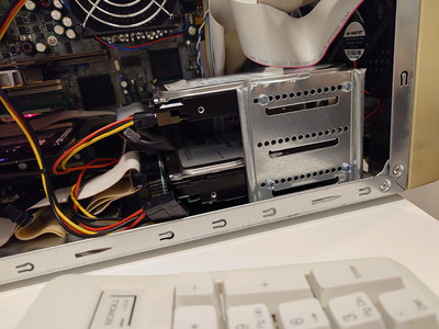

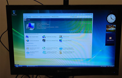

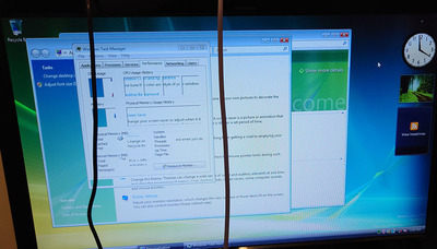

Reply 7 of 10, by XCVG
It's been over a month, and it's time for another update. Have things gone well? It's more like things have, well, gone.
I decided to go with the laziest possible solution for the front fans and ordered a pair of 80mm slim fans. It was something like $10 on Amazon for both.
174.27 KiB
792 views
They don't really cool the drives. Maybe the top one, a little bit. I'm sure it will be fine.
I tried to install Vista from DVD shortly after the previous post, but it failed early in the process. I suspect it was a bad burn, but it took me a while to get around to trying again. This time I put it on a USB drive and used Plopboot to boot from the drive.

Hey, now we're getting somewhere! This looks like a perfectly cromulent Vista install.
Unfortunately, it's completely unusable.
The installer ran fine, but problems started to crop up in OOBE (first boot) before we even got to the desktop. It was really, really, painfully slow, with UI that took seconds to respond. Setting up the first user and date/time was excruciating. Then it got stuck on "please wait while we check your computer's performance" even after I let it sit for half an hour. I think it was technically running, just running super slowly. I looked up a sketchy YouTube video on how to skip OOBE in Vista and slogged my way through a horrifically unresponsive regedit.
Things did not get better at the desktop.
Not only do we get some interesting graphics artifacts...
159.69 KiB
792 views
...it also runs slower than maple syrup in a Montreal winter. We're talking several seconds for a screen redraw. Open the start menu, move a window, close something, doesn't matter.
I tried installing the graphics driver. It made things even worse. At least we got to see some advertisements for circa-2010 games in the installer while we waited.

Vista didn't work, but I was able to get XP installed and run some benchmarks!
173.64 KiB
660 views
Well, sort of.
I may have cheated a little bit.
I tried installing XP right after the failures with Vista. The first part of the install went fine, but it bluescreened after rebooting into the second step of the installer. I tried a different disc and got the exact same thing. I have no idea what the problem was, if it's an issue with the RAID controller or something else in the hardware. As I mentioned in the last post, my attitude toward this project has definitely shifted towards just getting some benchmarks so I can answer the originally posed questions.
So I took the nuclear option, ripped out all the cards except the graphics card and USB card, and installed XP to the IDE hard drive. It's a much less interesting machine now, but it did work. There's no sound or ethernet (I forgot to put the jumper back in to enable the onboard) but I don't need those to run benchmarks.
I don't have a lot of other machines anymore, but I do have two that should make decent points of comparison. I have a Shuttle mini-PC with a late Athlon XP and a Dell laptop with a Core 2 Duo and dedicated graphics. I pulled both of those out and ran the same benchmarks on all three machines.
I don't want to spoil the conclusion too much, but I've had a hunch for a while that this wouldn't really be worth it, even against period machines, and at a glance I think I was right. I do still need to go over the data, try to remember what the landscape was like in 2006, and try to answer the questions of whether this was a good idea back then and whether building a machine like this is a good idea today.

I ran a few synthetics: Cinebench R10, 3Dmark06, and PCMark05. Unfortunately, the PCMark05 System benchmark didn’t complete but the sub-scores are interesting and we’ll take a look at those in a moment.
I ran the same benchmarks against two systems for comparison. One is a Shuttle SN45G with an Athlon XP 3000+ and ATI Radeon 9600 Pro. The other is a Dell Precision M4400 laptop with a Core 2 Duo T9600 and Quadro FX 770M (similar to a 9600M GT or desktop 9500 GT). I wish I had a later P4 system and an early Core 2 (Conroe) machine, but I don’t anymore. I did guesstimate some CPU scores for an early Conroe system based on the M4400 benchmarks and the difference between a T9600 and an E6300.
41.28 KiB
465 views
With two CPUs and hyper-threading, performance scaling in Cinebench from single-thread to multi-thread is impressive. In single-thread Cinebench, it’s at the bottom of the chart. It does beat the Athlon XP by a good margin in PCMark and a small margin in 3DMark. Theoretically, though, even the E6300 should handily beat it, and the T9600 with higher clocks and more cache obliterates it.
This confirms what I already suspected. The real surprise was how close the Athlon XP got in the mixed benchmarks. Maybe it shouldn’t have been, though; back then single-thread was king and probably weighted heavier in tests, and the Xeon is basically a 2.4GHz Northwood P4 on a 400MHz bus, which the Athlon XP handily beat.
33.66 KiB
465 views
To be honest, this data isn’t very useful. I suspect the PCI bus is really hurting this system in the Cinebench OpenGL test since it loses that one but beats the Shuttle with its 9600 in 3DMark,but there are too many variables to safely draw that conclusion. I will say, though, wow, that mobile Quadro is fast. I knew it would beat the older cards, but I’m pretty surprised at how wide that margin is.
I don’t have an AGP or PCIe version of the same card to do a direct comparison, but Techspot reviewed the card back in 2006 and compared its performance with a PCIe version of the X1300 Pro. You can find the review here, but in short, the PCI version gets about half the performance. Ouch.
I would like to highlight two of the PCMark sub-scores that illustrate that PCI bottleneck. In 2D Transparent Windows, this system scored 93.283 windows/s. The Shuttle was four times faster at 396.210 windows/s. In 2D Graphics Memory, 64 lines, it scored 138.453 FPS, which sounds fine, until you look at the Shuttle’s result of 692.165 FPS.
