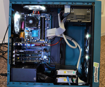

A little while back I wanted to build a "ultimate Piii system" and this site was a huge help in finding compatibility for building a Win98SE/XP SP3. So a huge thank you for keeping a place to store all the old info. The biggest help was in discovering Tualatin Piii's. Lots of diving on that to figure out which MB can run the thing and finding one on eBay that wasn't awfully priced from China. Finding a GA-60XET would have been nice but they are $$$ from China. Overclocking the Tualatin would have been nice to see. I heard they can get into the 2Ghz range and compete with P4's

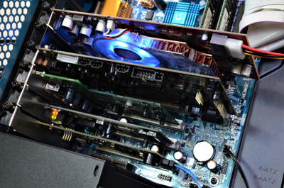

I finished the build today by replacing the graphics card fan and cleaning it up. Looks almost brand new for a 2001 PC. Attached are some slick Nikon DSLR pics of the build.
Specs would be:
Tualatin Pentium 3 1.4Ghz SL6BY
512MB RAM Samsung 133Mhz (2x 256)
Gigabyte GA-60XT
EVGA 600 Watt PSU
Asus DVD Combo Drive (Startech SATA to ide adaptor)
Sony 3.5in Floppy
Samsung 860 EVO SSD (comes in handy when you run out of RAM)
[Add on cards in order]
ATI Radeon X800 Pro 25gMB DDR3 (AGP)
Sound Blaster Audigy 2 ZS
NEC 4 Port USB 2.0
Linksys LNE 10/100
HighPoint RocketRAID 1720 SATA Host
Fractal Design Focus G Petrol Blue Case
Unused are 2x Maxtor 40GB hdd. One HDD has a bad section on it about 3.5gb are dead and the other one works perfectly with Win98SE on it. Model: 94098U8
A quirk I found is possibly the AGP cards with the PCIe to AGP bridge chip do not work in this MB. I bought a ATI X1950 PRO and it would not run on this MB. I think the X800 is the best card (ATI) that can be used since it has no bridge chip.
The X800 Pro also works on Win98SE fwiw.
