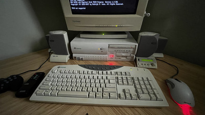

I've had this build in mind for a long time, but finally started building it in March of this year. I didn't have too many issues finding all of the parts I wanted, and managed to complete the build earlier this week. Everything is complete except I am working on getting the PCI SB Live 5.1 SB0100 sound card working for DOS games.
I gave everything a good cleaning, checked all of the caps, replaced the power and HDD activity LED's, & added brand new case badges. I didn't have enough room for all of the drives I wanted, so I made a slight modification to the case for the Gotek Floppy Emulator. I cut out a couple of spots into the front panel of the case for the Gotek LCD and buttons, & a slot on the side for the USB port. I think the LCD on the front gives it sort of a turbo LCD look. I'm really happy with the final result. The only thing I'd like to change is eventually replace the monitor with a nice Sony Trinitron monitor, but I'm happy with the Viewsonic with the USB hub for now.

Agreed, that's a nice Gotek mount!
Reply 3 of 7, by TuesdaysGone
Now that's a sweet looking Gotek display! Congrats!

Thanks! I appreciate it! Everything turned out better than I hoped for.
