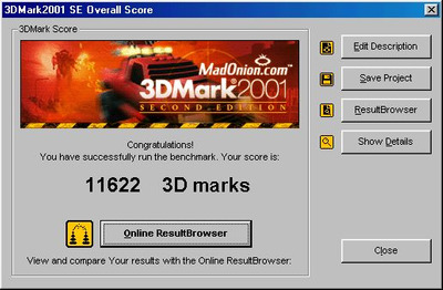

  • 3dMark99
    30.56 KiB
    3257 views
  • 3dMark00
    36.45 KiB
    3257 views
  • 3dMark01
    39.13 KiB
    3257 views

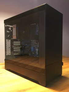

Reply 1 of 18, by mln

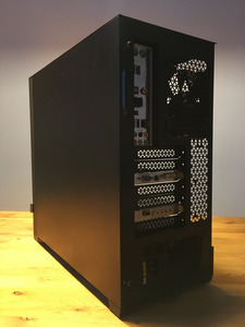

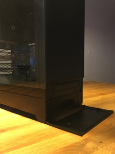

Exterior Photos
1.26 MiB
3255 views
1.21 MiB
3255 views
1.22 MiB
3255 views

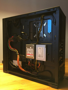

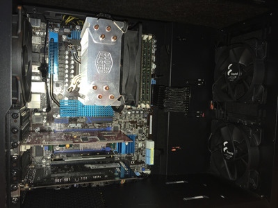

Reply 2 of 18, by mln

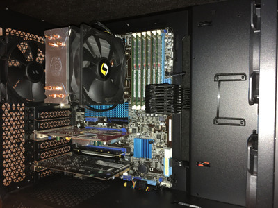

Interior Photos
1.93 MiB
3254 views
1.37 MiB
3254 views
1.39 MiB
3254 views

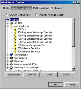

Unresolved issues
  • Unknown Devices in Device Manager
    41 KiB
    3252 views
    PCI Programmable Interrupt Controller entries are what bothers me. I don't know if they are needed though, since all I need works fine.

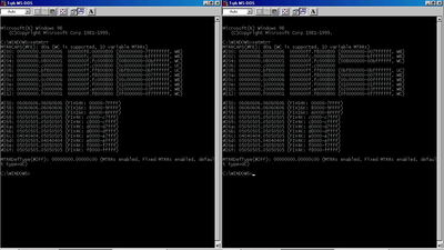

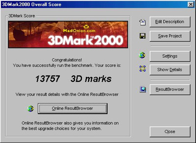

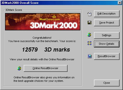

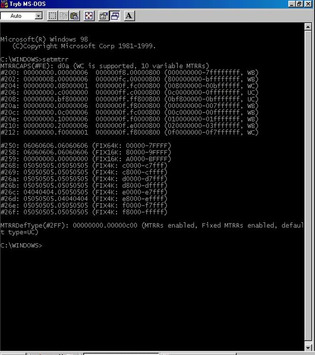

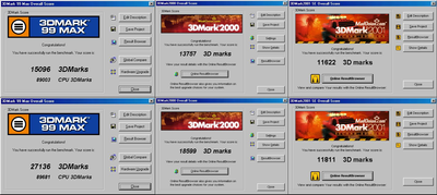

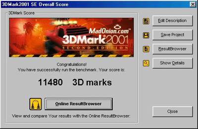

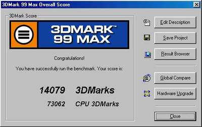

  • 3DMark results
    They are disappointing compared to my previous build (E8600@3.33GHz + X550 - the same card I am using right now):
    E8600@3.33GHz + X550 + 8GB VSync off vs. x5675@3.07GHz + X550 + 48GB VSync off:
    - 3DMark99: 22882 / CPU: 88380 vs. 14079 / CPU: 73062
    - 3DMark00: 18149 vs. 12579
    - 3DMark01: 11797 vs. 11480
    3dMarks identify E8600 as "Pentium III", while X5675 is just an Intel CPU. Maybe that's what confuses these benchmarks.
    Adjusting MTRRs fixed the issue. More details in comment.

Reply 5 of 18, by Joseph_Joestar
mln wrote on 2023-11-08, 16:14:
Try the unofficial ICH9/10 drivers from here. I'm not sure if they support X58, but they worked great for my P35 chipset.

Reply 7 of 18, by mln
Joseph_Joestar wrote on 2023-11-08, 16:49:
I used them with my previous P35 build and they worked too. I tried them again with this build but Device Manager didn't want to use them.
Anyway, those "drivers" are just an .inf file, so I guess their only purpose is to hide Unknown Devices from Device Manager. I will take a look at them later and try to add X58/ICH10.

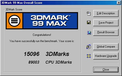

Reply 8 of 18, by mln

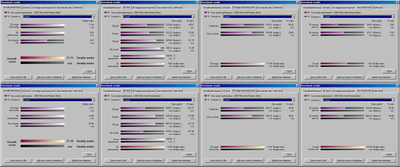

After disabling HT in BIOS, 3DMarks look better, but still behind E8600 + X550:
  • 3dMark99 (vs. 14079, CPU: 73062 with HT enabled)
    30.74 KiB
    3045 views
  • 3dMark00 (vs. 12579 with HT enabled)
    36.71 KiB
    3045 views
  • 3dMark01 (vs. 11480 with HT enabled)
    39.12 KiB
    3045 views

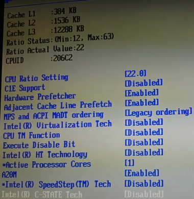

Reply 9 of 18, by agent_x007
1) Disable all but one core in BIOS (along with HT)
2) AIDA64 bandwidth benchmarks scales with core count.
3) Recently ran 48GB of RAM on Core i7 975 on Rampage III Extreme, here's valid : https://valid.x86.fr/vdev1v
Performance is quite good.
4) Never bother with "unknown device" things on X58 under Win98. I would try doing ACPI install again though (just to check performance from it).
5) CPU Configuration I used (don't look at CPU multiplier, I'm on OC'ed 980X) :
1.41 MiB
2979 views

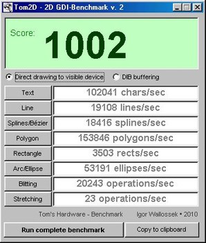

Thank you for the tips. So far disabling HT gave the biggest boost.
I've just tried Tom2D benchmark:
32.6 KiB
2919 views
All tests are more or less okay, but the last one (Stretching) is awfully low, thus probably it makes overall score low as well.

Finally I got optimal GPU performance under Windows 98 with more than 2GB of RAM installed.
Tl;dr MTRRs need to be adjusted for more than one range.
During my research I found that GPU performance issues with more than 2GB of system RAM are not limited to Windows 98, they affect other OSes as well. For example:
https://bugzilla.kernel.org/show_bug.cgi?id=13042
https://bugs.launchpad.net/ubuntu/+source/lin … .24/+bug/224404
It looks like some BIOS issue rather than OS, since it's BIOS job to correctly set MTRRs.
I blindly tried to fix MTRRs using MTRRLFBE with default arguments, but the issue was still here, so I kept digging.
Next, I tried to understand how MTRRs work. I found that some memory areas need to be marked as WC (Write-Combine) and they should not be overshadowed by other MTRRs, since less caching has more priority.
To see how MTRRs look in my case I used SetMtrr:
87.72 KiB
1890 views
There are two memory areas marked as WC:
  • 0x8000000-0xBFFFFFF (64 MB area, 3rd MTRR)
  • 0xF0000000-0xF7FFFFFF (128 MB area, 10th MTRR)
Both areas are overshadowed by 1st MTRR, which is WB. This makes 3rd and 10th MTRRs not effective.
I tried to use MTRRLFBE again, this time forcing specific memory areas as WC. I created MTRRLFBE.BAT file like following and added it to Autostart:
C:\WINDOWS\MTRRLFBE.EXE VGA WC
C:\WINDOWS\MTRRLFBE.EXE USER:0x8000000:65536 WC
C:\WINDOWS\MTRRLFBE.EXE USER:0xF0000000:131072 WC
It did the trick! I briefly checked some benchmarks and observed better results.
This is how MTRRs look like before and after the fix:
198.23 KiB
1890 views
1st MTRR was resized to cover first 64MB and became redundant, since 6th MTRR covers the same area.
MTRRs 6th-9th cover first 1GB and WC MTRRs are not overshadowed anymore. I limit Win98 RAM to 512MB, so I hope this will not cause any issues.
Below are some benchmark results, before and after:
673.75 KiB
1890 views
579.85 KiB
1890 views
3DMark99 score is almost 2x better. Bandwidth tests in Future Reality also got a huge boost.
I am very satisfied with the results 😀.
