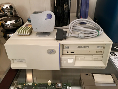

The main board has the following specs: (Disregard the CPU specs given, as I got these specs off another site)
The attachment IMG_8133.PNG is no longer available
The machine features integrated graphics with 1MB of video ram, and only has 2x 16-bit ISA and 1x 32-bit VESA expansion slots available.
So the question is: Do I disable the onboard graphics and slot a DIAMOND STEALTH 64 DRAM VLB and slot one of these ISA SCSI cards (Perceptive Solutions Easycache SCSI B1 1200 ISA Card):
The attachment Screenshot 2024-02-05 at 19.28.42.png is no longer available
Or do I slot one of these: (Adaptec AHA-2842A VL SCSI Master VLB SCSI Floppy Controller)
The attachment s-l1600-278.jpg is no longer available
And use the onboard graphics (I can maybe look at swapping out the 1MB chip for a 2MB, which would require solder work, as the chip isn't socketed.)
In your opinion which setup would offer better all round performance as far as drive and video performance go? (This machine will remain a 486 DX4 100, even though the board can accept a Pentium Overdrive chip)
The system currently doesn't have any external cache chips fitted, so I'll have to fit some!

Reply 2 of 35, by progman.exe
[I can't figure out quoting a picture, so I'm making a mess 😀
quote=Irinikus post_id=1232089 time=1707153516 user_id=49693]
What's the thing above the IBM badge, with the purple sliding door? It is an ancient webcam? Does that big SCSI lead go to it?
I hope you are gonna get that thing working with a modern machine, so you can have by far the worst picture on corporate camera crapware.

Reply 4 of 35, by Irinikus
progman.exe wrote on 2024-02-05, 19:50:
[I can't figure out quoting a picture, so I'm making a mess :) quote=Irinikus post_id=1232089 time=1707153516 user_id=49693] htt […]
That's an SGI O2 CAM. (It's for the SGI O2 sitting next to this system.)
