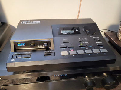

Roland MT-100 button combos that are somewhat useful:
Stop + BEAT/MEAS = Set THRU On/Off w/turn dial, then Execute. (Play MIDI IN, hooray!) You can use FWD/BWD to select other options as well. You can record this change to the saved settings(used during power-on) by holding the REC button while you press Execute.

"Stop + BEAT/MEAS = Set THRU On/Off w/turn dial, then Execute. (Play MIDI IN, hooray!) "
This worked great for me. All I had to do was set THRU ON from OFF, and now my mt-100 works great. Got it for 50 bucks "broken" because it "would not respond to midi"
Celebration time!

Did you ever figure out to get this default to ON?
Got my second one today also claimed to be broken of the same reason, Setting THRU to ON fixed the problemen but after powering off the unit the THRU option is OFF again.
On my first unit this is the oposite, it is default ON. Even after setting it to OFF an power cycle the unit.
Both units are V4.00 so i'm a bit confused about this 🙁
[Edit] Found the answer on page 49 of the owner manual, Stop+Beat -> Set Thru to ON with Dial -> Hold REC and then Execute. Now its saved even after reset 😀 Hope this will help someone with the same problem.
