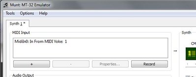

The "+" button or "New MIDI Port" menu, both are grayed out
Reply 14 of 33, by sergm
That's OK if there is no MIDI input ports installed in the system. Also it might be the case if you had 32-bit driver and run 64-bit app but I haven't published that yet 😀
You need a virtual MIDI cable soft. I mentioned MIDI Yoke for historical reasons, loopMIDI by Tobias Erichsen performs much better, and on 64-bit system as well.
Reply 15 of 33, by sergm
Eventually, you should end up with a config similar to the screen. Then you set the emu to output to the OUT MIDI Yoke port with the same number.
