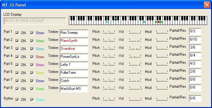

Per vlader's suggestion, I now have the keyboard color-coded. I have added in a "currently playing" partial count, as well as volume, pitch and modulation sliders.

Beeeeeeeootiful! 😜
Small additional suggestion: if several channels hit the same key, you may want to draw multiple bullets and space/arrange them out vertically (possibly with some overlap to save realestate) accordingly. Mere esthetics, but thought I'd write it down.

I might vertically stretch the keyboard to accomodate that ... However, You can turn off/on the display of certain parts, so you can single things out if there is overlap..
Some things I've noticed, watching the pitch sliders:
You can tell in firehawk that they were using the actual pitch wheel on a keyboard. When they let go, you can see the momentum and damping caused by the spring.
I'm thinking about posting the code, soon, as well as the places (mostly in the playmsg routine) where you need to hook in. The only drawback is that I am using MFC for the dialog box, and it would be specific to the Windows platform, unless there's an easy way out there to make MFC-based code platform independant.
