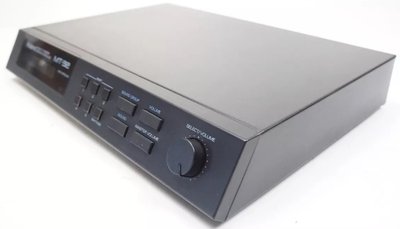

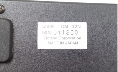

I am considering purchasing a Roland MT-32 currently for sale online; it has serial number 911800 (see attached pictures), meaning it is "old-type" revision 1. Would it be better to wait and look for "old-type" revision 0, or do games sound exactly the same with both types of "old" Roland MT-32 units?

    Roland MT-32 sound module with serial number 911800

    Roland MT-32 serial number 911800
Reply 1 of 30, by 7retro2000
You are better with an MT-32 instead of none. Just get one and play with it.
People recommend the old one as a standard. Just a personal opinion - when you deal with sound, there is no perfect choice.

Well, as for the subj, the answer really depends on the scope of the preferred games. If 100% compatibility with old Sierra titles is preferred, this unit is likely the one you need. Although beware, the serial ID does not guarantee the compatibility. In case the unit occasionally got to the service, the main PCB could be theoretically replaced with the new one (and with phone jack removed as explained in the service notes). So, only seeing the PCB (or playing those hacky patches) can actually confirm whether it is the old-gen unit.
As for the PCB-0 vs. PCB-1, I am not aware of any differences (from the consumer PoV) between the two. AFAICT, the LA32 chip design remained intact, only the package was changed. Besides this change, all ROMs were also replaced at the SN #851400 boundary but the contents kept the same.

Reply 19 of 30, by NewRisingSun
OP is asking about two versions of "old-type" MT-32 (ASSY 7937731000 vs. ASSY 793741000), not about "old-type" vs. "new-type" (ASSY 7937731001) MT-32.
All that the later "old-type" MT-32 changes is to consolidate the circuit board design by changing the package type of the LA32 chip and by replacing EPROMs with mask ROMs. Control and sample ROM content are identical by all accounts. See the MT-32 Service Notes Second Edition.
Within the "old-type MT-32", there should be no reason to prefer one circuit board over the other sound-wise. The circuit board that mounts mask ROMs will be more durable in the long term however, since mask ROMs do not lose their content over time, unlike EPROMs.
