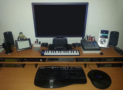

I own a physical Roland MT-32 (first release) and also use MUNT sometimes as I find it more convenient. Some say that you must have a physical unit of the MT-32 if you want to use the virtual solution of Munt with Roland's ROMs legally, so for the avoidance of doubt this is my setup:
