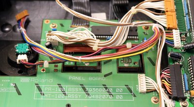

I got a Roland MT100 recently, which is close enough to an MT-32 that I think it's okay to post it here. Sadly, the dial that controls most of the settings was not working correctly and would only make values go down when it was scrolled in either direction.

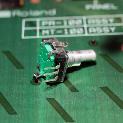

This is the replacement part: https://uk.rs-online.com/web/p/mechanical-rot … coders/7816824/
Not too pricey 😀 The datasheet shows it has Channel A, Channel B and the center pin is the common pin, which afaik it puts a low voltage into.

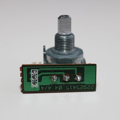

The MT-100's wheel is a little different though, it has a board that it fits to, which has a push on connector:
616.68 KiB

437.29 KiB

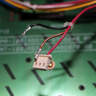

The original connectors layout, on both the plug and where the cable connects to on the mainboard, when interpreted using the details from the replacement Bourns rotary encoder:
Pin 1 - Black Wire - Channel B
Pin 2 - Brown Wire - Channel A
Pin 3 - Red Wire - Common

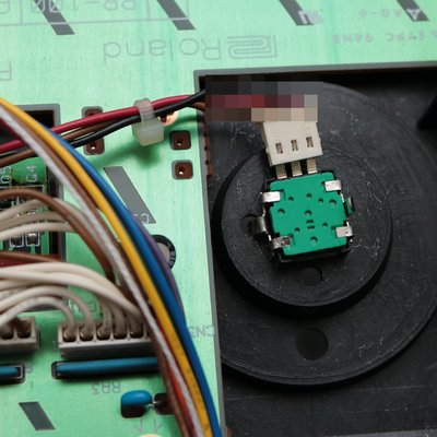

Remove the pins of the connector using a very small screwdriver / pin pushing down onto the exposes clip parts of the connector to remove the pin from the plug:
542.73 KiB
474 views
The pin sizes of the Roland dial connector match up quite well with the replacement's legs, which can be carefully fitted into the cable. Notice that one of the retention legs on the new rotary encoder is bent around so that's facing up along with the stalk - that's to fit into one of the mounting holes in the MT-100's casing, which stops the rotary encoder from possibly rotating once it's screwed into place:

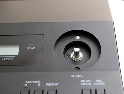

Reply 1 of 1, by Thermalwrong
The new dial fits into the case more loosely than the original, but that can be re-adjusted once it's all back together (the wires are blurred here because I initially had it wired wrong 😊 ):
386.76 KiB
473 views

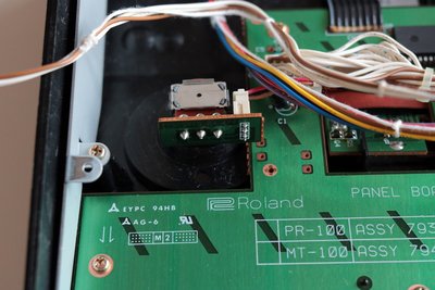

How it looks from the top, note that the mounting peg that was bent upwards should fit into the hole in the plastic casing:
362.47 KiB
473 views
When it's all connected up correctly it should look like this:
670.9 KiB
473 views
Imgur gallery with some extra pictures of the disassembly: https://imgur.com/a/T1Z09ER
