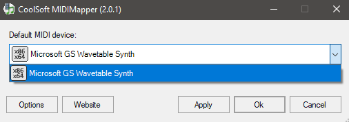

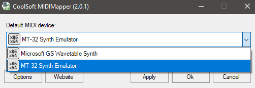

Well, I have some good news. I did a complete reset on my computer, and Munt started working again for the most part.
Unfortunately, the software that I use to select Munt as my MIDI device, CoolSoft MIDIMapper, will no longer have Munt as a selectable option in the drop down menu after I restart my computer.. I've found that uninstalling Munt and reinstalling it again will let me select it again, otherwise the only option is Microsoft GS Wavetable Synth.

    This is after I've uninstalled and reinstalled Munt, it's an option that I can select again.

    This is after I've restarted my PC, Munt is not an option I can select.

The problem is not in CoolSoft. It looks like you're experiencing the Win10 issue discussed in those topics:
Munt issue with Windows 10
Windows 10 stops detecting Munt.
Install the latest Munt 2.4.0 version before trying anything else.

I installed 2.4.0, (I wasn't aware of the new version) and I'm not experiencing any issues! Thanks so much!
