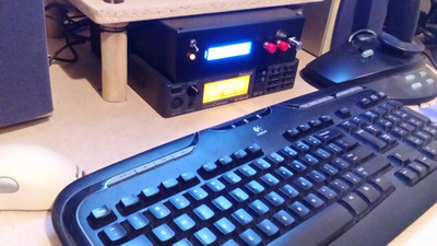

Forgive me if this thread already exists somewhere, but I can't see it. After completing a modest version of such a build last weekend, I thought there must be many of us doing this sort of thing, and it would be nice to see them gathered in one place.
Obligatory crappy photo:
The attachment MT32PI_AMPCASE.JPG is no longer available
I wanted to do it cost-effectively, by re-using things I already had. Therefore I limited my purchases to an RPi 3A+, and a $3-including-shipping 5102 DAC from Aliexpress. A total outlay of <US$50.
The recycled Case : A shithouse ($10-20) Aliexpress amplifier I got for testing some time ago - it's case, while nothing special, is the most worthwhile piece of the whole deal, the electronics being rubbish. Semi-gutted it, by depopulating all it's boards components.
But I left the bare board in place, so I could re-use it's external fittings such as switch, power input socket, and 3.5mm audio socket - saves me needing to rebuild my own. I drilled the old board out at a handful of strategic places to ensure signals from those re-used ports couldn't wander through the old board. Then layered a thin piece of wood over top, onto which the RPi was secured.
Power was wired from the case's DC input socket, directly to the back of the RPi board - the PP2 (+) and PP5 (-) solder points - via the case's switch. This way, I can use any-old of the many 5V 2.5A DC power bricks I have lying around from my Pile-of-ADSL-routers years, rather than having to spend more hard-earned on a special Pi-USB3 power brick. The Pi's audio out is similarly wired to the case's 3.5mm socket.
A USB extension cable neatly coming out the back of the case provides a port for my existing MIDI-USB cable, which shares my DOS PC's MPU with my real SC-55 by way of a Serdaco DB15 splitter.
I have not bothered with extra switches or even screen functionality, as those are not important to me - I simply wanted a tidy, convenient physical box that I can easily switch on when I need MT-32 sound.
Job done. Nothing special or fancy in any way, but I'm really pleased. And very thankful to Dale Whinham, the author of mt32-pi, and indeed to the makers of the excellent RPi itself, and to Roland for making such a great device in the first place, and to the skilled composers of the MT32 soundtracks we all love, and which I finally (after 30 years) get to fully experience in a fun, convenient way.

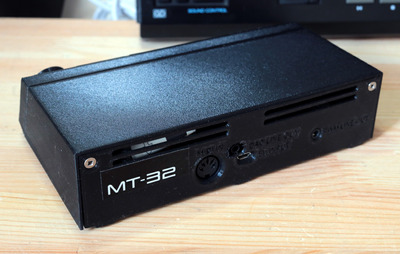

That's a nice clean design, I do recommend that you consider adding buttons though. Otherwise you can't switch from MT-32 to soundfont mode, unless maybe you use MT32-pi-control software.

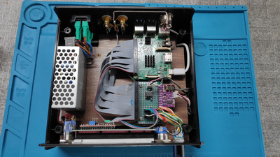

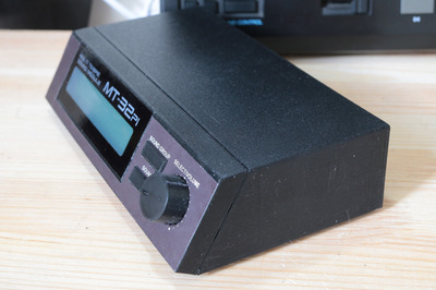

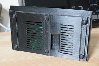

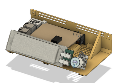

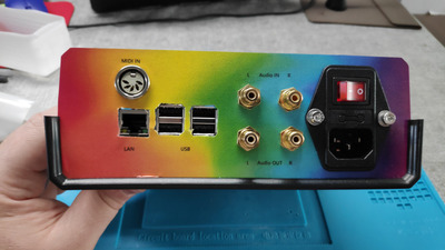

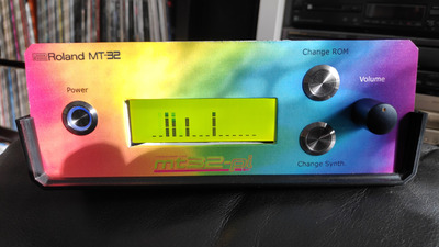

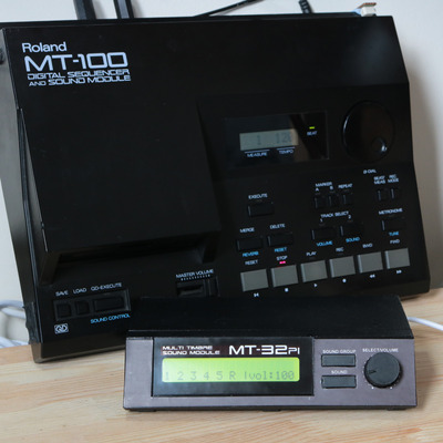

Here's what I've been working on for a few weeks now - my MT32-pi case which is designed to look like a shrunken regular MT32, but with the bigger 20x2 LCD.
The attachment IMG_0285.jpg is no longer available
IT's been designed in Fusion 360, but the DAC and MIDI input PCB are currently just on some PCB stripboard that I knocked together. Digitising the physical objects is time consuming work, especially when a print of the top and bottom parts takes 6 hours each. The DAC's audio jack doesn't fit right for instance, but it's close enough to work.
The attachment IMG_0293-2.jpg is no longer available
The attachment 2021-04-02 18_23_43-Window.png is no longer available
The Pi3 is screwed in there to be an MT-32PI forever, but on the underside I can get to the micro SD card to swap it out, and the MicroSD card can't fall into the case (very annoying when that happens).
The attachment IMG_0299-2.jpg is no longer available
The front wouldn't look right with the 3d printing layer lines, and my attempts to print text with the 3d printer didn't work out, so I used my Brother QL700 label printer to print out the matte paper label, and the glossy plastic label. The end result looks pretty fantastic to me, but I'd love it if there was a better way to print the matte front part. I Was thinking maybe a PCB with no traces on it, in a black matte finish. That would be cheap-ish and the silkscreen would work perfectly for the button labels.
Something I'd like to look at next is making a PCB that doesn't sit on top of the CPU so it can cool better, there's room in the case for that. But this one works and I can use it now grinning face

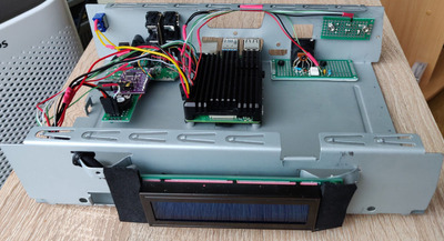

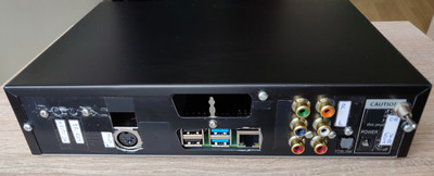

Excellent thread. Dale deserves more publicity for his outstanding work on github.com/dwhinham/mt32-pi
I have to admit it is little embarrassing to post mine after Thermalwrong professional work above, but here we go...
I consider this work in progress. Needs a paint job and proper labeling.
I had old unused TV set-box laying around. Entire implementation is based on goal to reuse it. Not only box itself but also part of unit old motherboard mainly for convenient barrel jack for power and RCA ones for audio access. I left all controls for back side because I wanted to keep front side stealth clean look.
I'm using it in tandem via Yamaha MU50 midi pass through connection.
The attachment set.jpg is no longer available
Guts
The attachment inside.jpg is no longer available
Back
The attachment back1.jpg is no longer available
Proof of concept of LCD bleed light utilization.
The attachment logo.jpg is no longer available
I'm still waiting for sd card extension cable to arrive so I can extend convenient SD card swapping capability to back.
If it turns out not to be stable solution I will probably cut out access bay for SD card access from bottom.

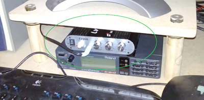

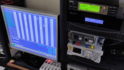

I've been meaning to post some pics of mine for a while. I have an old IBM Pentium 90 that ive been using for Dos gaming. I installed an ESS Audio drive sound card and built the clumsyMidi interface board with a break out screen and buttons. I modified the cover for the lower drive bay with the use of a dremel and then wired the Pi and all the connections internally. So now the MT32-Pi boots up with the computer and I can control the soundfonts from the front panel.

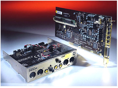

I couldn't be wrong, but I think some semi-professional soundcards stored MIDI daughterboards (WaveBlaster, DB50XG etc) in the bay.
The Terratec/Promedia EWS series was among of them, I believe.
Anyway, this is no critique. I simply mean to say that ratslif's approach is professional! smiling face with sunglasses

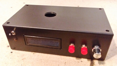

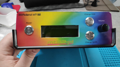

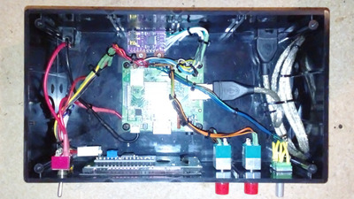

Late-April 2021 updates about my amateur builds:
The attachment build1.JPG is no longer available

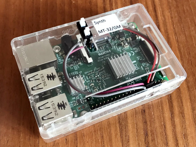

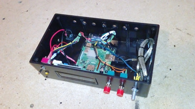

My initial build (shown above) - "retrofit the components into an existing redundant item's case" - succeeded by re-purposing junk to cheaply make a clean device which had the no-frills functionality to Just Be An MT-32. In that respect I'm happy with it, job done. However I couldn't help thinking of the missing functions it didn't have : the switches, the rotary encoder, the screen, and all the software capabilities hidden behind.
After looking over people's projects, it's obvious a 3D printer makes the physical build work vastly easier - it's hard to compete with Machined Perfection! However, I've personally found the-fact-I-don't-have-one to be an irritating barrier to entry in that respect. There's also a certain satisfaction involved in manual building the 'old-fashioned' way - hacking holes in prehistoric-era plastic boxes like a caveman!
So, just for fun (+ a grasping want to have the darned thing!) I thought I'd see how such a <$10 Plastic Jiffy Box onion-on-the-belt(tm) hand build went...
The components ) :
RPi3A+ & PCM5102A-DAC;
Plastic Jiffy Box of approx 20 x 10 x 6 cm;
Basic electronic components: LCD, switches, rotary encoder, etc - some of these are ones I already had at home.
Total Cost US$75 ballpark upon reflection this is vastly overstated, even $45 would be heaps (the confusion exists because I'm in the southern hemisphere where things are hard to get and expensive and shipping and stuff, and I'm mentally converting currencies)
The attachment build2_1.jpg is no longer available
The attachment build2_2.jpg is no longer available
The attachment build2_3.jpg is no longer available
The attachment build2_4.jpg is no longer available
After finishing the build and enjoying some MIDI playlists through Falcosoft MIDI Player on my Windows 98 machine, I thought: "wouldn't it be cool if I could have a MIDI playlist where (say) the Doom music plays via an SC-55-alike soundfont, and then the Shinobi soundtrack plays back via a retro soundfont, and then some other 80's game tunes play back via MT-32 mode... without having to touch the device!".

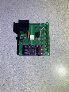

The attachment IMG_1190.JPG is no longer available
My getto MT32-PI hat. MIDI In and DAC output only, built cheap using components from rsonline, altronics, ebay and jaycar.
Because it is really easy to spend more money making a cool MT32-PI then it to just buy an original MT-32.
In fact, I have a RA-50 in the mail (basically a CM-32L with arranger hardware on it). Will need a minor hardware mod to make it act exactly like an MT-32.
Output is damn sexy with very good SNR.

Currently am making do with the following soundfont on the MT32-PI:
https://github.com/trevor0402/SC55Soundfont/releases
It still isn't the same as a SC-55, but it is a pretty decent sounding sound font.

Reply 15 of 94, by Hezus
Those are some really cool designs! Especially the mini 3d printed one. And having one in a 5,25 bay would be awesome too!
I'm really happy to own a real MT-32. Prices are going more insane with each passing year.

Reply 17 of 94, by appiah4
Mine is just a normal Pi3B in an acrylic enclosure with an M-Audio Uno USB interface connected to it.
It's not eyecandy but it works. I look forward to buying a decent prebuilt solution I can just plug my Pi3B into though.

Ok, thought I would humiliate myself so:
The attachment MT32-Pi.jpg is no longer available
Still trying to work out some issues I am having with my USB MIDI interface though. The dev is a very kind chap who has been very helpful. I believe he posts at Vogons no?
P.S. Yes the lower button should have been labeled MT-32/SF2 beaming face with smiling eyes
