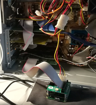

I'm going for a slightly different custom approach, driven by two main factors:
The only Raspberry Pi I could lay hands on easily when I started the project was the Model 3 A+ (right now I can't even get that 🙁).
I wanted the install to be fully internal, and configured in software via SYSEX (using Andreas Zdziarstek's excellent mt32-pi-control).

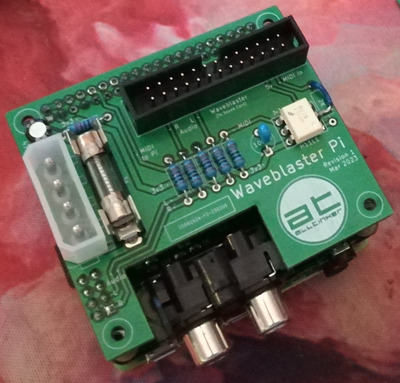

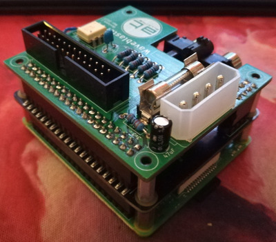

Here's my current work-in-progress PCB; a couple of oopsies to fix for the next revision, but it works great as-is (with a minor bodge 😜):
It sits on top of a Pi DAC+, powers the whole stack by standard molex 4-pin, and connects to the WaveBlaster header on the sound card (for MIDI out and audio return).
Here it is hooked up for testing:
I'm thinking of 3D printing a mount to have it sit somewhere securely inside the PC case (e.g. in a HDD bay).
